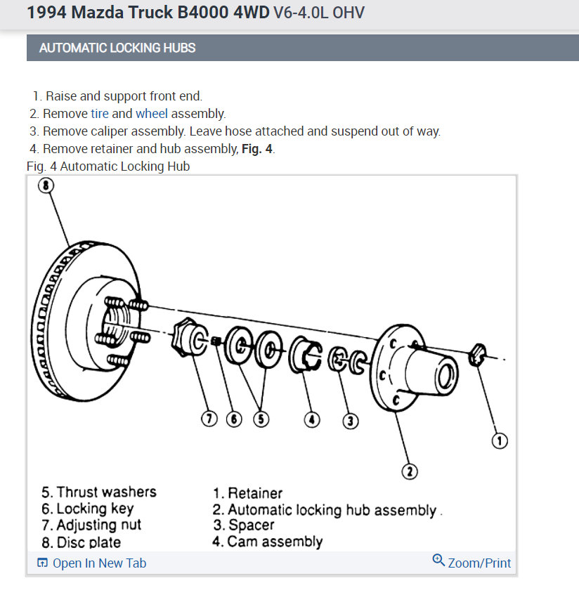

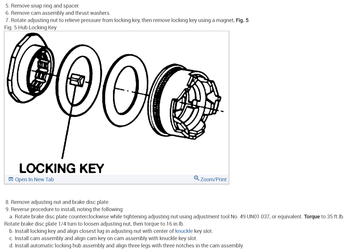

This happens when the front hubs go bad. To be sure can you please shoot a quick video with your phone so we can hear the noise? that would be great. You can upload it here with your response. Here is how you can change the front hubs out which is common. Check out the diagrams (below). Let us know what happens and please upload pictures or videos of the problem.
