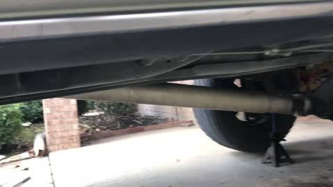

By seeing the transmission mount looks like it is going up and down a lot? I can push up and down on transmission easy.
Nov 6, 2018 at 8:06 AM
JONNYB1963
  • 263 POSTS
Yikes! Hard to really tell exactly where the noise is from the video but wow! I wish I could get under my Explorer that easy! So when you are under there, where exactly does that loud banging sound come from? The front, middle, or rear of the transmission? Are the U-joints okay as well? Also, can you give me some history of perhaps what happened before this? Were you out mudding or anything?

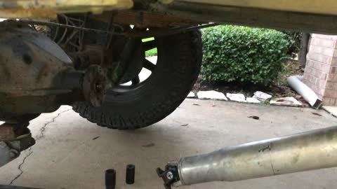

Update: know where the "clunk" is coming from. Changed the driveshaft, u-joints, plugs and coils. Still clunking not as bad though. So took driveshaft off and jacked in the air and here we have it, in the rear axle.
Nov 10, 2018 at 3:55 PM
JONNYB1963
  • 263 POSTS
Oh definitely! Seeing as this vehicle was under water as you said. Most likely water got into the differential housing. I would remove the cover and axle shafts then inspect the whole rear axle assembly from wheel to wheel. Replace all bearings and seals etc. For that matter though it might be cheaper to buy a used unit. Make sure the gear ratio is the same if you do.

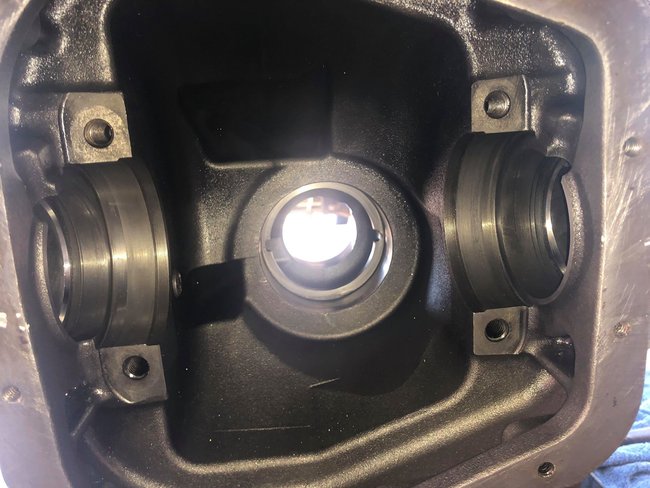

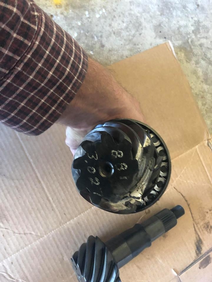

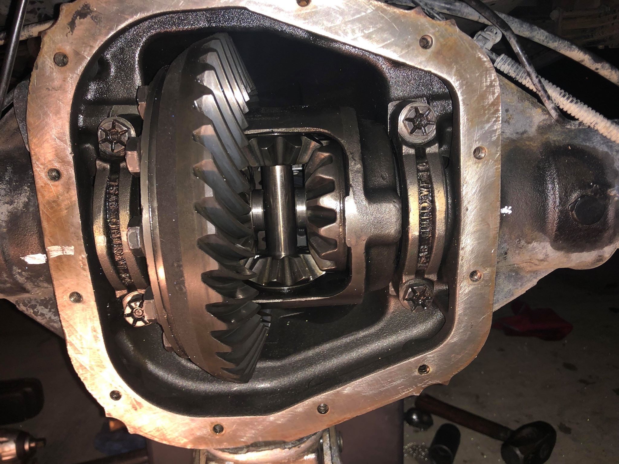

Huge final results: 456 gears ring and pinion was broke. Replaced the 456 with 410 drives like a dream. Did all the work myself. See pictures.
Nov 17, 2018 at 7:53 AM
Nice! Yep that is what it sounded like. Nice work doing the job yourself. Can I ask how much the gears cost?

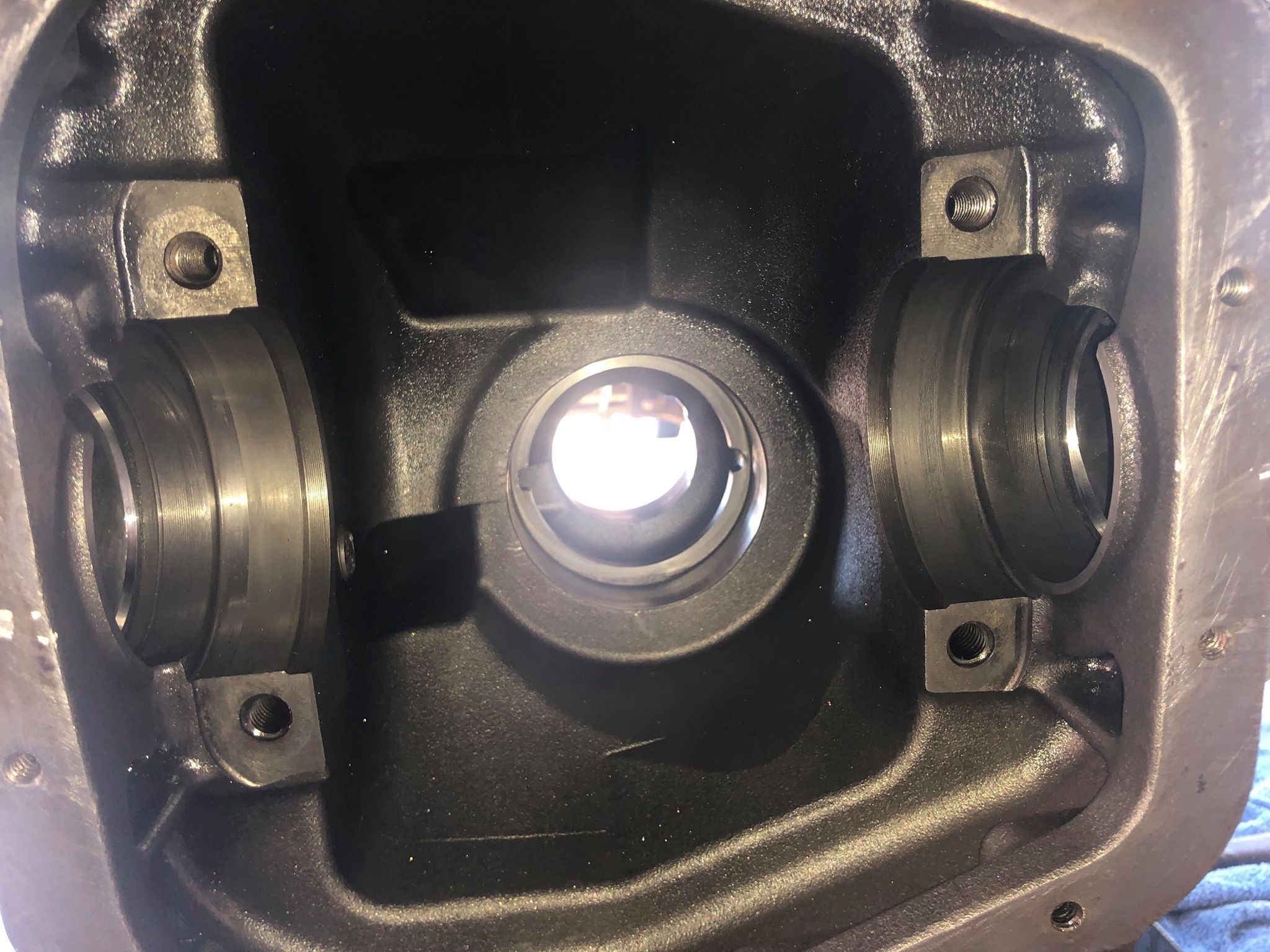

Well I plan on it with this Ford I am sure I will. Here is the last straw where I finally had to crack into the rear differential case! I had a time with the shims and that back lash, but I got it and it is running like new! Like the 4:10 gears a lot too.
