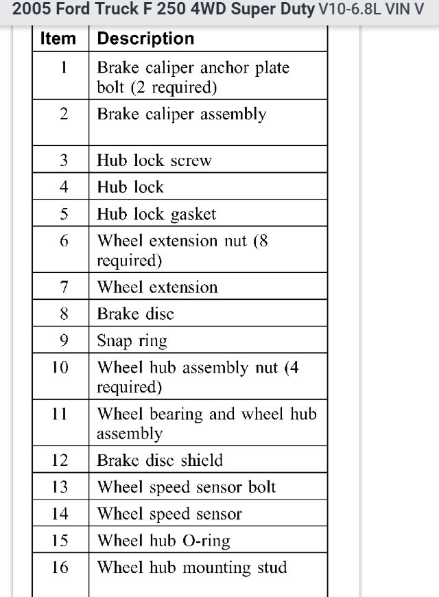

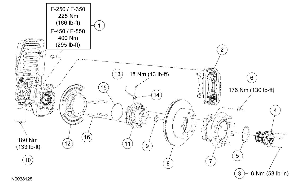

This is a common problem and it sounds like one of the wheel bearing hubs is not working right. I would replace the both if you find one to be bad. Here is a diagrams to help you see how the system works below.
