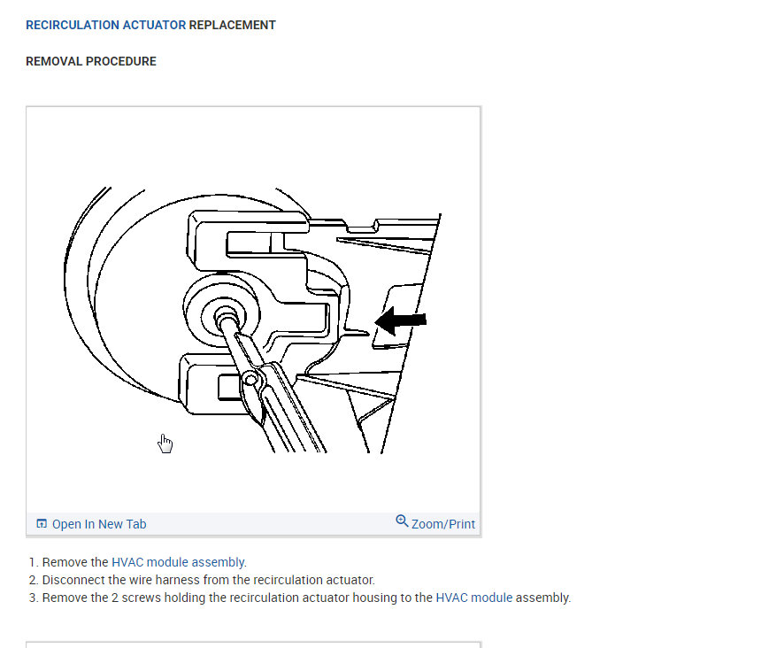

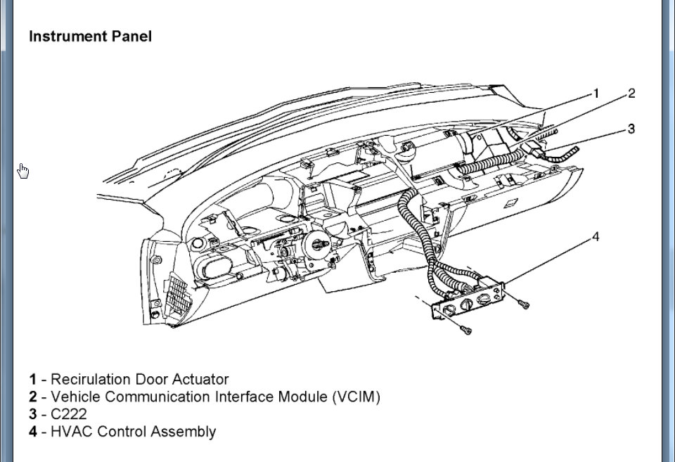

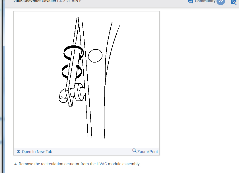

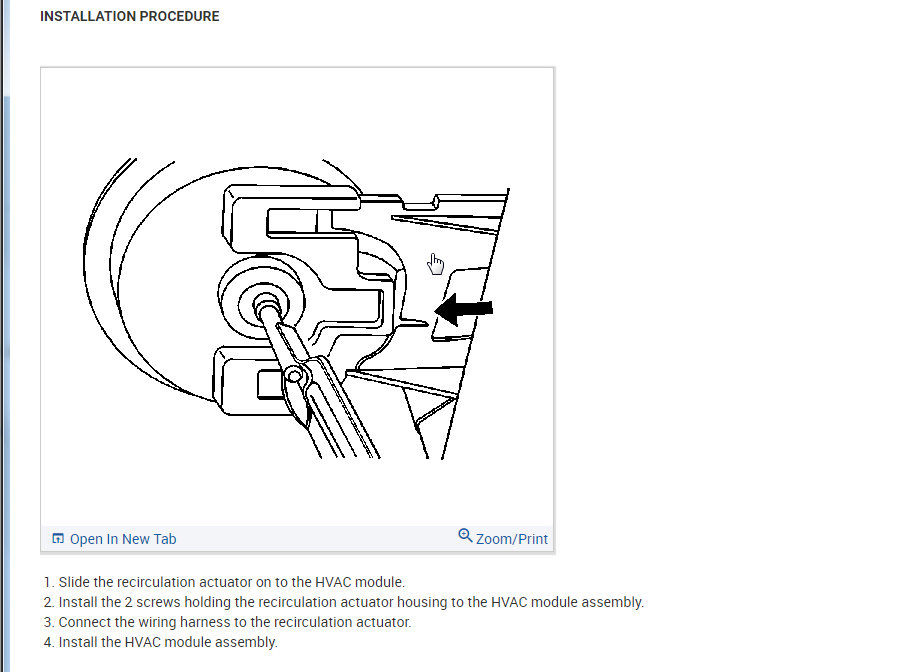

This sounds like it could be one of two things. It could be the actuator behind the glove box or it could be the blower motor which is also behind the glove box.
I would suggest removing the glove box and turning on the system so that you can pinpoint the noise.
Here is a guide that talks about this:
https://www.2carpros.com/articles/blower-fan-motor-works-on-high-speed-only
Please run through this material and let us know what you find as I suspect you will see the issue.
