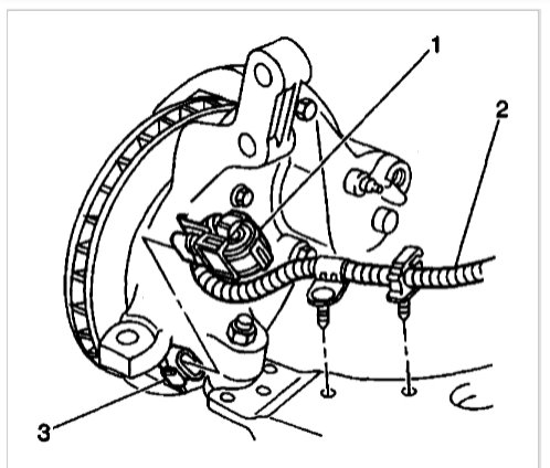

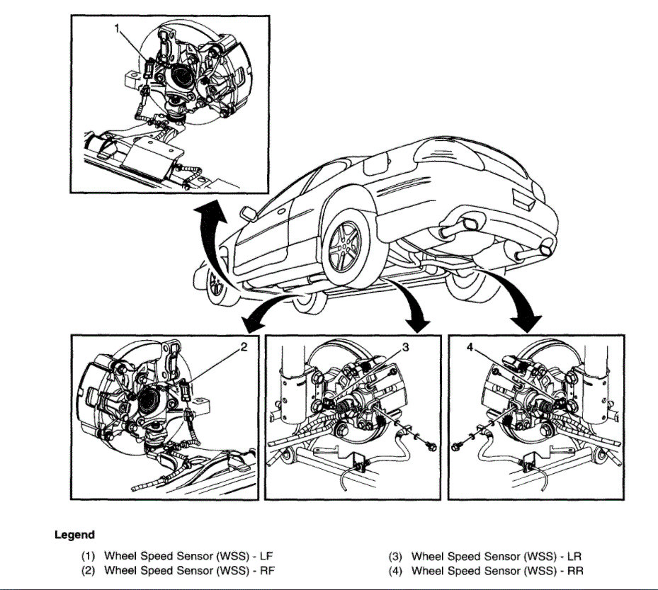

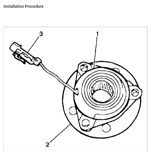

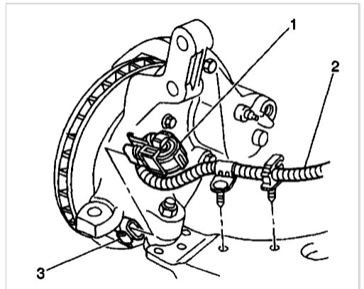

The most common cause of an ABS/traction control light being on is the result of a failed wheel speed sensor.
What I need you to do is check the sensors. At each wheel, there is a speed sensor on this vehicle. See the pic below. To check a sensor at home requires a multimeter and a safe way to lift one wheel from the ground at a time. see pic 1 below
Here is a link that explains how it's done:
https://www.2carpros.com/articles/abs-wheel-speed-sensor-test
As Danny mentioned, in most cases a bad sensor will cause the light to come on, both the ABS and the traction control. So this is a good place to check.
Also, low brake fluid will set the lights as well, so make sure you confirm the master cylinder is full.
Let us know what you find.
See pic below.

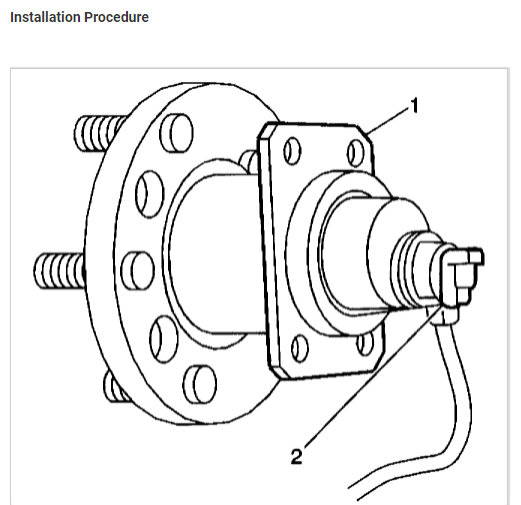

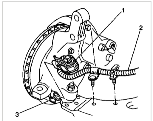

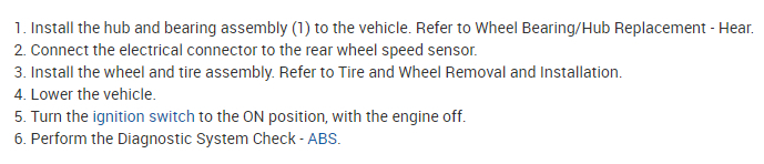

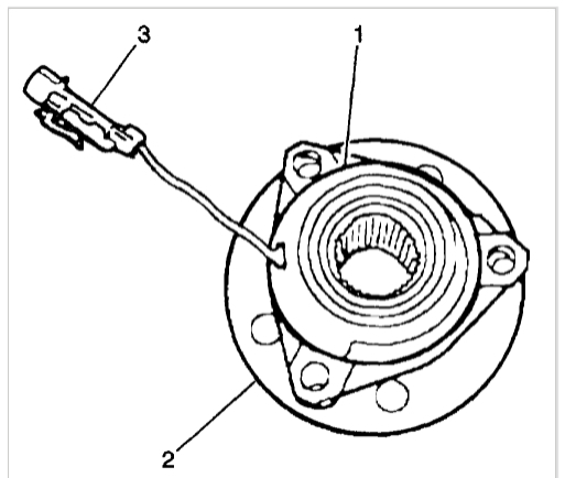

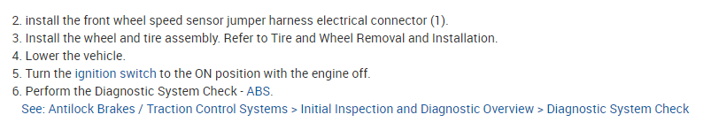

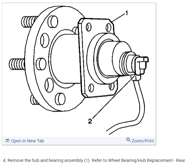

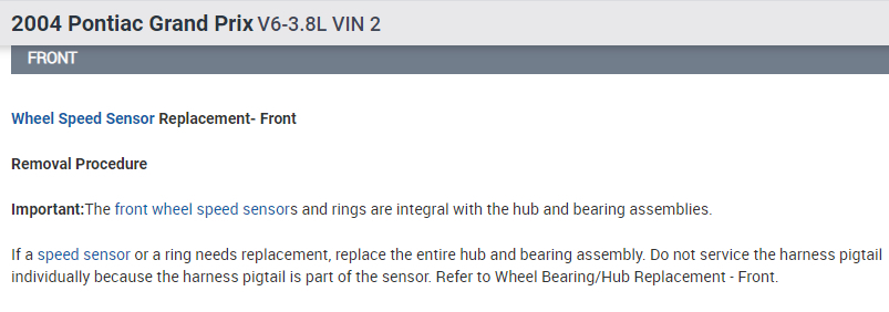

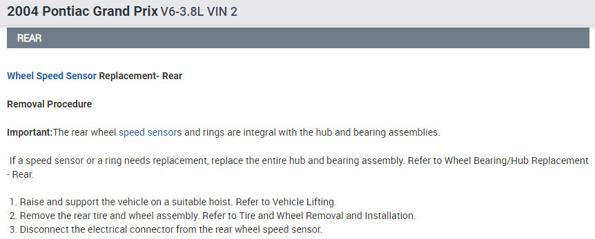

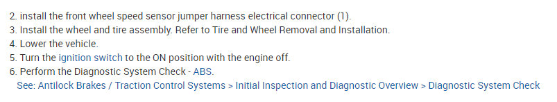

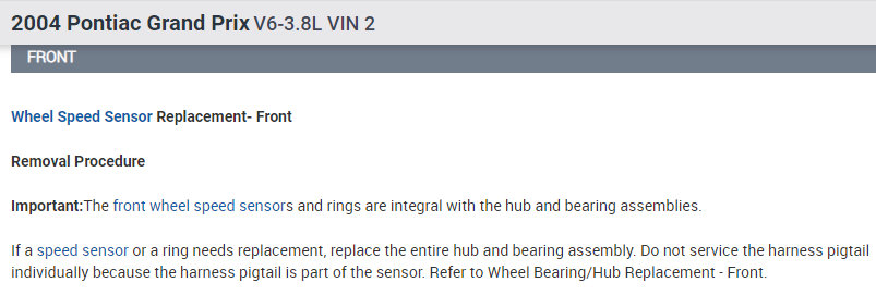

After testing wheel speed sensors as Joe mentioned here is a tutorial showing how to replace wheel speed sensors:
https://www.2carpros.com/articles/how-to-replace-an-abs-wheel-speed-sensor
I've attached picture steps below on how to replace the front and rear wheel speed sensors on your car if they are determined to be at fault. Hope this helps and thanks again for using 2CarPros.
