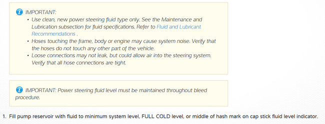

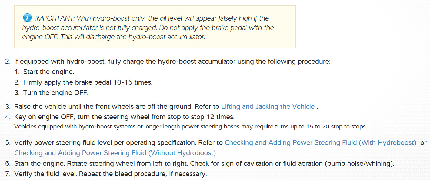

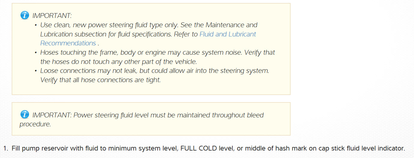

have pump checked for correct pressure. also, try this in picture.
