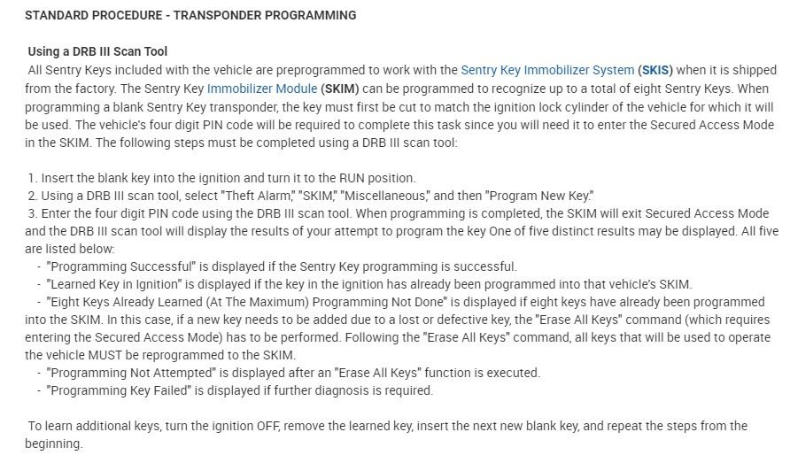

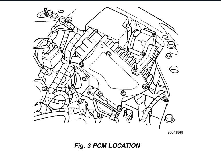

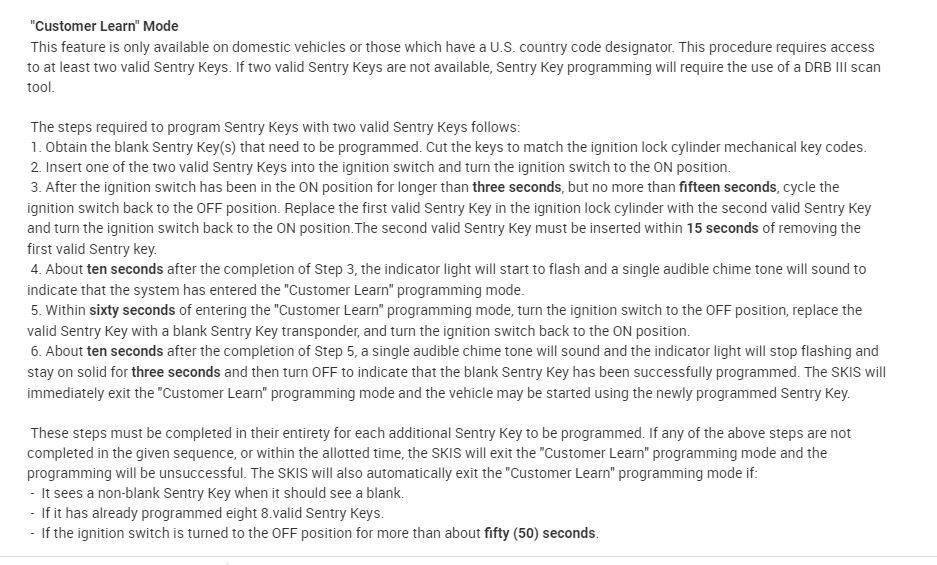

Good morning,
I do no think the PCM will resolve the key issue but they need to communicate with the system in order to program the keys.
If they feel the PCM is the issue, then that will have to be done before attempting to program the key.
