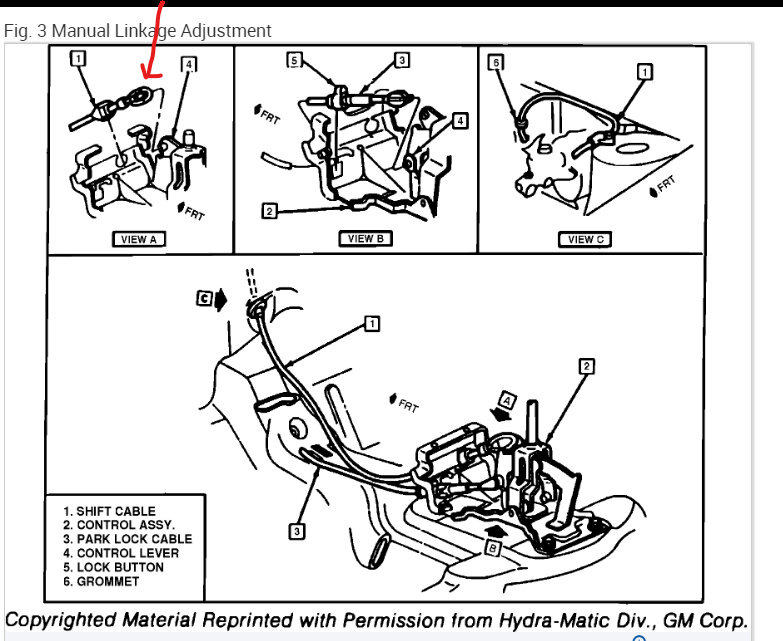

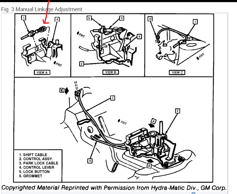

Yes, tires are straight. I need to get it in neutral. I can chock the wheels and have someone inside with a foot on the brake and the parking brake engaged. I need to find the gear linkage to disconnect so I can move it out of park. It's so old. I have no idea whether I have to jack it up or go under the hood. Any info would be appreciated!
Oct 23, 2023 at 5:06 PM
Here is how to disconnect the cable from inside the car. Check out the images (below). Please let us know what happens.
