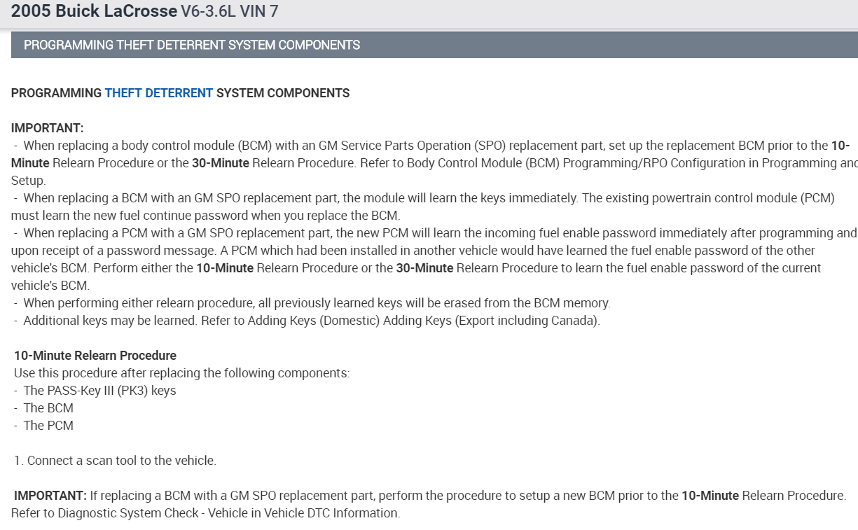

You will have to have another key cut either at the dealership or at a locksmith shop. The reason why, is that your vehicle uses a chipped key to start it. I believe that General Motors uses resistance in the circuit to get to a final voltage, and if the Power-train Control Module (PCM) does not receive that exact voltage your vehicle will not start.
