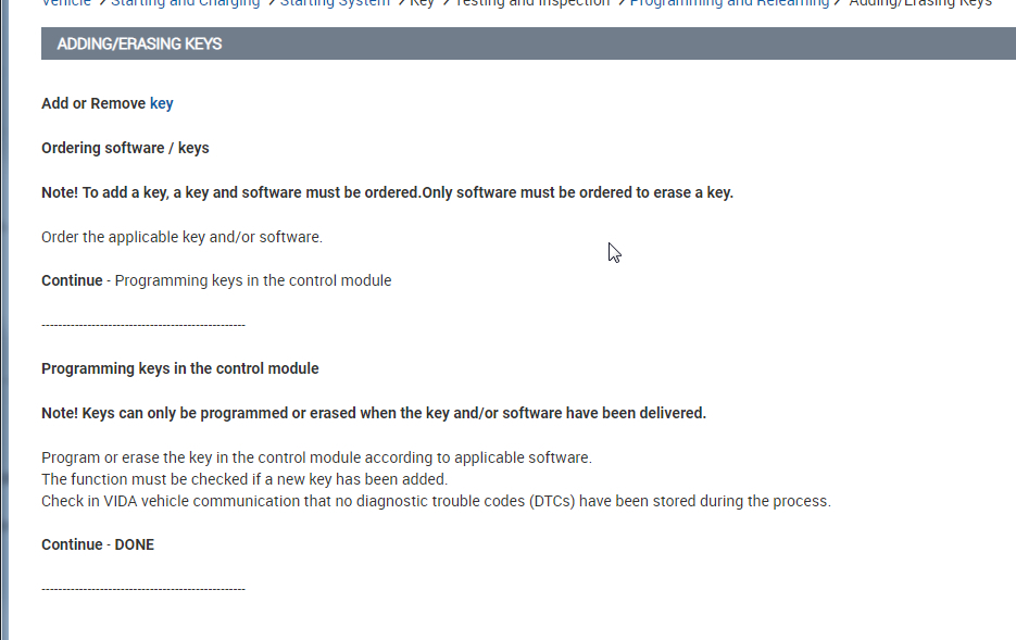

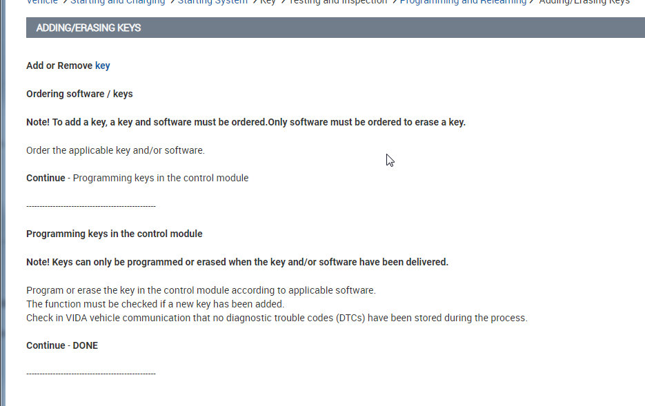

Let us know if there is more info to this if this answer doesn't seem to solve what you are dealing with. Below is the info from the manual to program keys if you need that.
