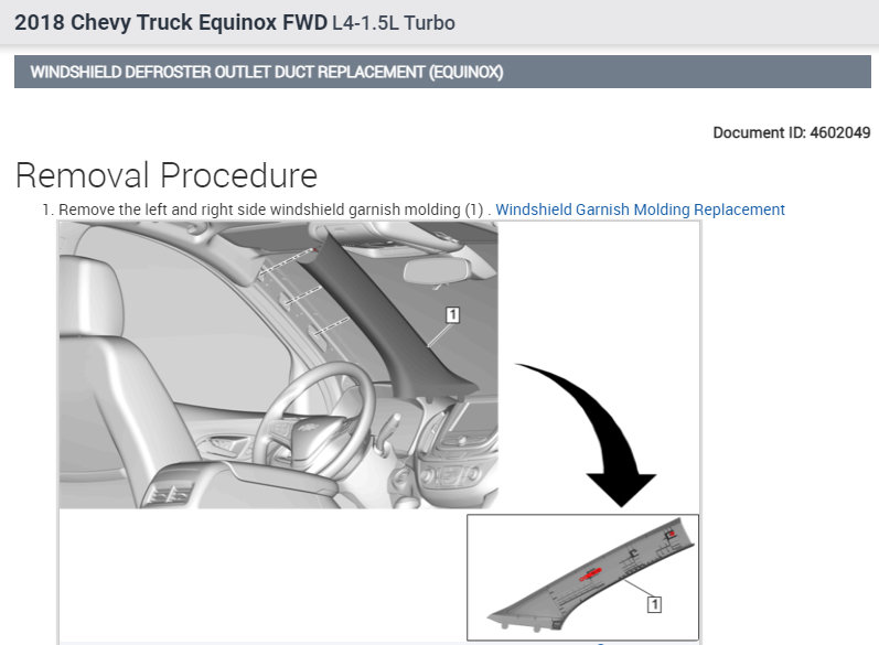

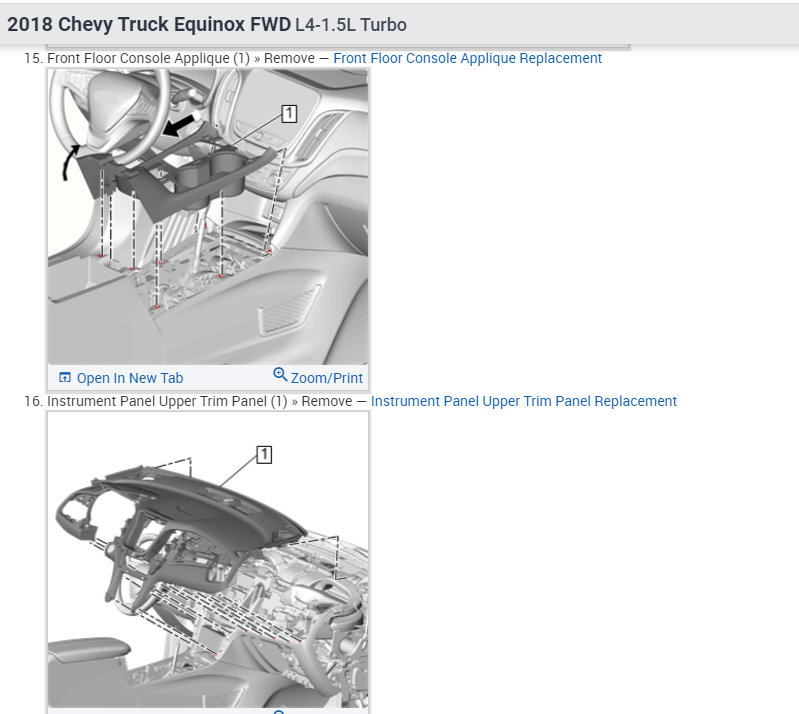

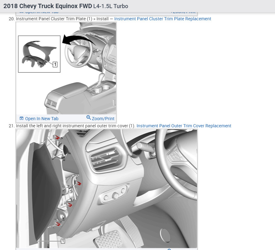

A SD Camera Card fell into the passenger defroster vent of my vehicle, and I was looking for some help getting it out. I already checked the blower motor and filter and didn't see it in there. Any help would be appreciated.
Aug 2, 2022 at 2:28 PM
SQM
  • 6,383 POSTS

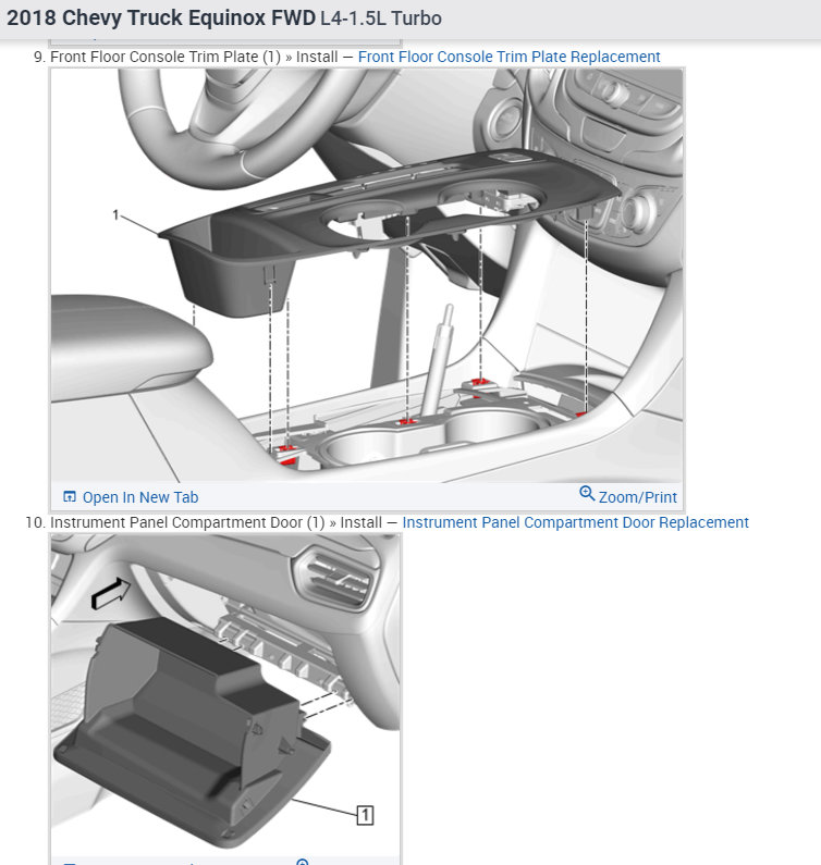

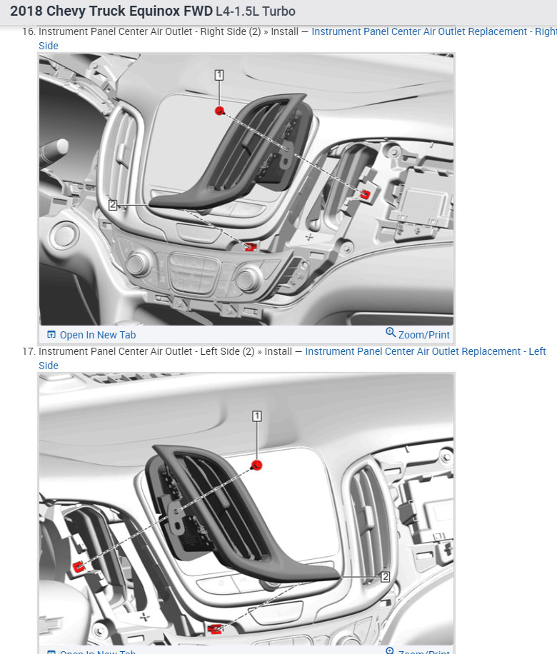

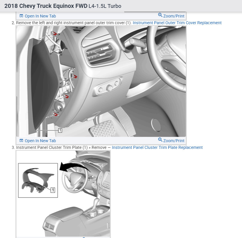

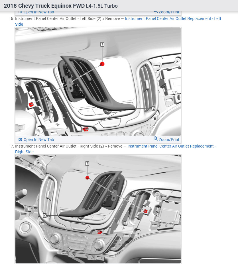

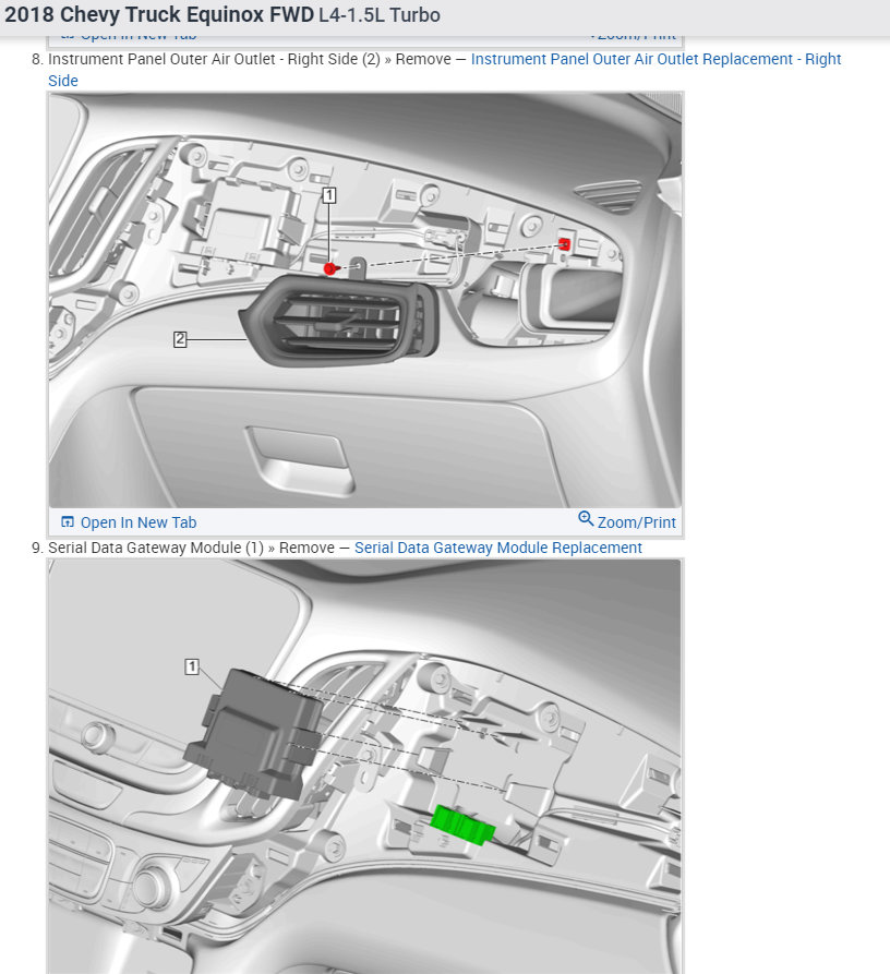

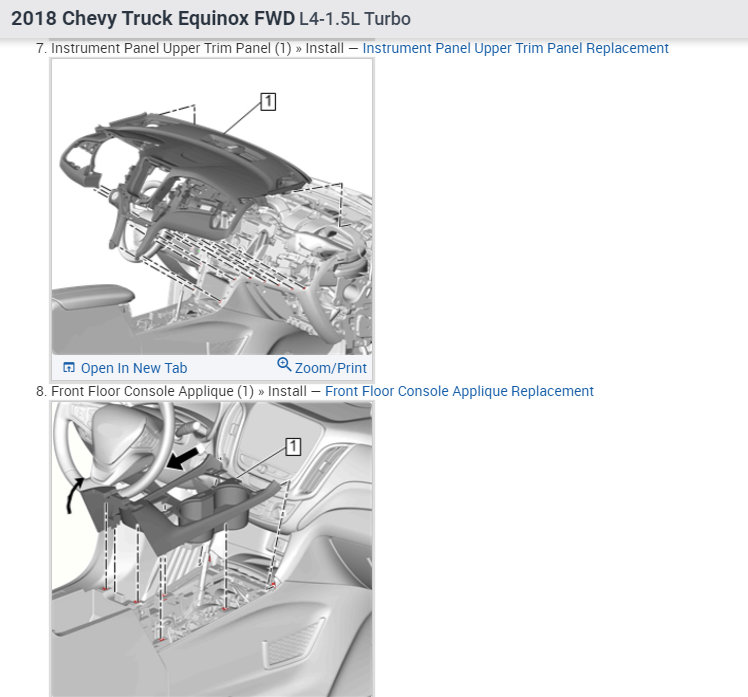

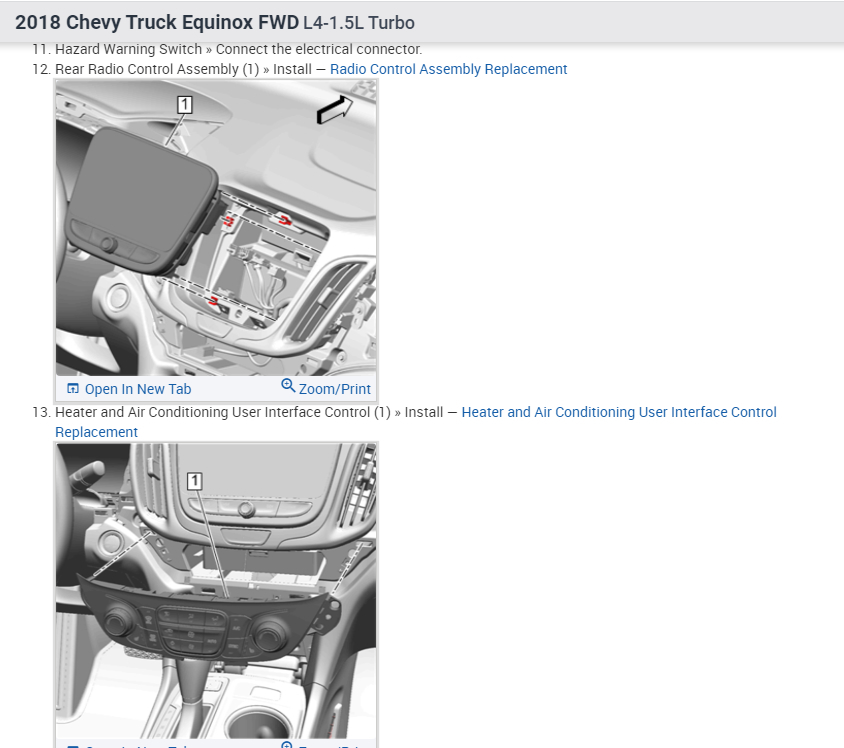

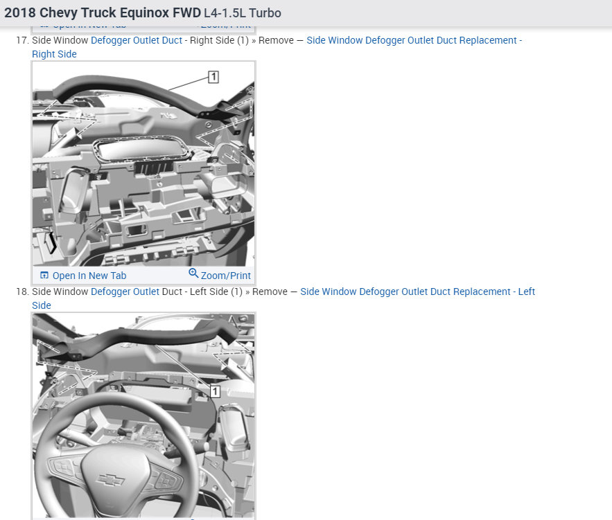

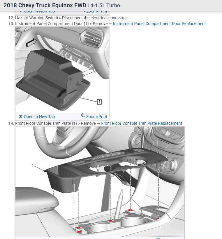

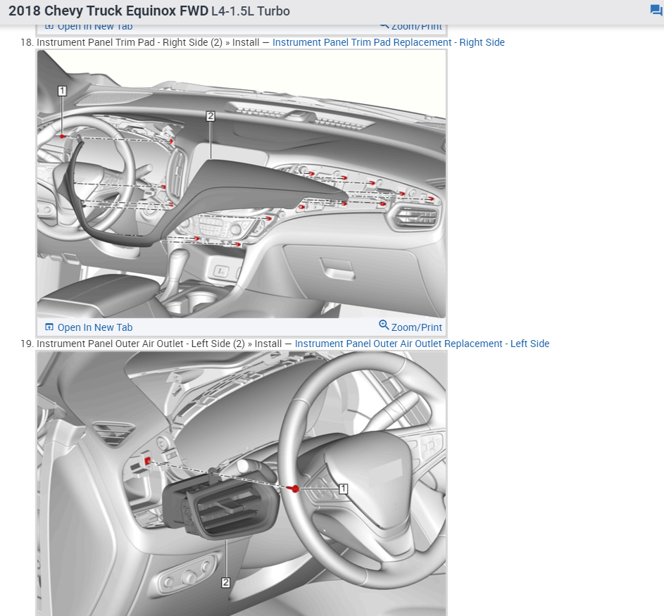

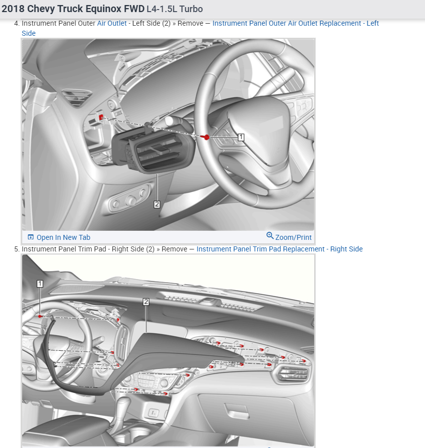

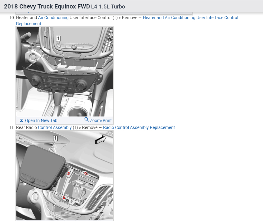

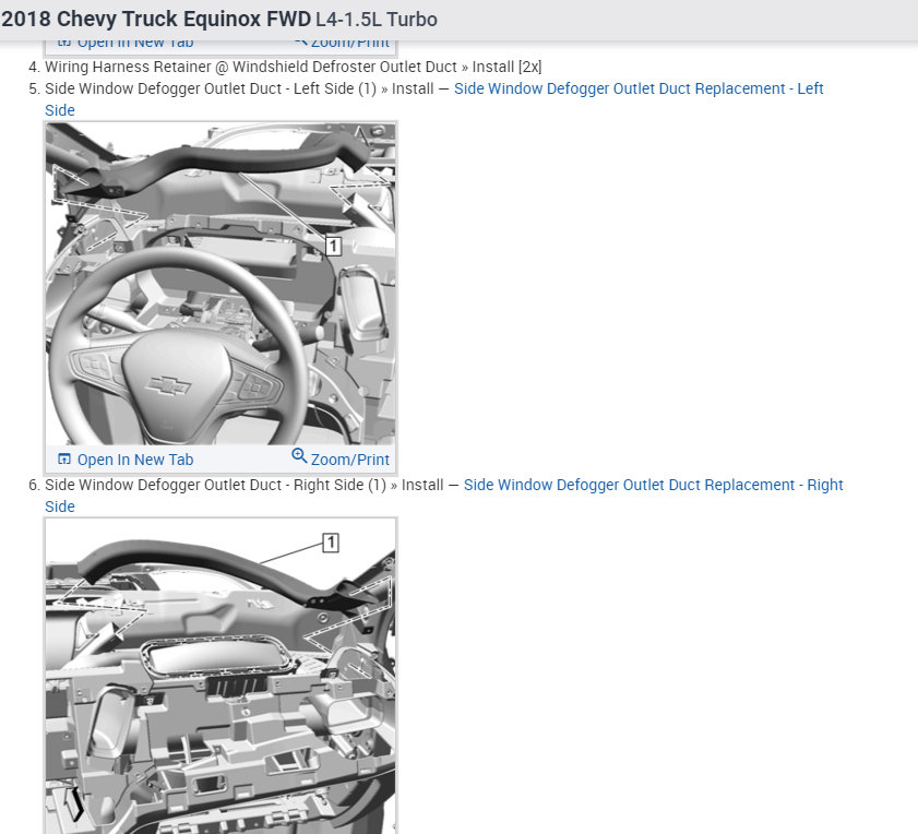

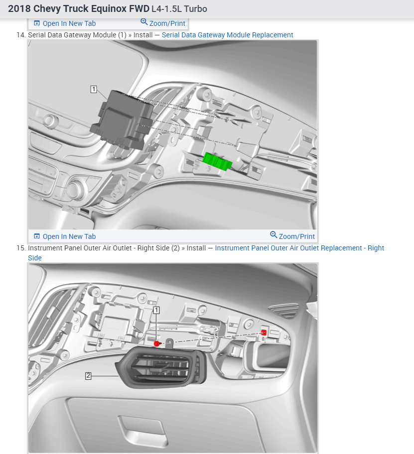

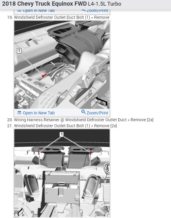

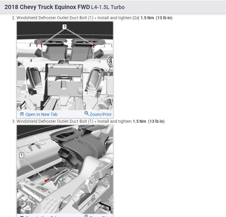

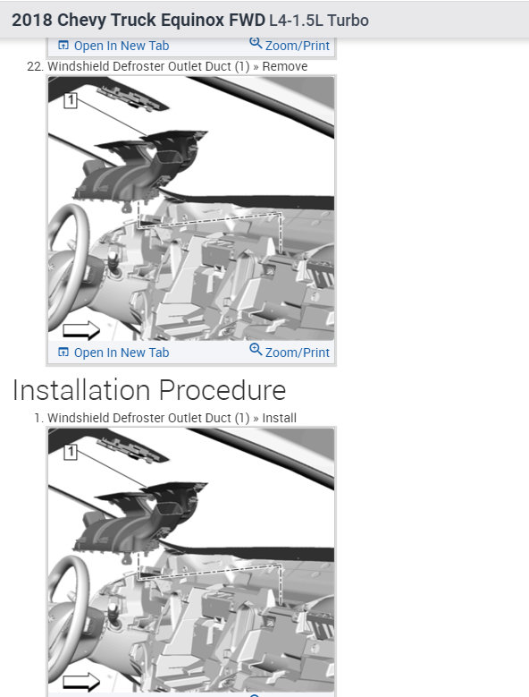

It is possible that the SD card is stuck inside the duct.
In order to find it you will have to remove the duct.
Which does require the upper part of the dash to be removed.
I have attached the defrost duct removal/install procedure below.
Let me know of any questions.
