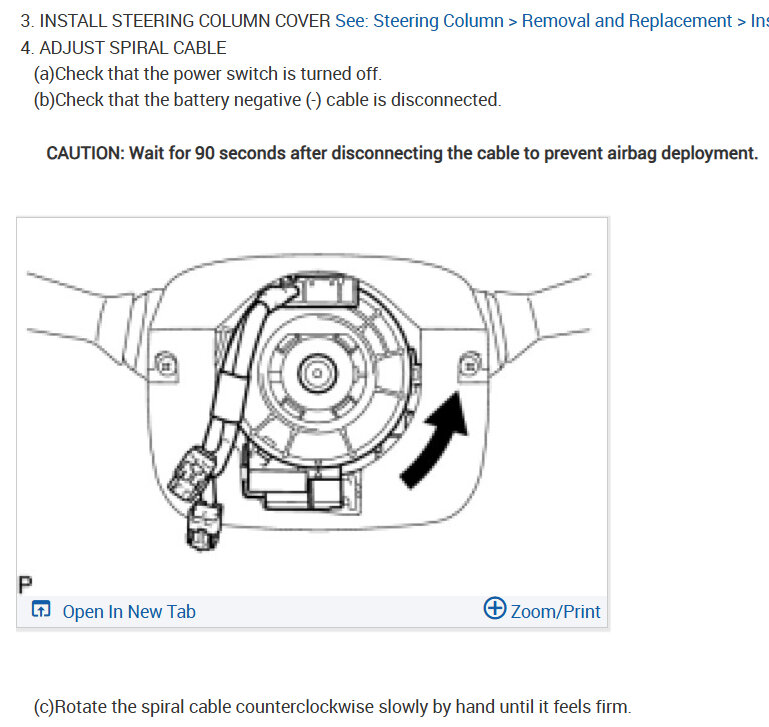

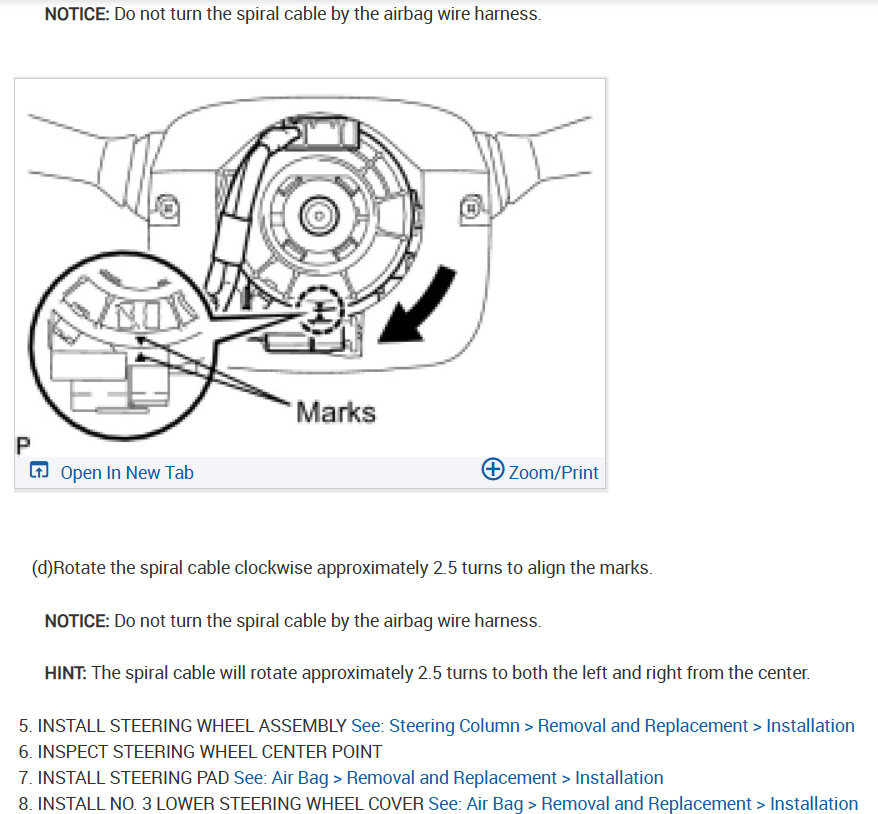

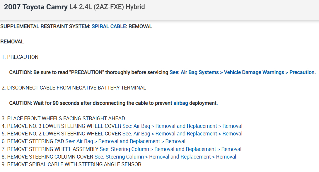

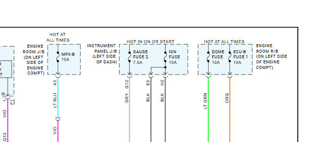

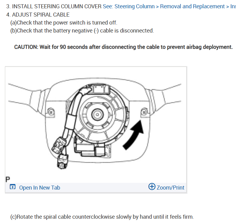

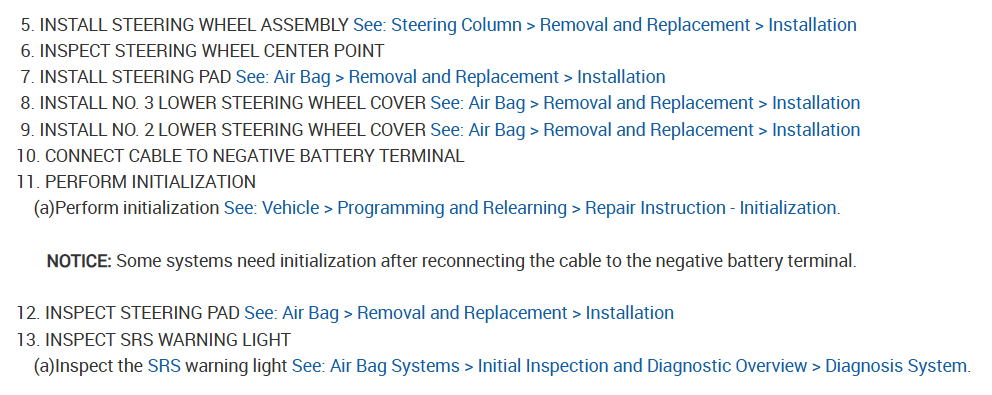

My check hybrid system light is on. Scanned it. It says p3107. Lost communication with airbag. Please, how do I resolve it? The problem started shortly after I washed my car engine. I did further scan, and I am getting B1000.
