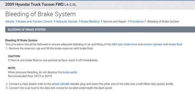

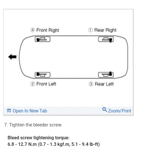

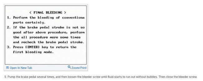

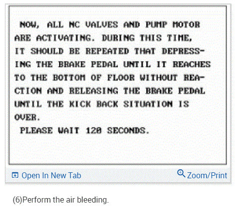

I have lost my brakes completely on my JM Hyundai Tuscon. Cannot get fluid to front left and rear right calipers when manually bleeding. Front left caliper recently seized and since replacing I have had this issue. getting a c1513 Brake switch circuit error on my diagnostic scanner. However, I can also hear air expelling through booster when applying pressure to pedal and master is not drawing fluid from reservoir when pumping the pedal which is leading me to believe it is more of a master cylinder issue?
