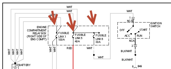

We had the car sitting in the parking lot left it running to grab a redbox. The car died we crunk it back up and it ran for a few seconds. Then we lost all electrical power except for the lights on the rear view mirror and the open door indicator on the dash. The car will not turn over at all.

check the three fusible links in the electrical relay box lh side of eng. compt. and fuse 11 on rh side. if still won't start try resetting your anti theft.

Checked all fuses they are good. The power locks work but not the windows. How do we reset the anti theft?

did you check the fusible links underhood? you 'll hav eto contact dealer on how to reset or if you have an owners manual look in there, we just fix them dont' reset them. see pic for fusible links. if anti theft is bad the car wont' turn over not have any power look at these links first use either a volt meter or test light.
