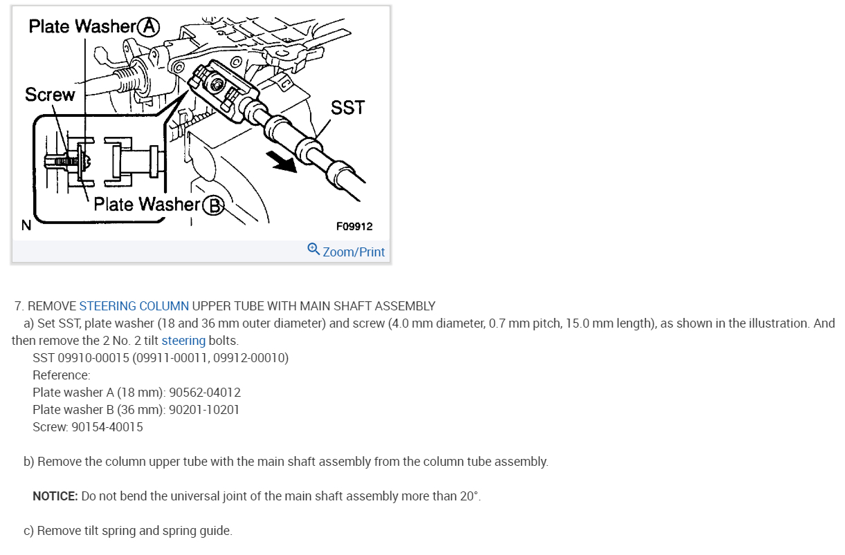

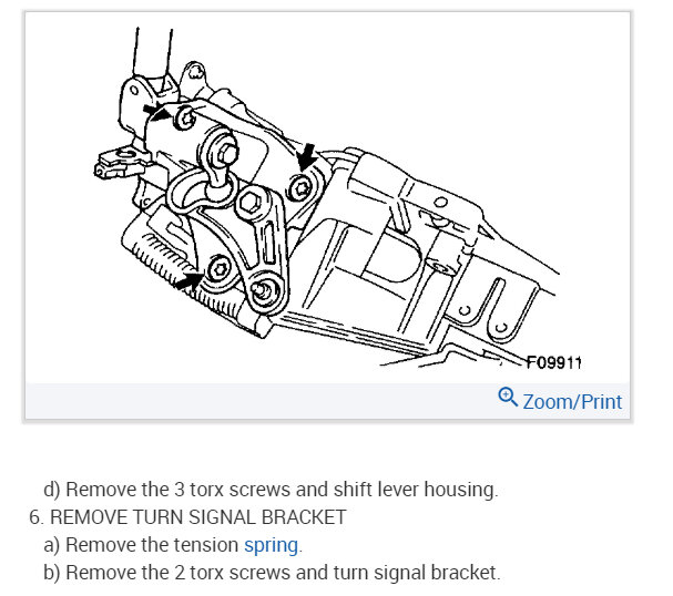

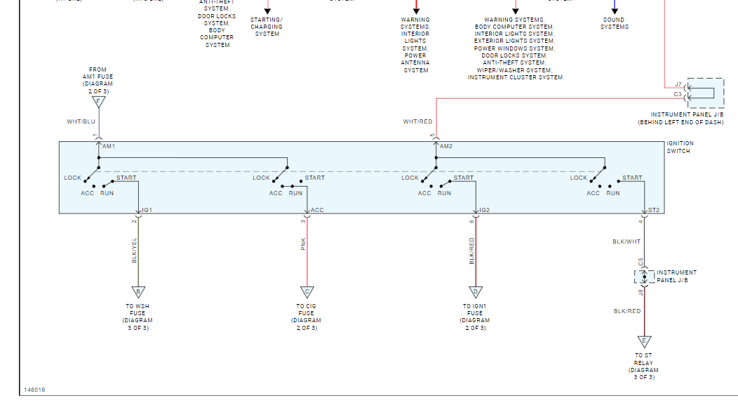

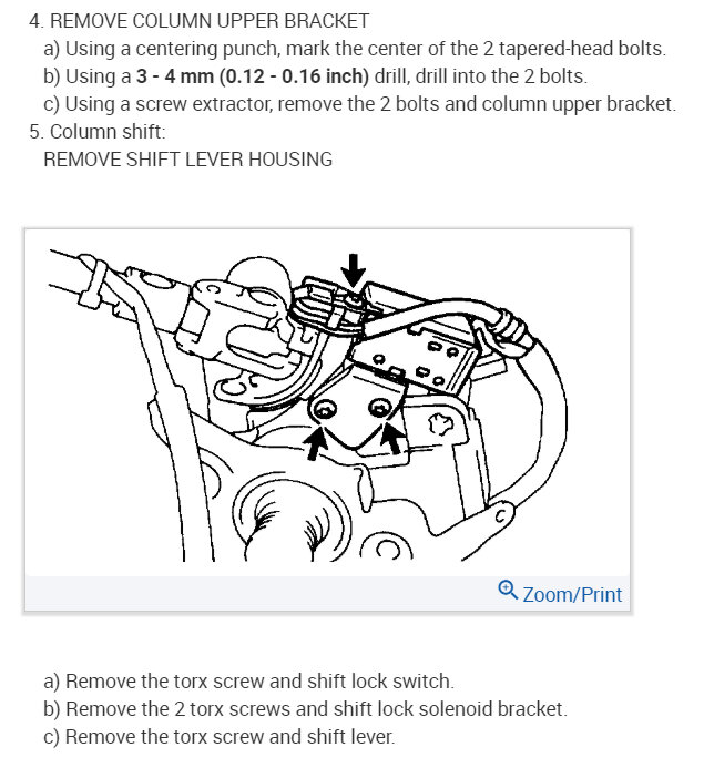

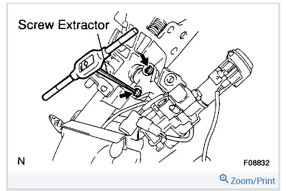

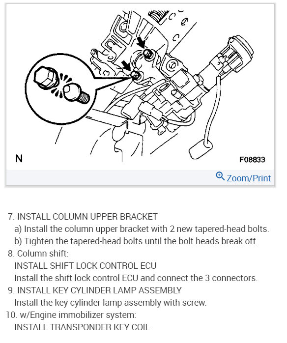

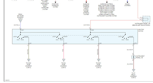

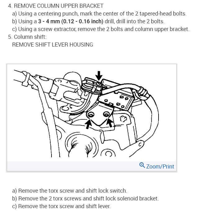

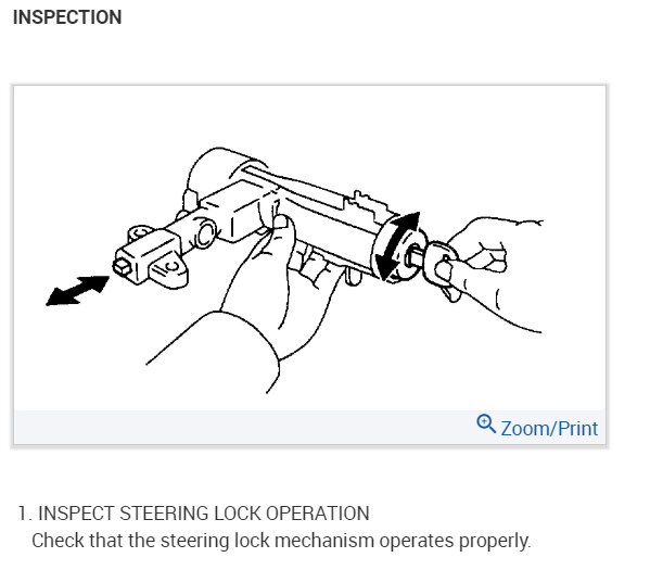

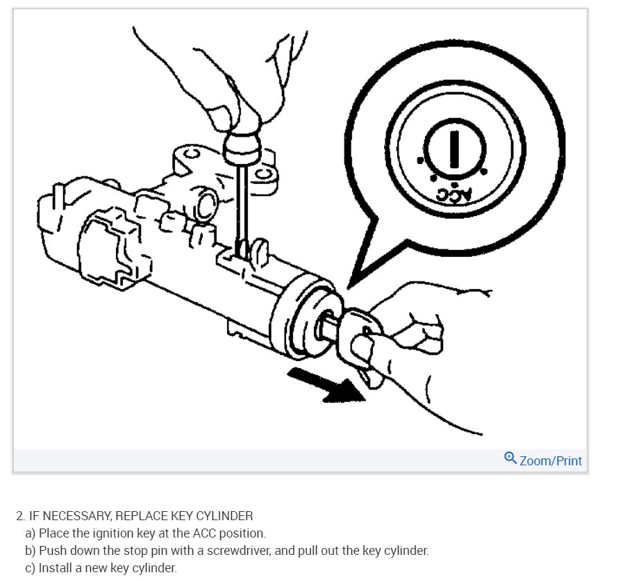

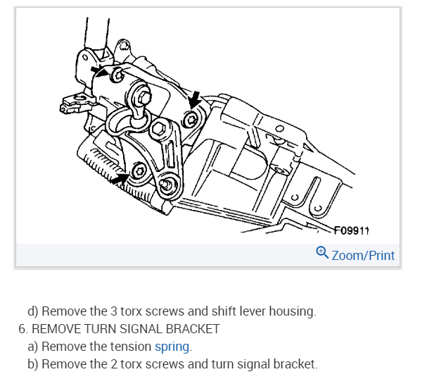

It sounds like the ignition switch went out but to be sure let's check for power at the 2, 3 and 6 terminal numbers at the switch, this guide can help:
Test with the key on, if you don't get power the switch is the location of the switch and how to replace it. Check out the images (below). Please let us know what happens.
