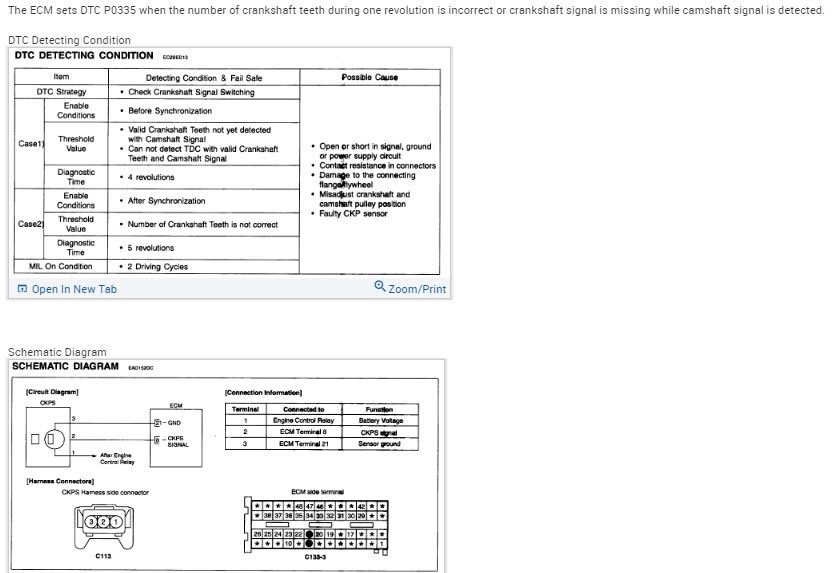

Hi. Recently i had a strange problem and a randomly loss of power. I start engine in morning and it hasn't its usual power after a while a shut it off and in next start it's power back and everything normal. but it is randomly maybe one start and shut off or two. i suspect to something. Recently i bleeding my power steering pump like what my manual says. It says unplug ignition coils then cranking intermittently for about fifteen seconds while turning wheels to right and left. I did it about ten times to bleeding power steering. Could it damage something? Because i had a p0335 code and changed crankshaft position sensor but nothing changes.
Feb 14, 2019 at 11:52 PM
HARRY P
  • 2,292 POSTS
Hello and welcome to 2CarPros.

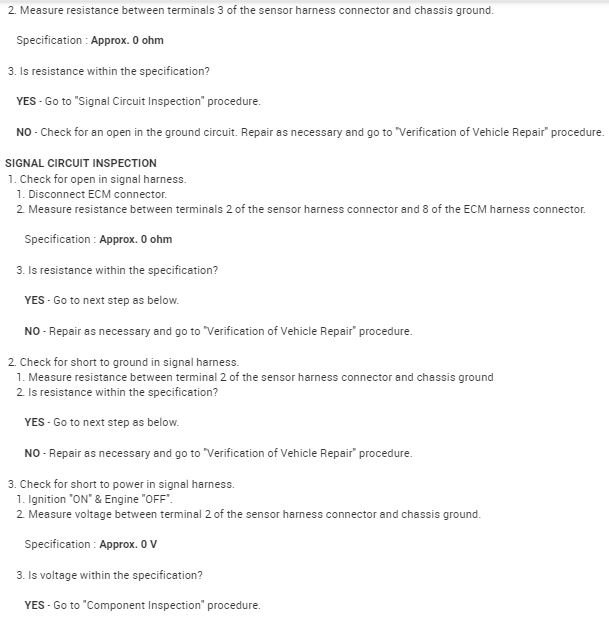

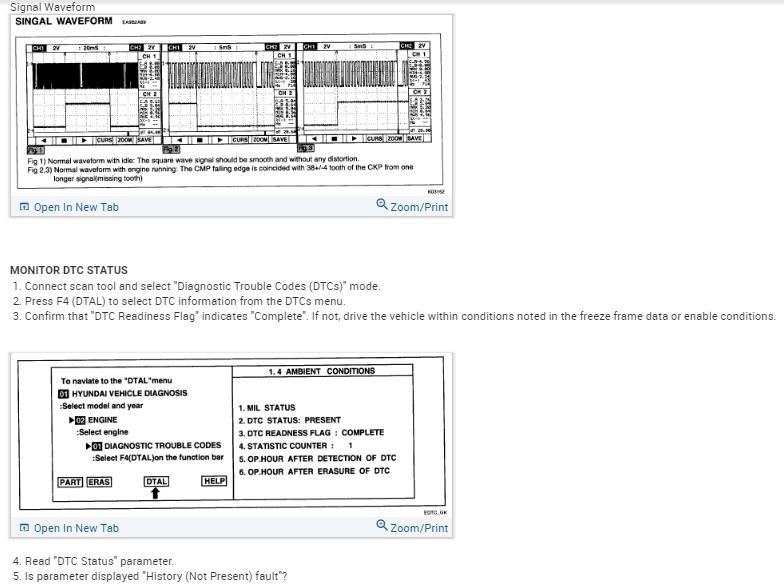

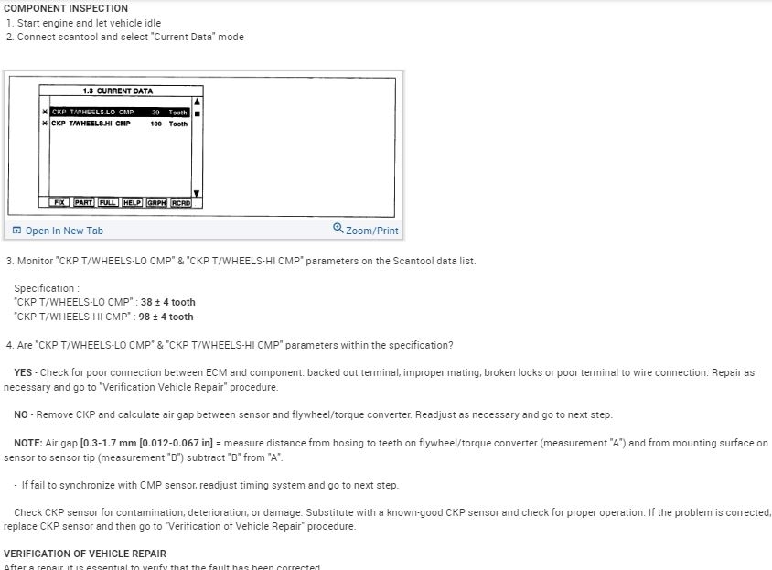

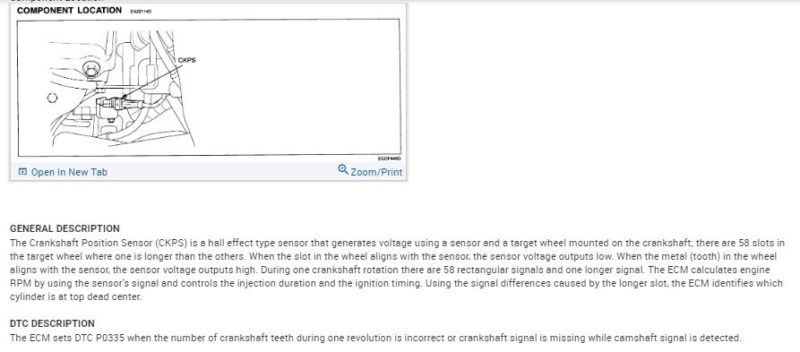

When you changed the crankshaft position sensor, did you happen to clear the codes or unhook the battery for a while? It's possible that the computer needs to go through a relearn procedure. The best way to get it to do so is to simply disconnect the battery for maybe fifteen minutes with the headlight switch turned on (helps drain residual power in the system quickly). Then connect the battery, turn the lights off, and start the car and let it idle for a while. It may stall or not want to idle correctly for a while, but should eventually smooth out as the computer gets acclimated to the sensors and other such things. So if you haven't done that yet, then give it a try.
Also, did you do any diagnostic testing before replacing the sensor (such as checking the wiring for shorts, etc)? I ask because a short circuit or misadjusted sensor can also cause the p0335 code. I'm going to attach AllData's instructions on diagnosing the p0335 code in the images below. Go through it and do any tests that you haven't already done. As a matter of fact, I'd suggest just doing all of it, even if you've already done some of it. It never hurts to recheck your own work.
If, after going through the procedures listed by AllData, you still have the code and symptoms, it may be that it's simply time to have the timing set replaced (timing belt, gears, guides, etc). This is normal maintenance. Hyundai calls for replacing the timing belt every 40,000 miles. If it hasn't ever been done, then go ahead and get it done ASAP. Failing to do so can cause catastrophic damage to the engine, requiring either rebuilding or replacing the engine;
I understand if you don't have all of the tools needed to go completely through AllData's diagnostic procedure (most people don't have them) so do what you can. If you can borrow an oscilloscope and/or a high end scanner with live data modes and such, then do so.
How a timing belt works: https://www.2carpros.com/articles/how-a-timing-belt-works
Here's a nice little article on timing belts in interference engines (like yours): https://jalopnik.com/heres-what-happens-when-your-timing-belt-snaps-and-how-1643804882
Good luck and let us know what you find. We'll go from there.

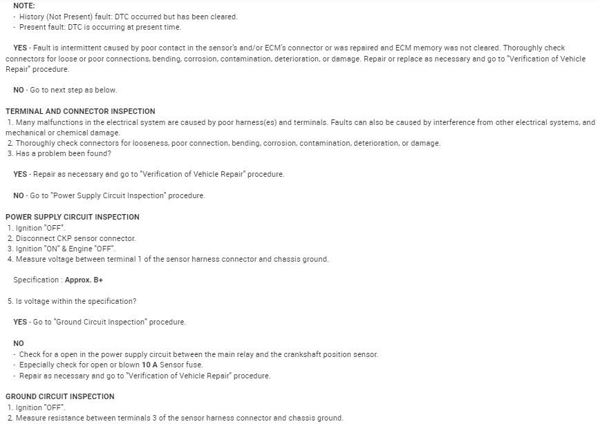

Thank you for your help. I disconnect negative battery terminal before change sensor and after that everything restart. My question is, if it's a timing problem why it shows randomly and from one start shut off to next? I want to know could my procedure of bleeding include cranking too long about ten times damage something else? Because i smell some burnt from engine after bleeding. In my opinion it has an electrical problem somewhere. how can i check for that?
Feb 15, 2019 at 6:59 AM
DANIYALKZA
  • 111 POSTS
For update i measure voltage between terminal 2 and chassis with ignition on and engine off. It was 4.96 without ecm disconnect. Should i disconnect ecm? Where is it connector? manual saya it has to be 0 volt. So am i have a probelem? If yes how can i fix it?
Feb 16, 2019 at 5:09 AM
DANIYALKZA
  • 111 POSTS
It seems problem is some where else and i can't find it.i will be soo much pleasure if some one can help.what could happen between a engine shut off and start to run better

Again, have you run through the diagnostic process for the p0335 code. To answer your last question, a lot of things can happen that'll make the engine run better after a shut off and restart. Mostly they involve wires and weak grounds.
You could be looking at a fuel flow issue (weak pump that is sometimes better than others or maybe a clogged filter). Honestly, I think that your problem is in that p0335 code. Go through that diagnostic.
Also, again, if the car hasn't had that timing set, get it done fast before you have pistons smashing into valves because of a broken timing belt and requiring expensive repairs.

I did diagnostic and find nothing wrong but can't do it completely because of hard access to ECM. My fuel filter is new and i don't think fuel pump is problem because i replace it. timing belt replaced a few miles ago. i will update whatever happens.

Thank you a lot. Just in case I measure resistance between pin 2 and 3 and it shows me 35 mega ohm and some time infinite resistance. Is it normal?
Feb 18, 2019 at 4:42 AM
Yes that does sound normal. I would clear the codes and then service the throttle actuator because the car sounds like it is going into limp mode. here is a guide that will help you fix the problem. The coking in the actuator causes a correlation issue putting the car into limp mode.
