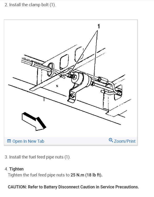

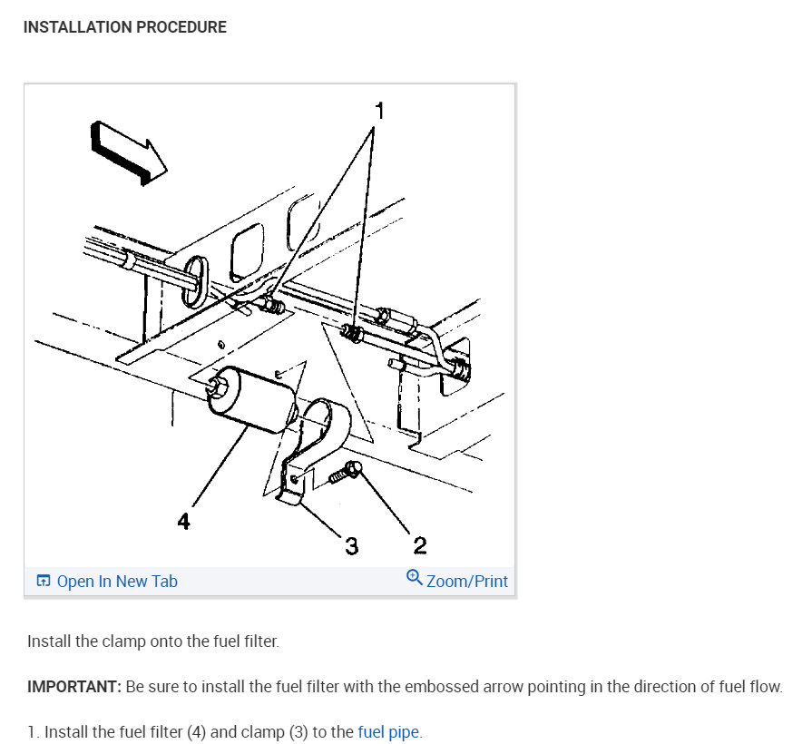

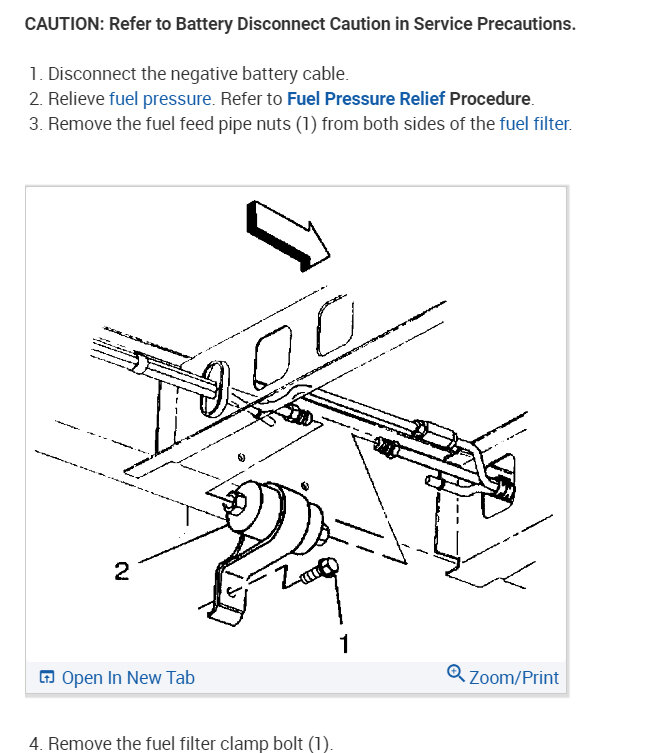

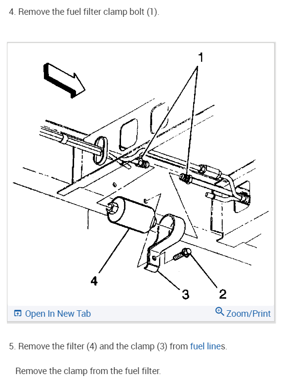

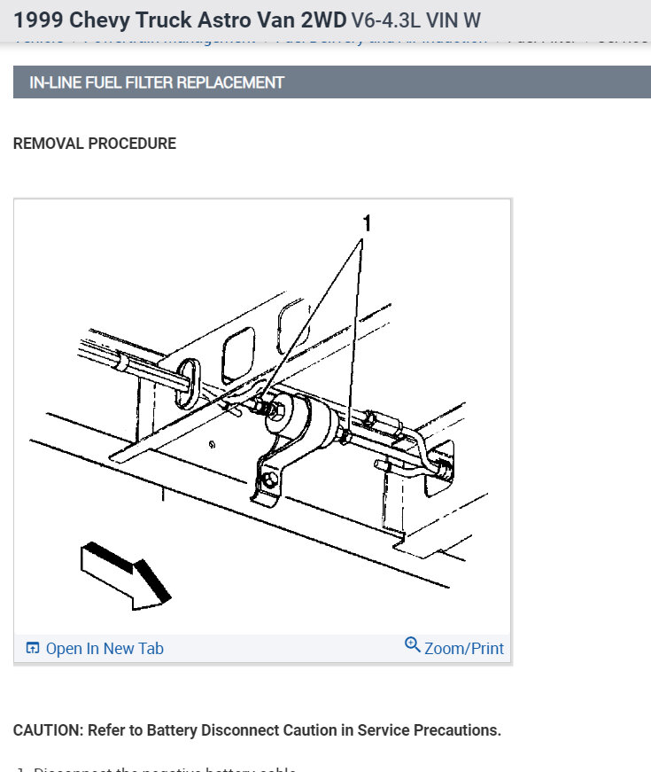

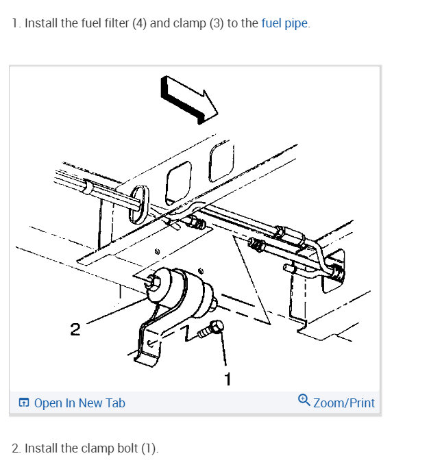

Yep, I would start with the fuel filter, it sounds clogged. Here is its location and I have included a couple guides to help us with the filter location in the images below.
https://www.2carpros.com/articles/engine-has-low-power-output
Here is a generic guide to help you step by step with instructions in the diagrams below to show you how on your car:
https://www.2carpros.com/articles/how-to-change-a-fuel-filter
