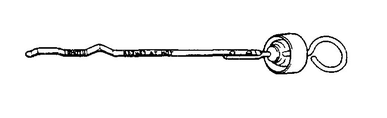

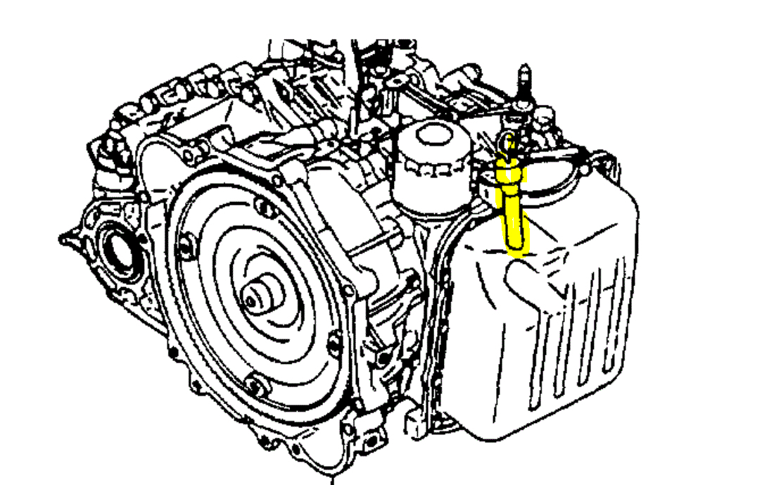

Next, check the condition and the level of the transmission fluid. Here are the directions for checking:
______________________________
See pics 1 and 2 for testing locations.
1) Start the engine and let it idle for 1-2 minutes.
2) Move the select lever through all positions, and then move it to the N position.
3) Drive the vehicle until the fluid temperature rises to the normal temperature (70 - 80°C), and then check the fluid level again. The fluid level must be at the HOT Mark.
