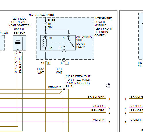

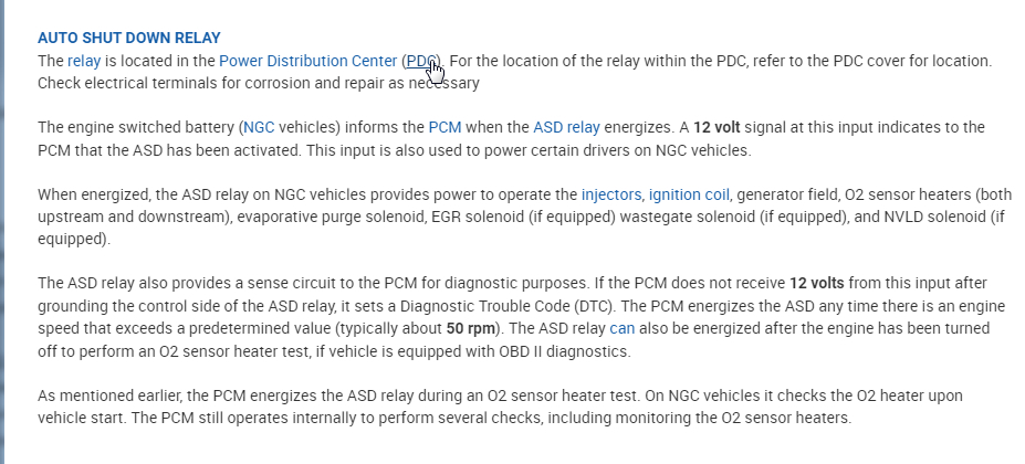

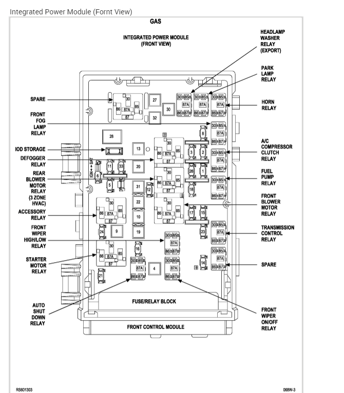

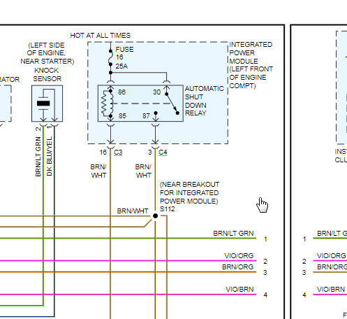

After driving my van for about 10-15 minutes or 20 miles sometimes less usually on a highway doing 55+ mph never seems to happen driving around town.it has no codes and does not overheat has a new fuel pump new plugs wires and coil pack.had no evap leaks or vacuum cleaner leaks have fixed all of those problems in the past. i'm lost with what to do. I've spent a lot of time and money on this van and can't seem to find the problem. only thing I can find out online so far is that maybe it has bad wire in harness,vapor lock (rare problem) or maybe the ECM. I have driven for over 50 miles non stop and no problems yet the next day it will happen again. it's very confusing sometimes it will have a rough idle sometimes it will not, but it seems to be getting worse. the van has been sitting for months now as we are trying to fix it only limited funds.please help me. I need my van, I've got a big family and it's hard to drive them around in my small Nissan, lol.
