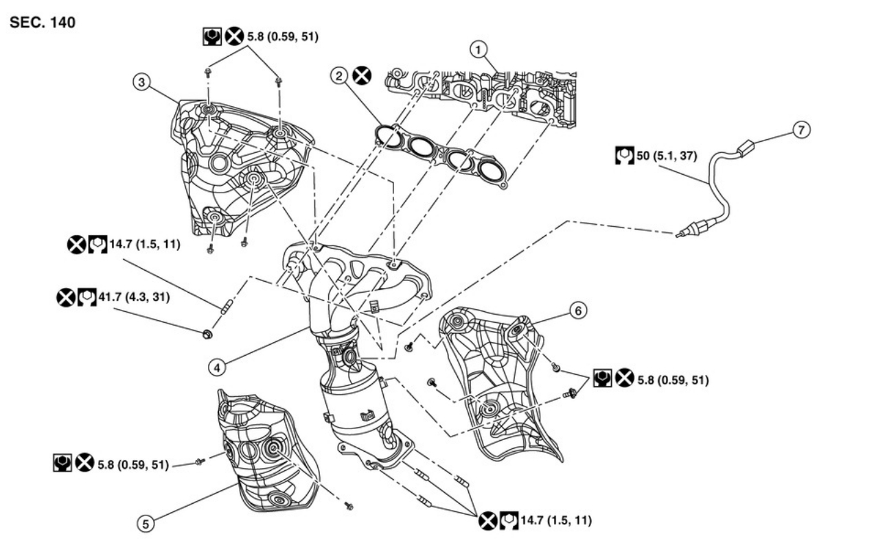

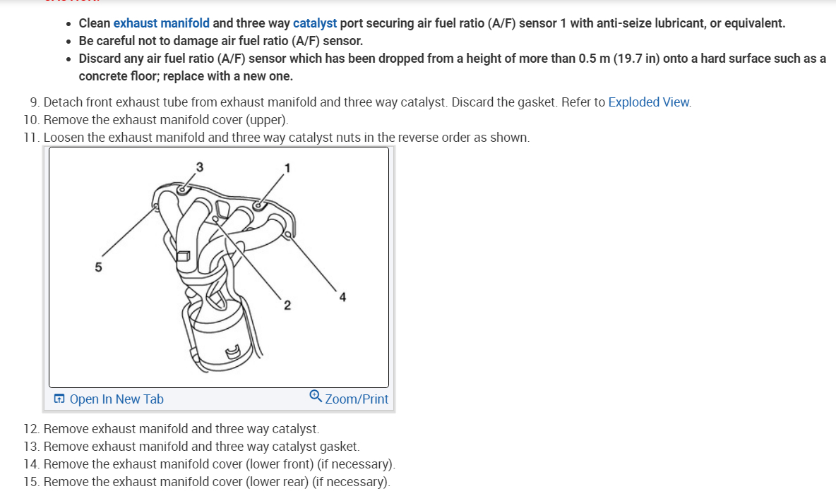

The Diagnostic Trouble Code (DTC) P0420 indicates a potential issue with the catalytic converter's efficiency in your 2016 Nissan Rogue.
Here is a guide to help us see if the cat is working or it has come apart internally and is blocking the exhaust system which is common:

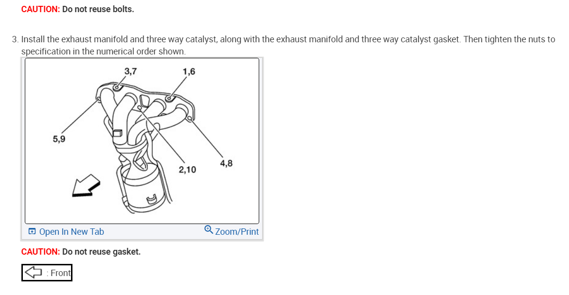

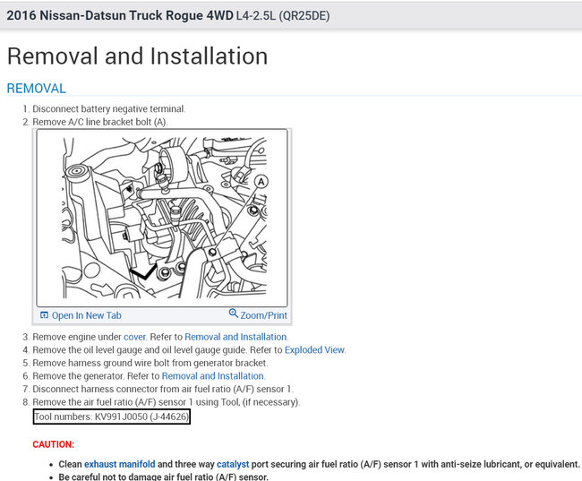

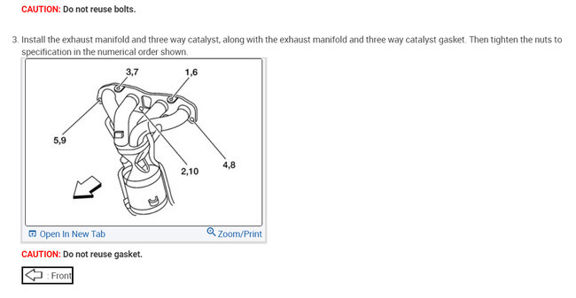

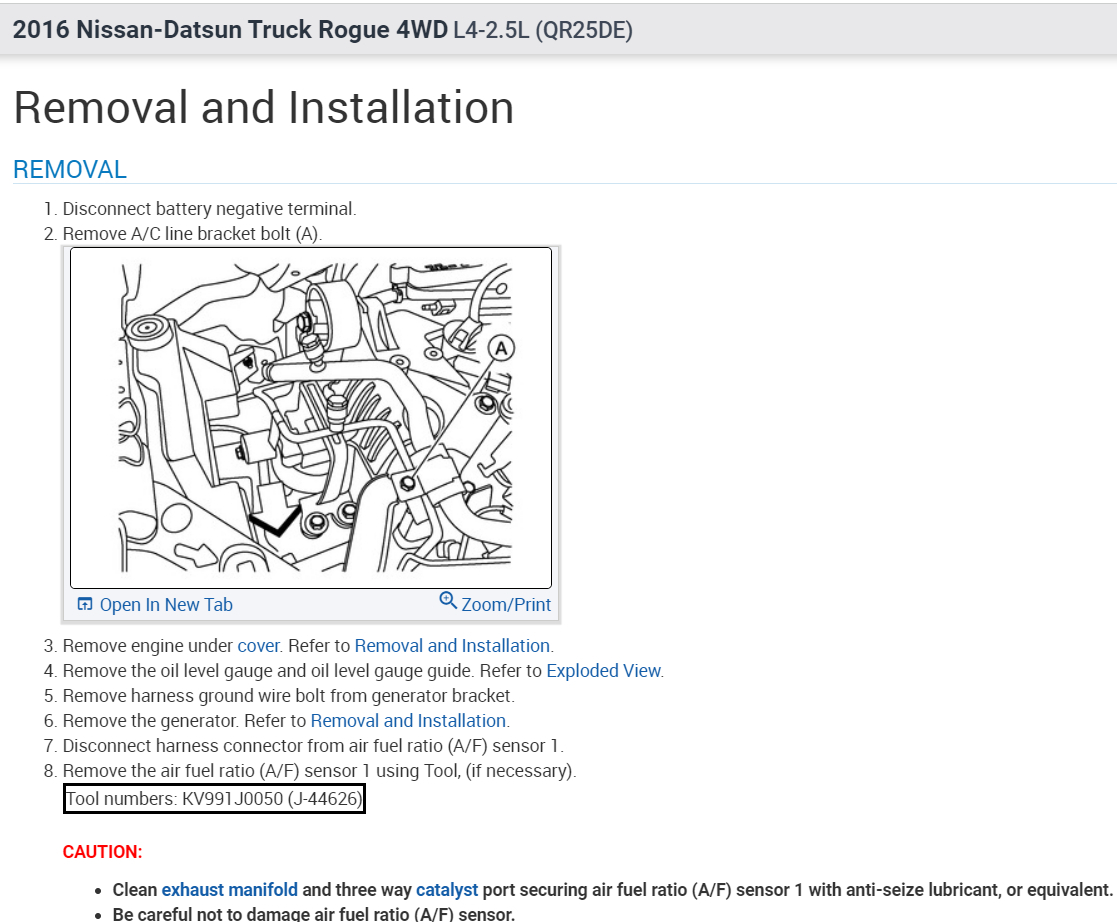

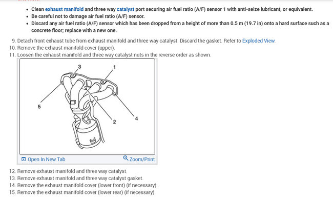

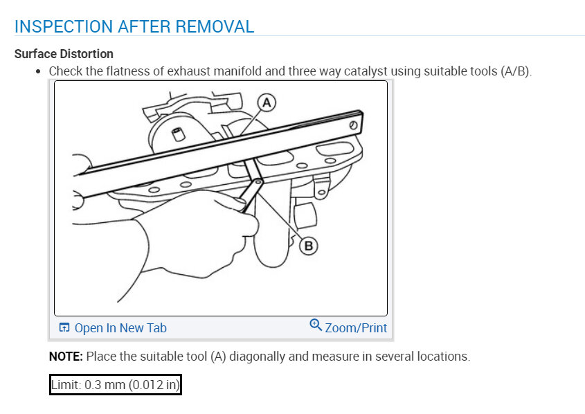

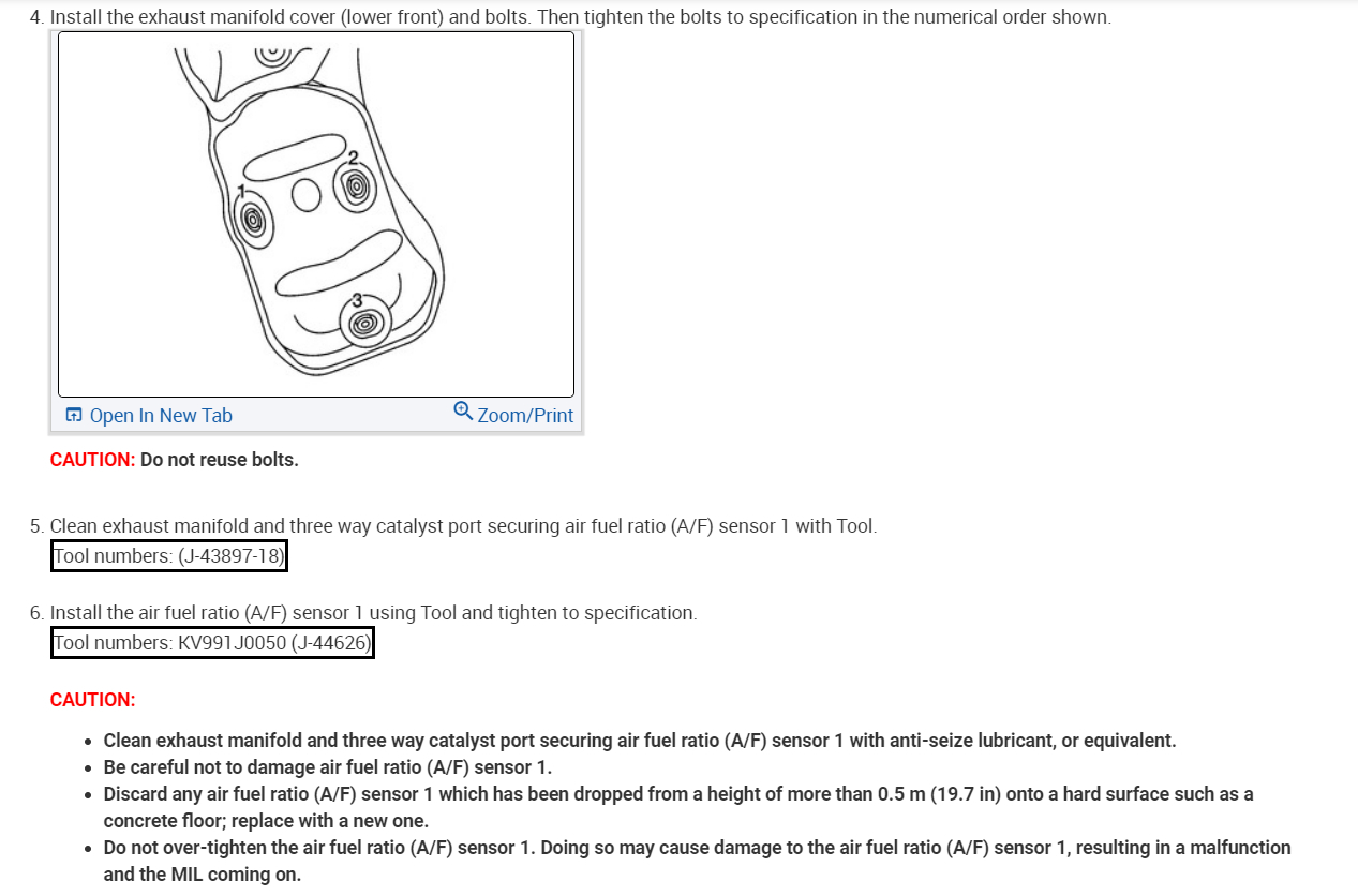

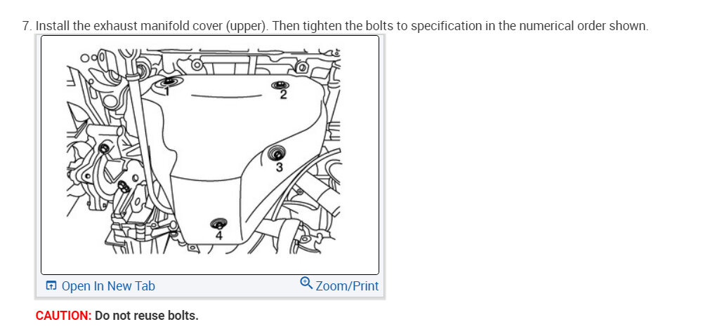

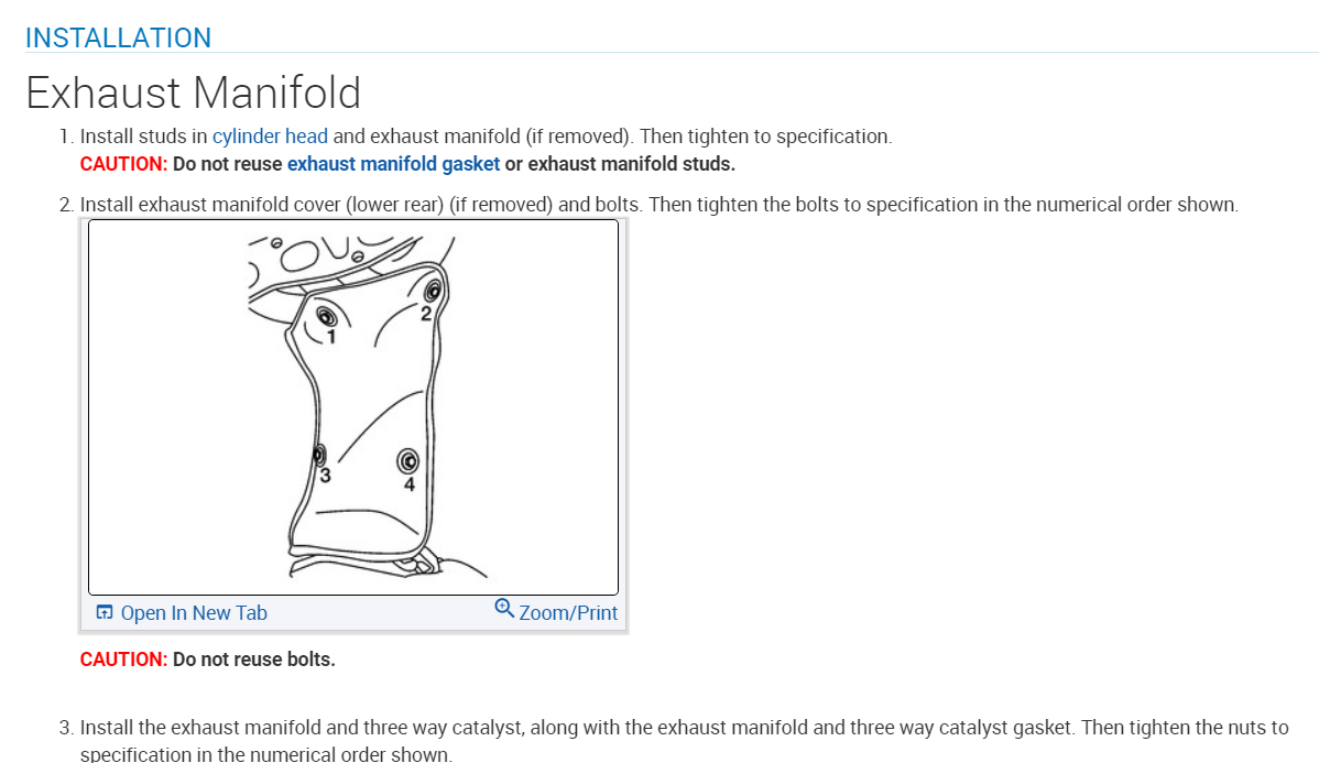

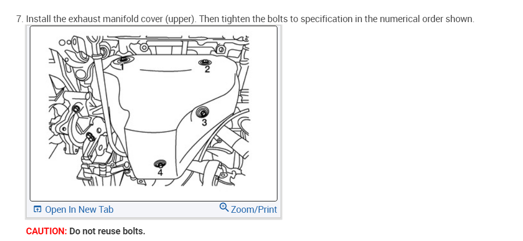

Here is how to change the catalytic converter out. Check out the images (below). Please let us know how it goes.
