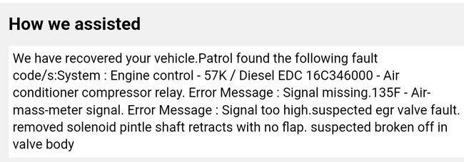

About a month ago my car lost power on the motorway from around 70 mph down to around 25 mph. i had to stop and restart again and that worked. but recently it has started happening more often. The power just drops, i put it in second gear put my foot too the floor and after about ten to fifteen seconds the power comes right back up.
Any ideas?
Thanks

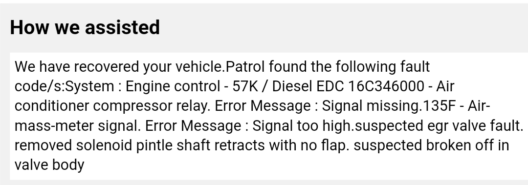

Any ideas?
Thanks
