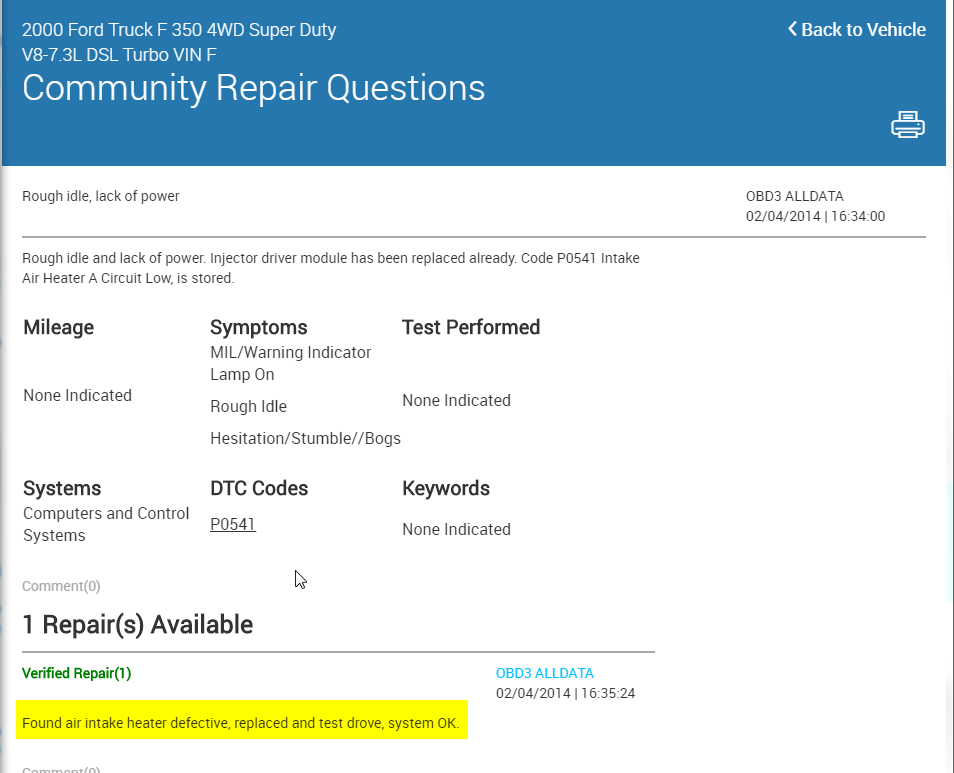

We need to check and see if there are any codes. There a number of things that can cause this but I attached a repair that is pretty common depending on the DTCs. If you don't have a scan tool then most parts stores can pull them free of charge.
This guide will help:
Let me know what you find and we can go from there. Thanks

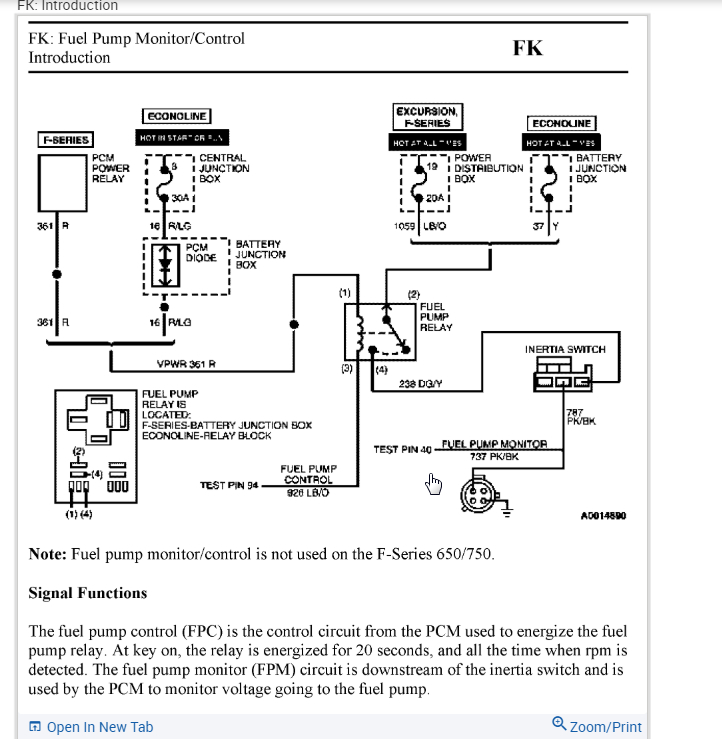

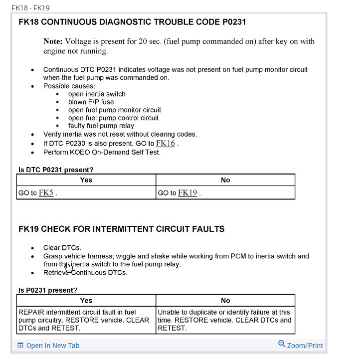

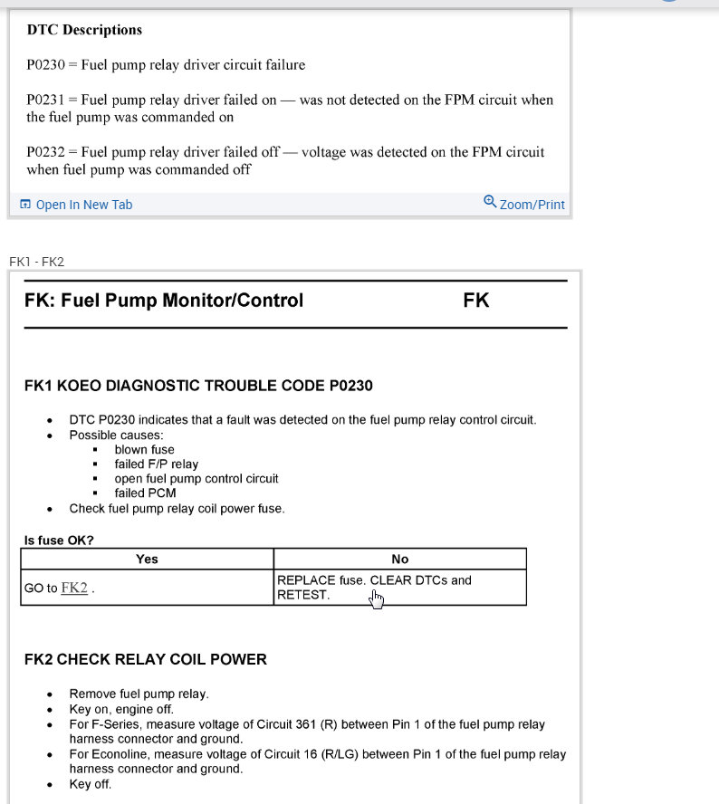

I attached the info for the P0231. Check the inertia switch and make sure it is not tripped. Then run though this diagram and I am sure you will find why it is not starting.
