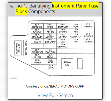

AutoZone put in new battery because old one was past warranty. after new battery, all instrument gauges; gas,speedometer, tachometer and heat were wiped out. not working. Working fine before battery swap.
Jan 30, 2021 at 9:15 AM

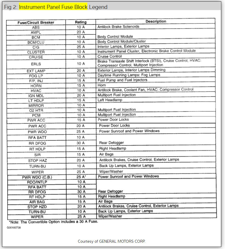

It sounds like you had a voltage spike which happens and blew the instrument cluster fuse. this guide can help us fix it with the fuse location in the diagrams below:
