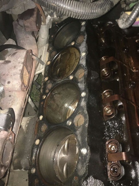

So here is an update we did a short compression test like i mean seconds short cause we saw water coming out of the spark plug ports
youtube.com/watch?v=GhPRAh0zyp8
we removed the head on one side still have to do the other side but look at this engine block and this is after we soaked all the coolant out of all the walls

Nice work, the youtube URL does not work can you double check the address for me please? Can we get more pictures of the engines condition (cylinder walls) this can tell us how much life is left in the engine.

Yeah it turns out the head is cracked right were the valve seats and the gasket its really burnt up bad..
