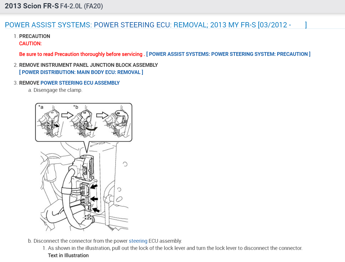

Relay in engine Bay and fuse in footwell is good.

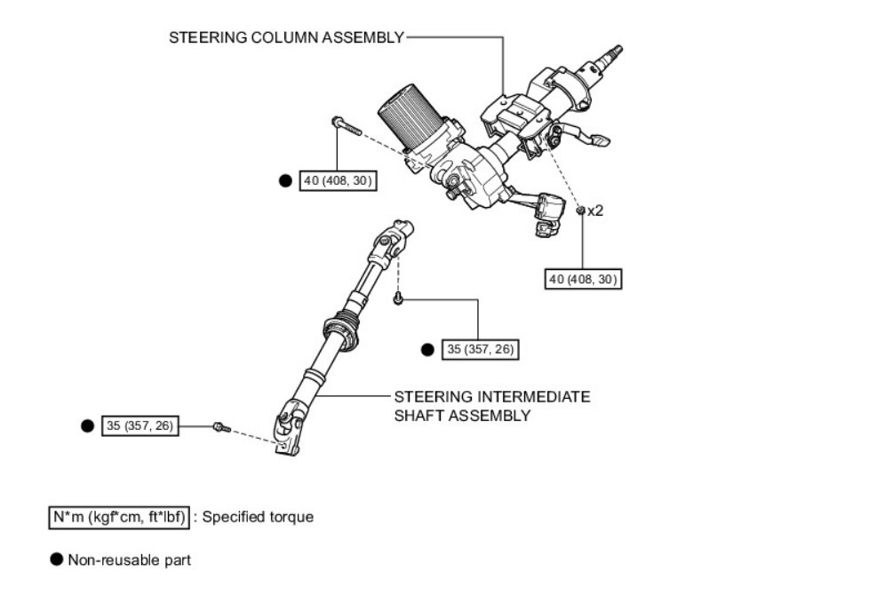

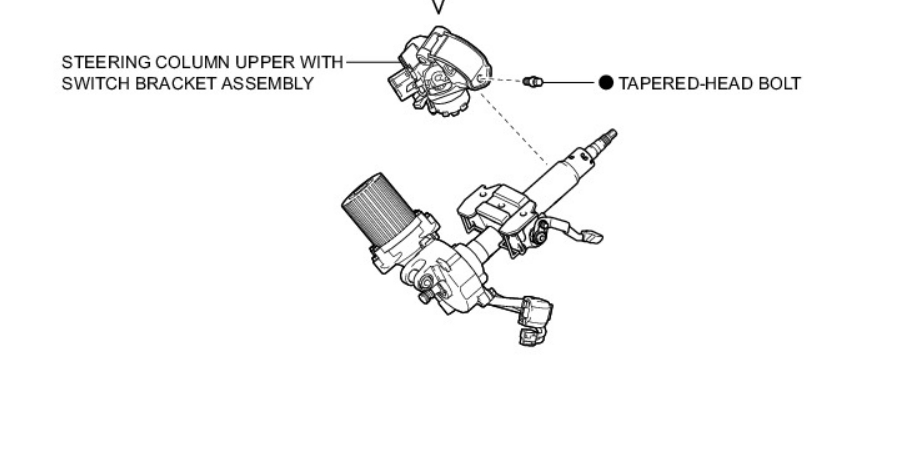

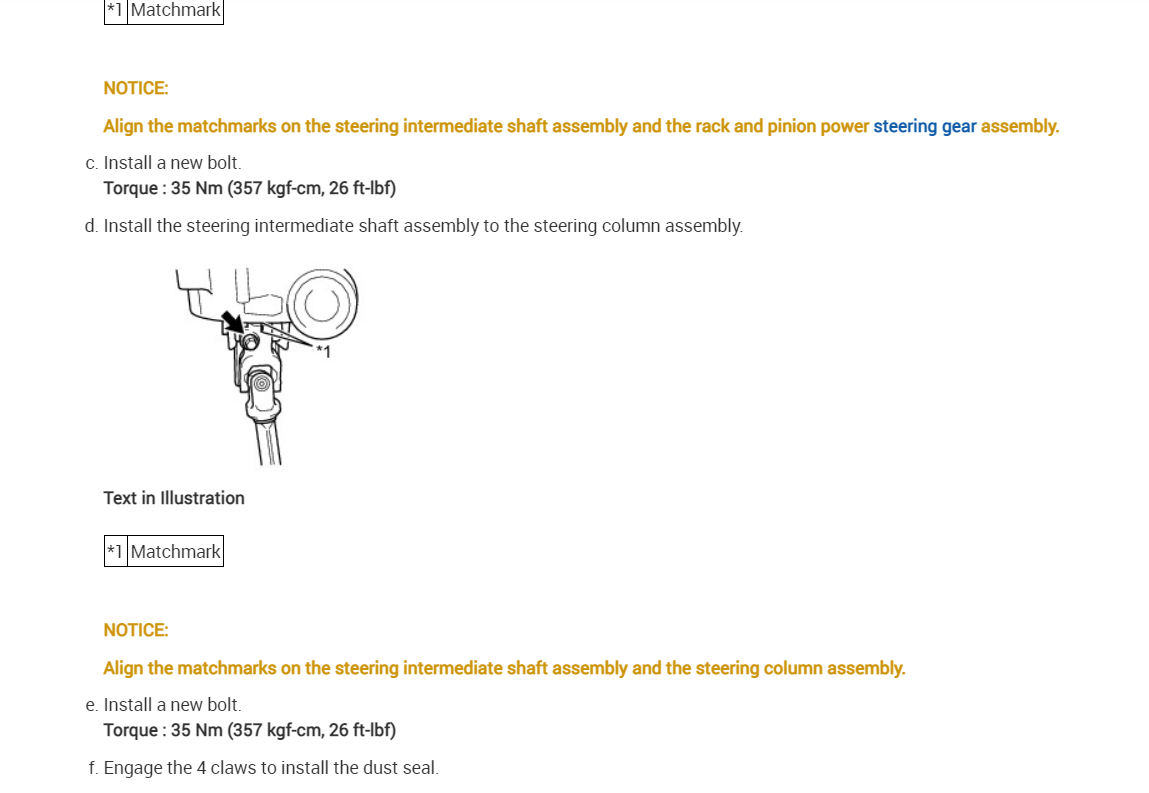

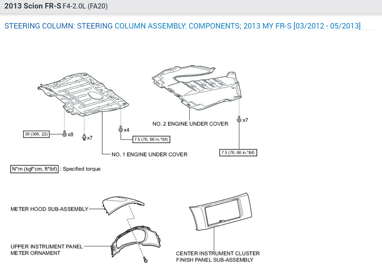

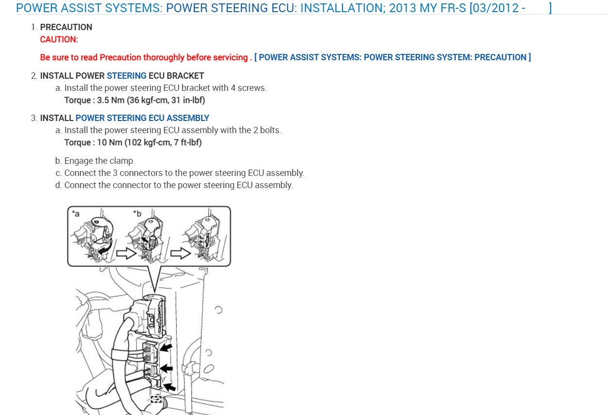

What I've done so far, searched codes using OBD2 Scanner TOPDON AL600, no fault codes found, delete codes (even tho there wasn't any), calibrate Torque Sensor, after turning wheel ok to continue, wheel will vibrate, ok to continue, at this point it doesn't vibrate and I hear 2 clicking sounds like a on and off sound coming underneath the dash, obd2 doesn't want to calibrate due to loss communication. I try to do it again, won't even let me get to the point of turning wheel. I repeat the steps above 5 times and it's consistent and the same.
I couldn't find anything online regarding gt86/frs/brz eps to fix this. Everything I've searched so far was to replace the SAS which the dealership already did.
