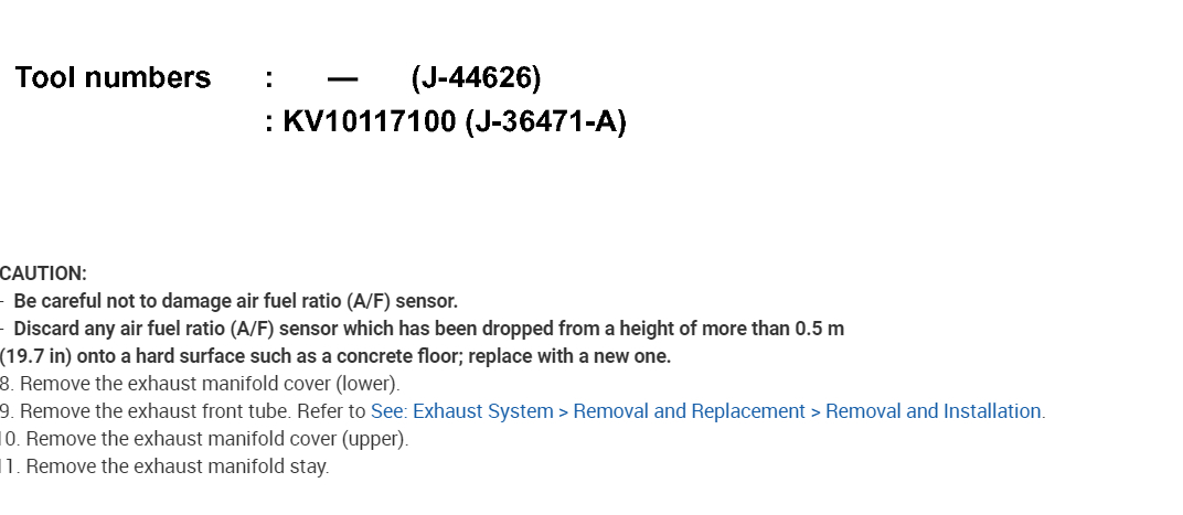

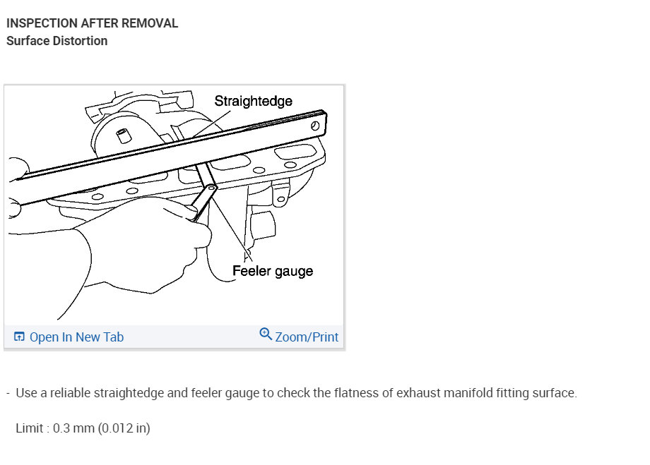

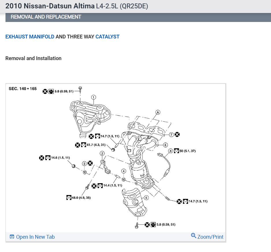

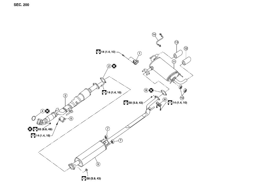

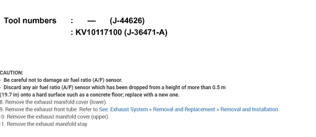

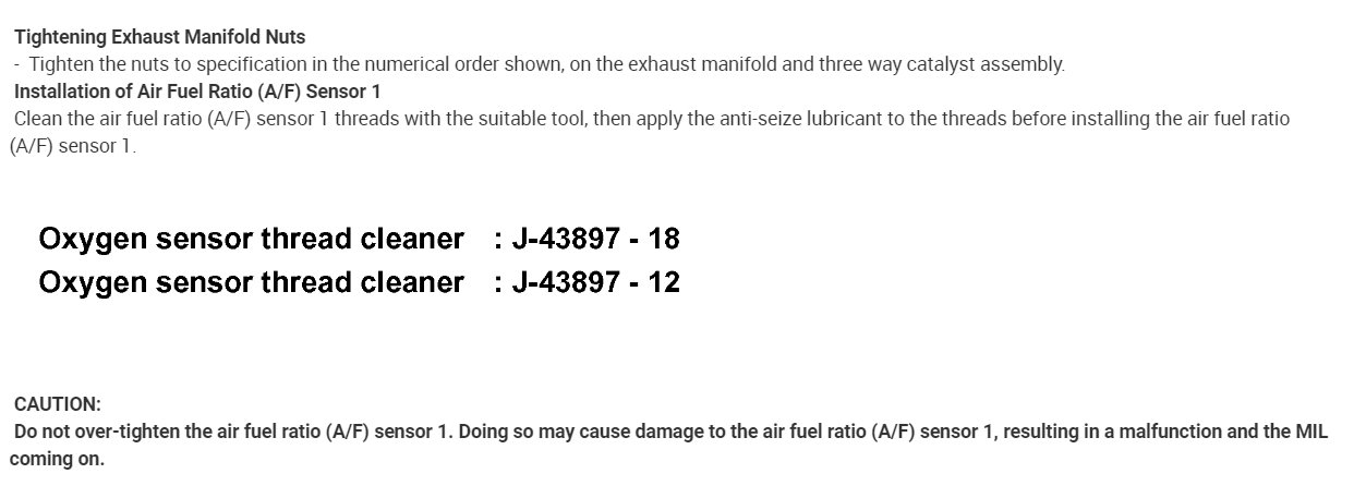

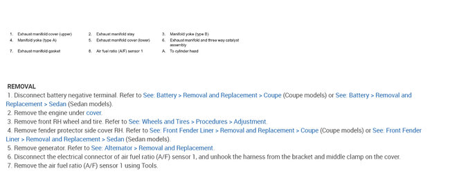

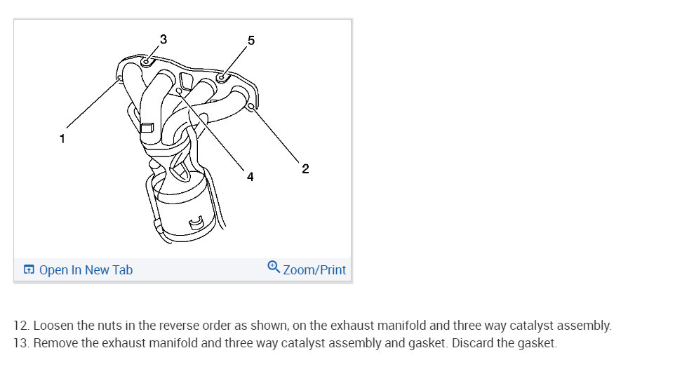

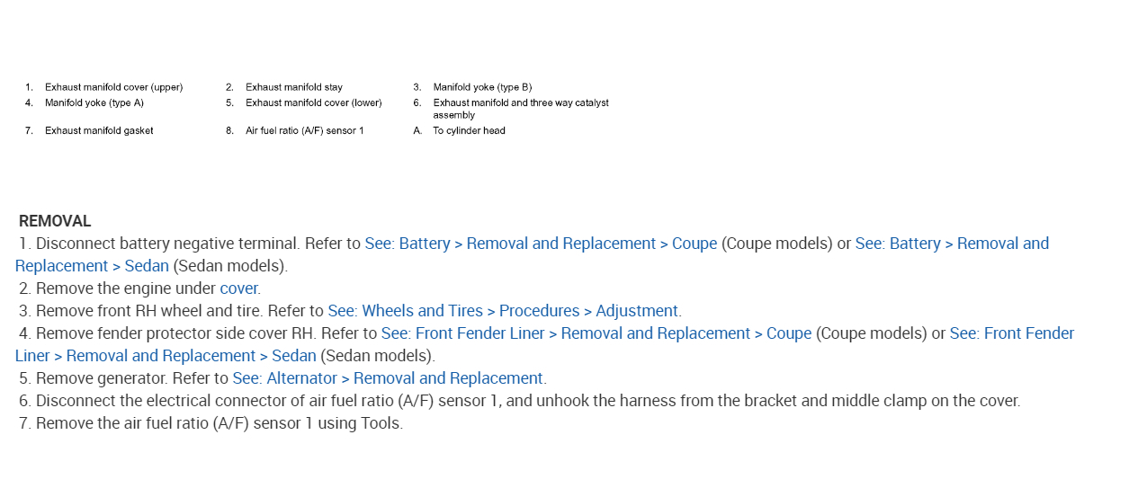

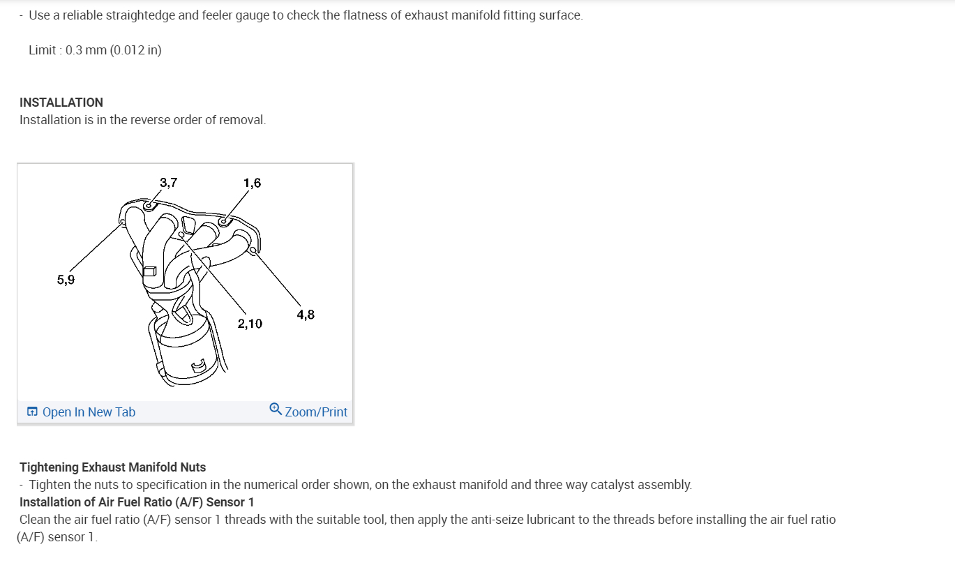

Yep, this happens when the catalytic converter is clogged up. To be sure here is a guide to help confirm the failure and I have included how to change the catalytic converter out in the images below.
If the catalytic converter has fallen apart, you will need to clean the remainder of the exhaust system out including the muffler. Check out the images (below). Let us know what happens and please upload pictures or videos of the problem.
