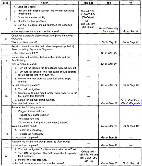

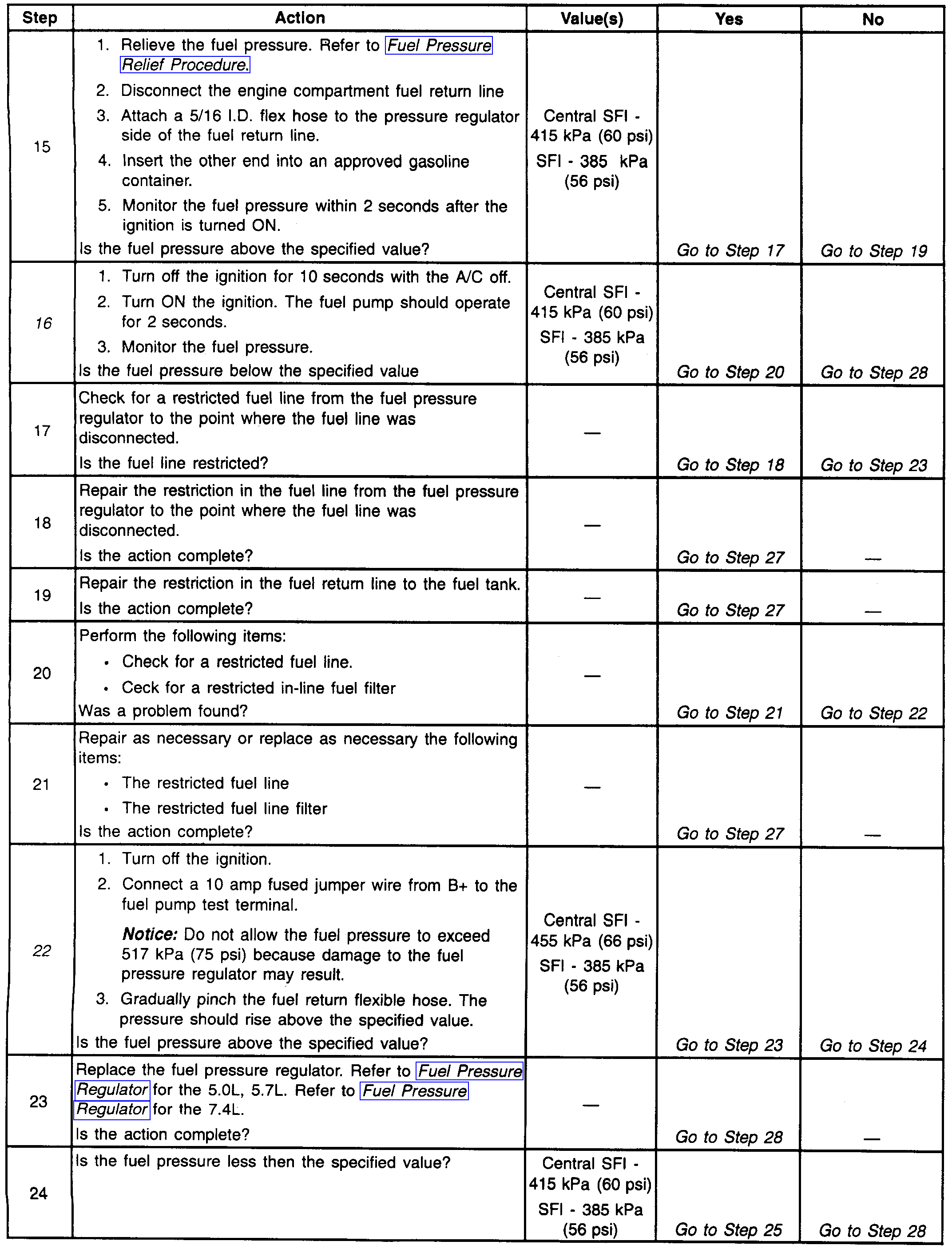

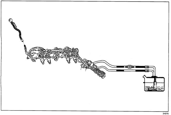

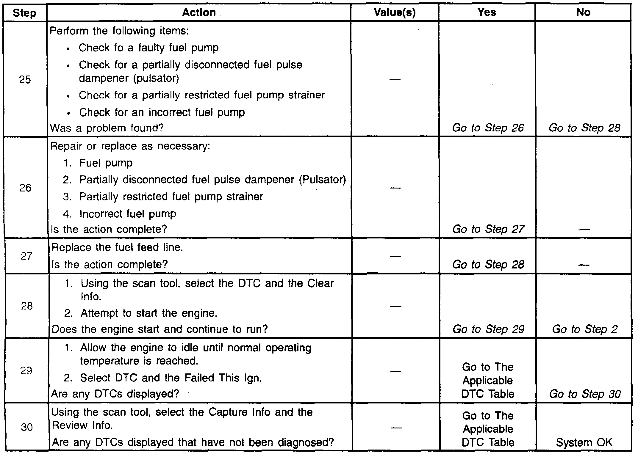

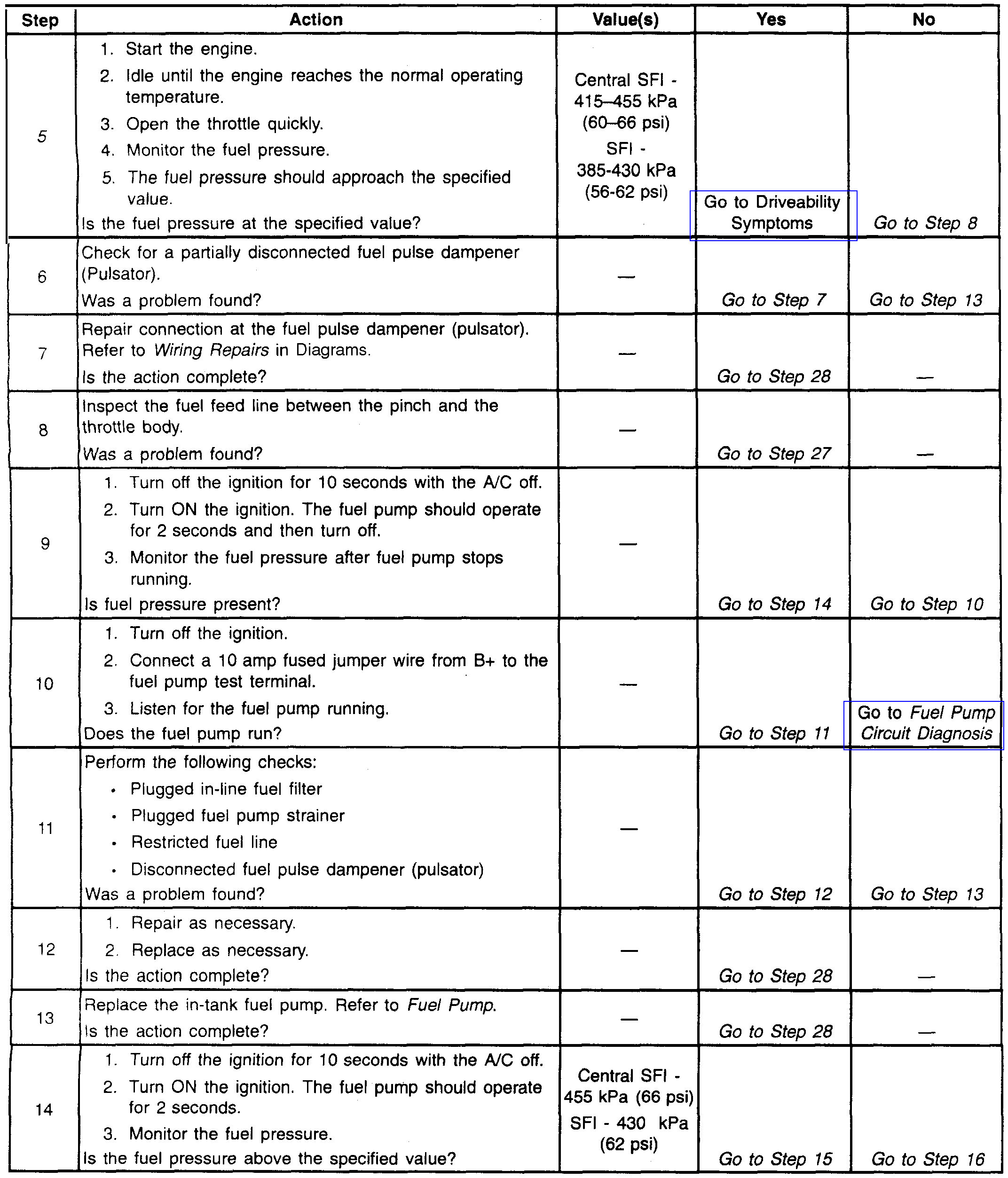

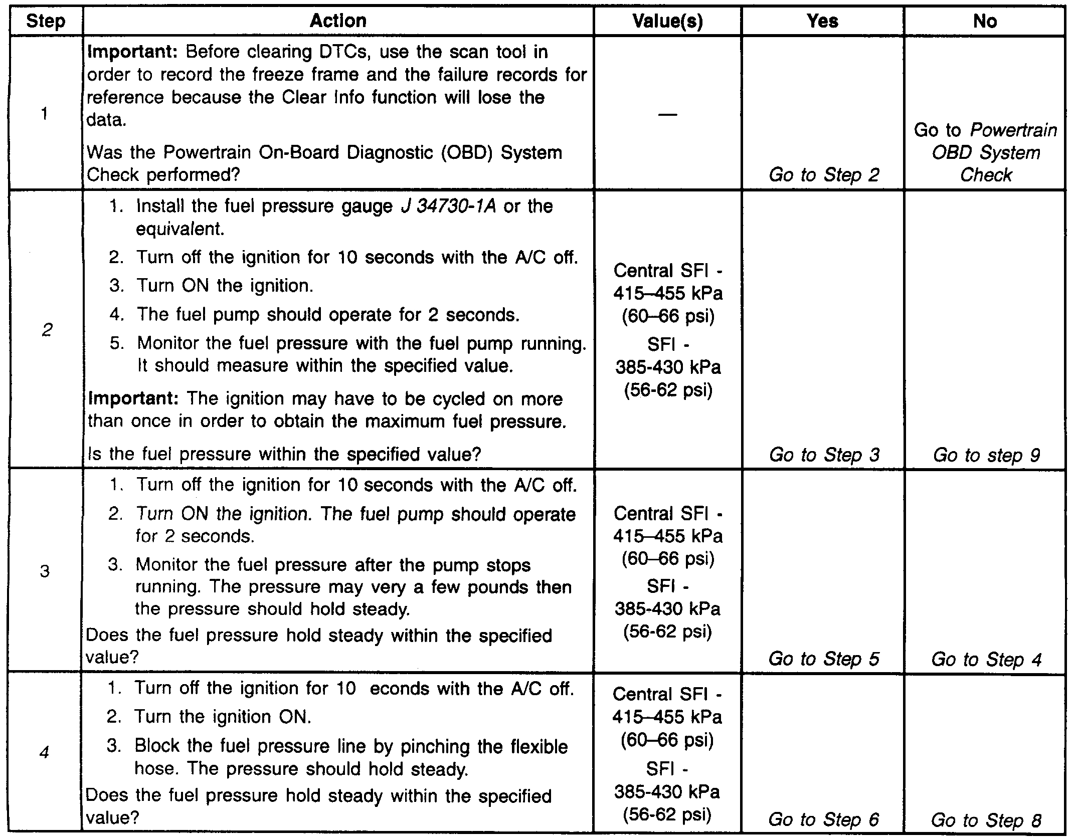

If you look below, I attached 5 pics. The pics are in order and consist of a diagnostic flow chart related to fuel pressure problems. Take a look through them and see if they help.
In my manual, this comes after the flow chart.

22. Restricting the fuel return line allows the fuel pressure to build above regulated pressure. With the battery voltage applied to the fuel pump test terminal, the pressure should rise above 430 kPa (62 psi), as the valve in the return line is partially closed.

Fuel pressure is good at ignition on, but drops like at rock when pump stops running. Step 3 pressure does not hold steady but drops like a rock with key off, so I move to step 4. Pressure holds steady when I pinch flexible hose on return side which is in line with regulator so I move to step 6 to check for partially disconnected fuel pulse dampener, I am thinking that is the FPR, but I am not sure if it is something in the fuel rail.I have removed fuel pump to replace it but there is no check valve in return line in old pump or new pump, so I did not replace pump because I was not sure about that.I will get better pressure reading for you tomorrow, but I believe it is something in fuel rail allowing pressure to leak off, but I am not sure how that pump works to hold pressure when off.

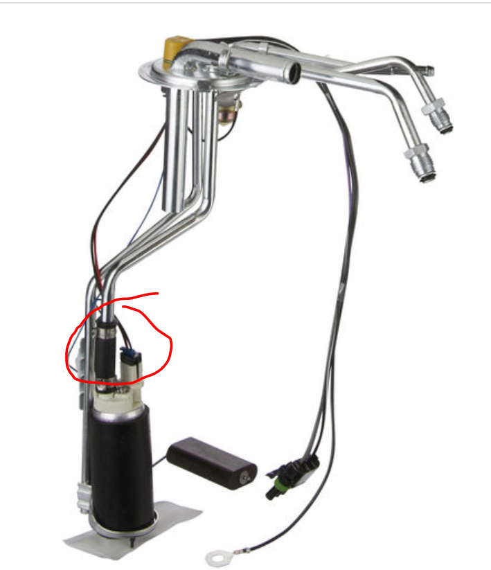

A fuel pulse dampener is designed to maintain a steady pressure to the injectors. When the injectors open and close, it causes a fluctuation in pressure. If that happens without restriction, you won't get an even flow of pressure to each injector. The pulse dampener is the flexible connector between the fuel pump and the metal fuel line in the tank. It can tear or become damaged. However, the result is usually low or no fuel pressure. If it is torn or damaged, it could cause the drop off you described. Also, it can be the cause of low fuel pressure as you described.
I attached a pic below. When you replaced the pump, was that replaced?
