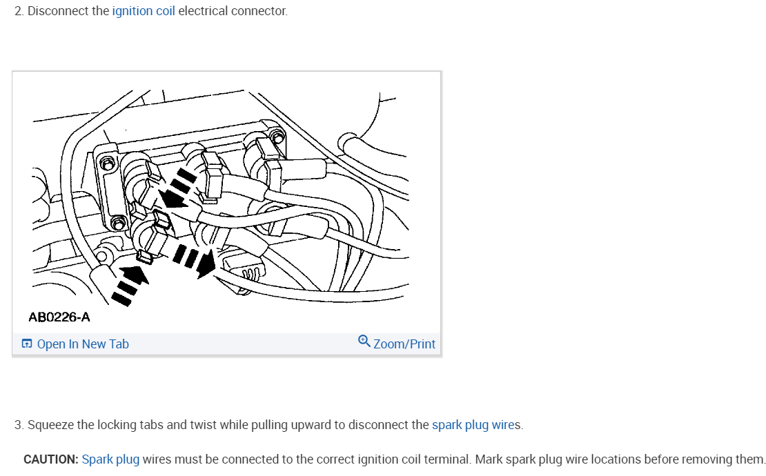

The car sat in a garage for a year without being driven. When I took it out for the first time it ran fine for about 10 miles and then lost power and started to miss and sputter. I changed the oil; spark plugs and fuel filter and filled it up with fresh gas. It will start up just fine and run fine until it gets up to full operating temperature and then it starts running bad again. Error code P0352.
