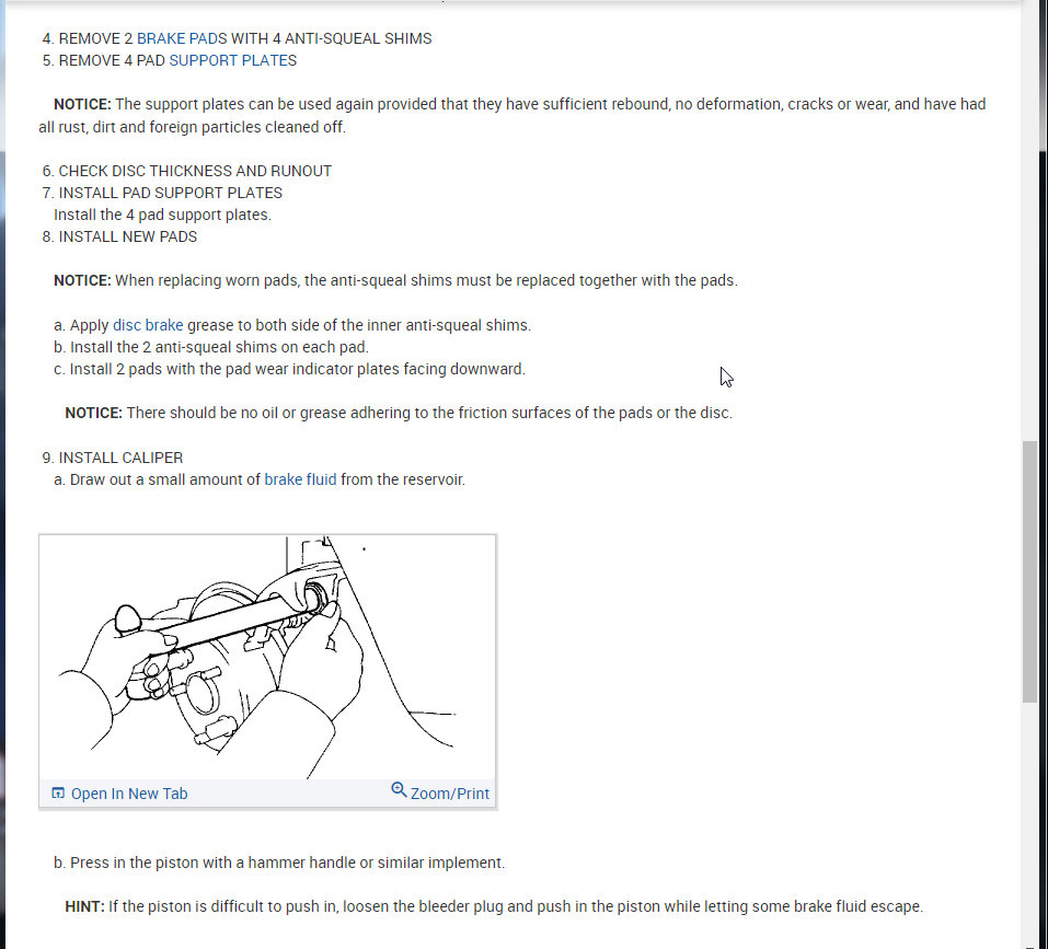

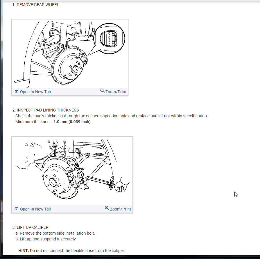

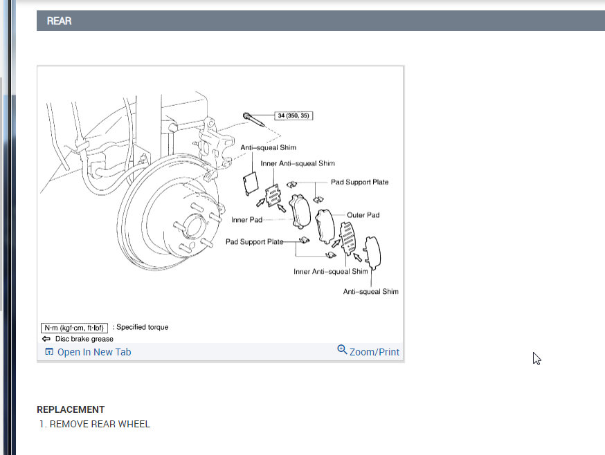

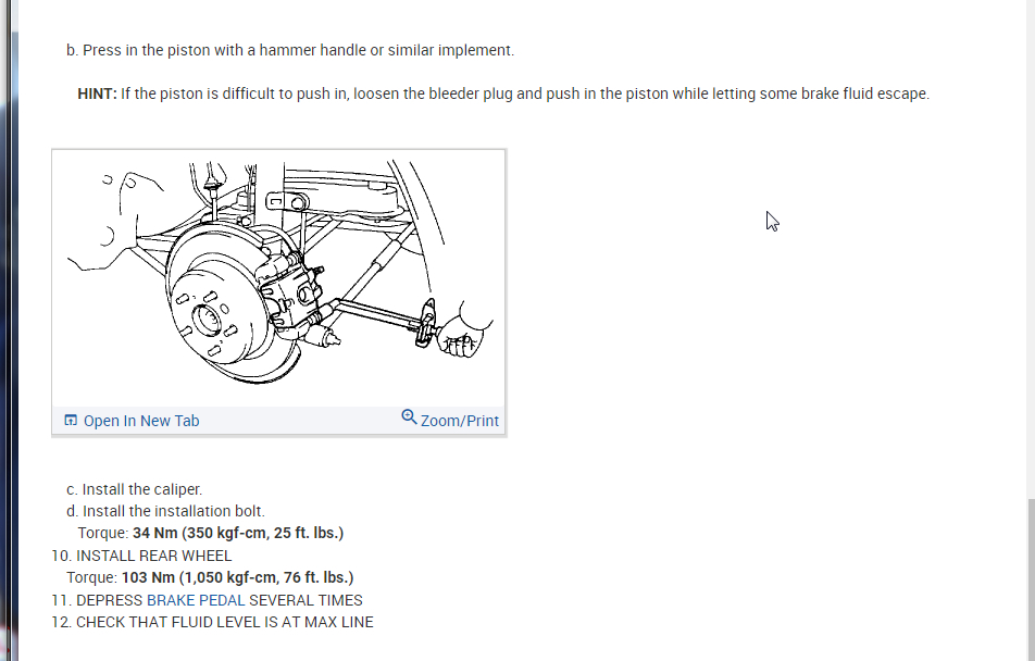

Plus below is the material from the manual of a similar vehicle. We don't offer this vehicle here in the USA so we had to get a similar one to get the process. While this is a different vehicle the process is going to be the same.
Please let us know if you have questions. Thanks
