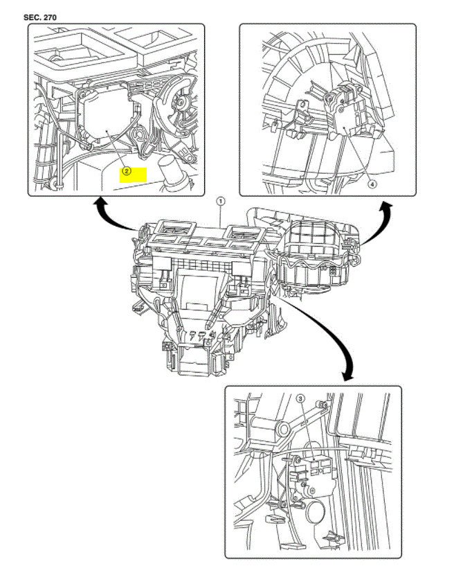

If you look at the picture below, it shows the location of the mode door actuator regardless of whether it has automatic or manual climate control. It will be in the same place.
See pic below.

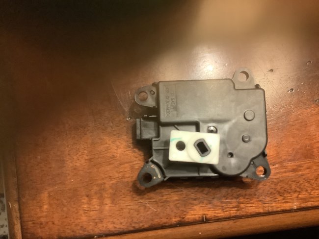

Yes, I see that’s the only one up there. I removed that, and the part number was 277523JC1B which when I looked it up said that was called a bracket air conditioner amplifier. The part number that Nissan gave me for the mode door was 27731-3SBOA, which looks totally different. but it has the same white square on it where it hooks onto the door lever, but it’s a lot smaller than the part I took out. Nissan will not take the part back. I spent hours looking for it and I removed some plastic ducts and there is nothing there, just that part called bracket amplifier. which is about $500.00. I have manual climate control.

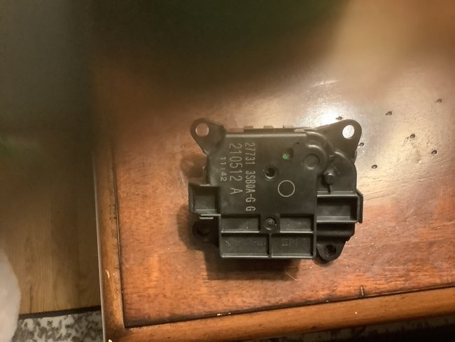

Below is a picture of the mode door actuator they gave me. Joe, the picture you gave me looks like the amplifier which is bigger and flatter the new part I got from the dealer, has the same white square part that will hook up the same way, but I don’t know about the mounting where it hooks up to the case that I never tried because it’s totally different.
Jan 6, 2022 at 3:26 AM

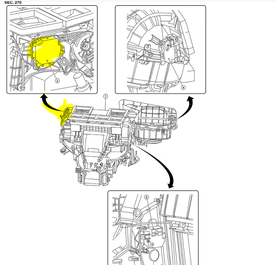

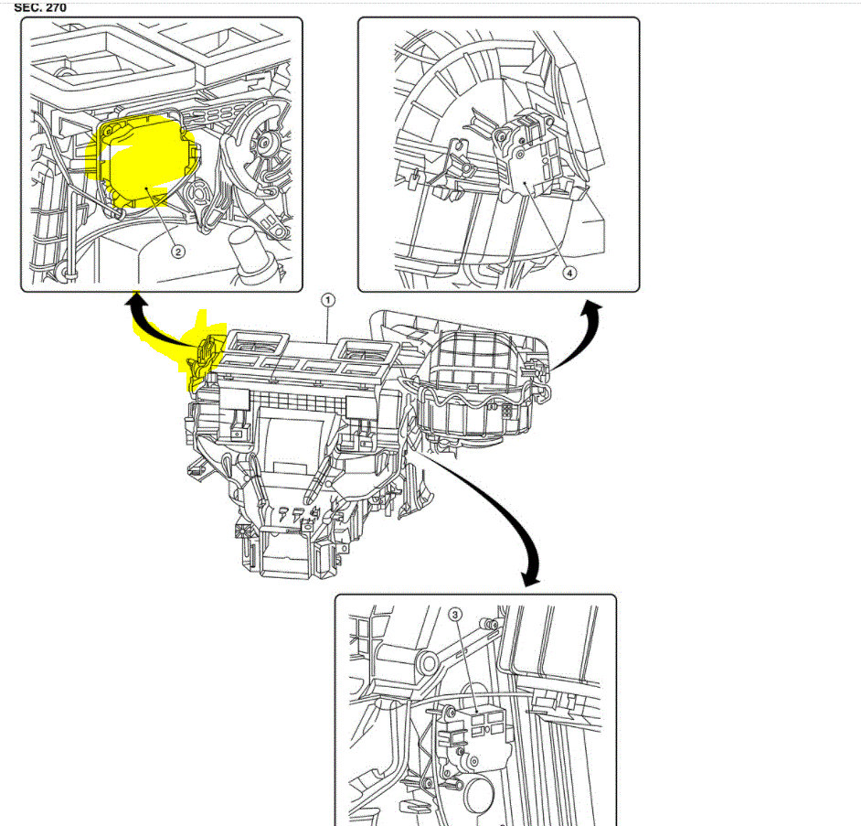

The part number on the actuator you have is for a 2017 like yours. So, I have to say it is correct. The number I provided appears to have been superseded.

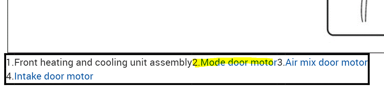

If you look below, I reattached the entire pic of the actuator locations. Additionally, the second pic is the legend for the identified actuators.
Note that number 2 is the mode door. Is that the one you removed?
See pics below.

Hello Joe, thanks for getting back to me. You remember I was looking for the mode actuator. I went to a shop, and he looked it up and told me it’s on the top had to remove top of instrument panel remove the radio and bingo there was where the problem was. the linkage popped off because the mode actuator was bad. I opened it up and the plastic gear was missing a couple of teeth and had a lot of play. installed a new actuator and good to go. thank you for all your help.
