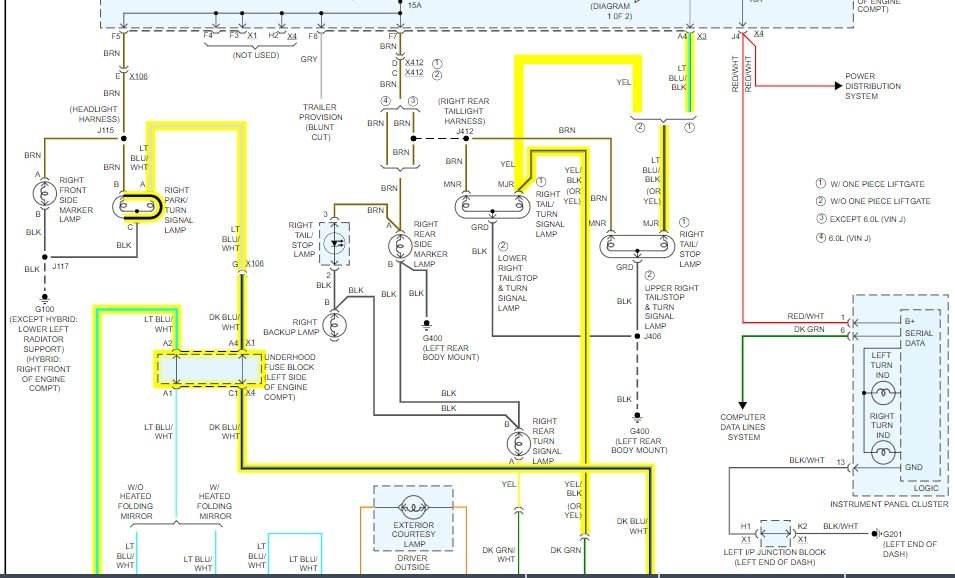

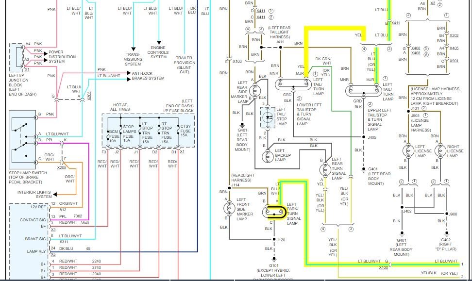

What color are the turn signal wires? I have to add a load resistor after replacing the standard turn signal bulbs with LED units to fix the "fast flashing" issue. I need to know which wire is the one for the left hand and right hand turn signals as the other half of the light is for parking lights.

I attached the wiring diagram for the lights. I highlighted the wires for the turn signals for the front and back.
