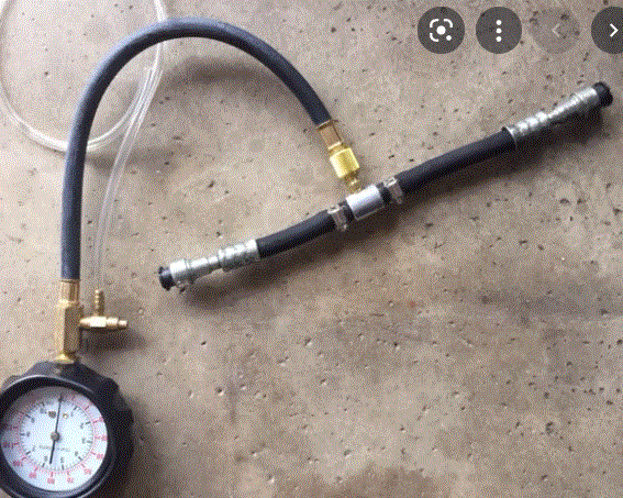

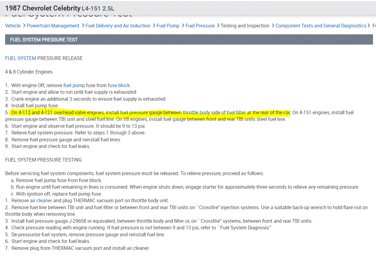

I can hear the fuel pump in gas tank pump up and stop when turn ignition on; I can see visible fuel spray into throttle body when cranking but I can’t say yet if it's a good enough spray pattern. Fuel filter seems to be clean. No outlet valve to check fuel pressure so, have not done so yet.
