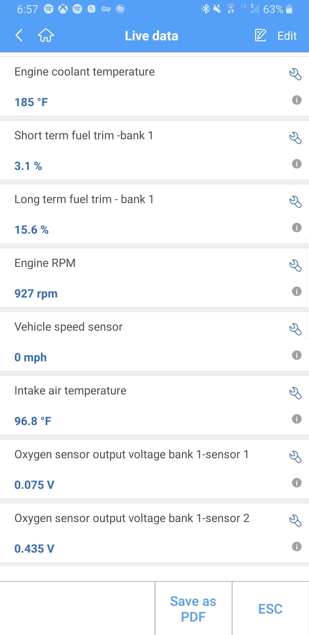

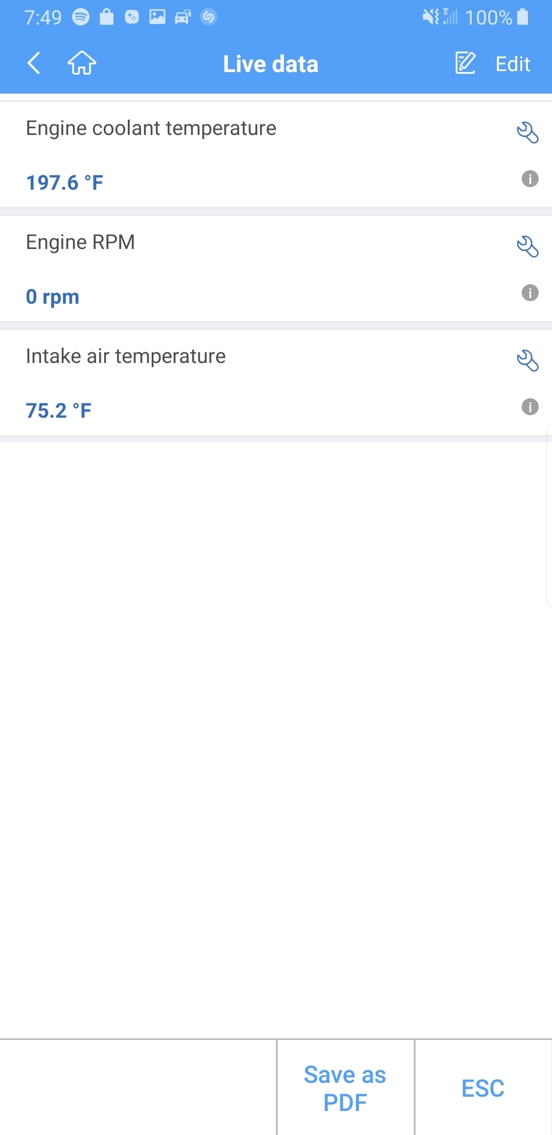

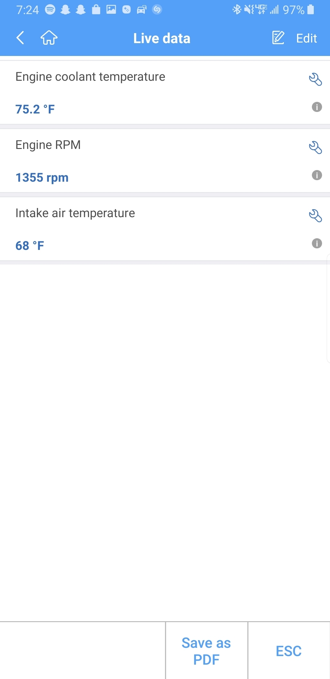

The first thing that comes to mind is that the engine coolant temperature sensor (ECT) is inaccurate. If you have a live data scanner, check the signal from the ECT. Is the temperature it is indicating close to the coolant temp in the engine?
If the sensor is telling the power-train control module it is -40°F and it's actually 80, the PCM will make the fuel mixture extremely rich to allow the engine to run at the cold temp, and basically flood the engine because it isn't actually that cold. And, the opposite can happen causing a mixture that is extremely lean. The idea that you have to press the accelerator leads me to believe it is related because when you depress the accelerator, it shuts fuel down at the injectors.
Let me know if you have a live data scanner and what you find.

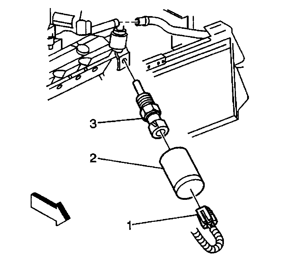

Also, here are the directions for replacing the sensor if you find it is the problem. The attached pic correlates with the directions. Now please keep in mind that the number of miles on the engine may have an affect on engine compression. That too can cause a hard start, especially in cold conditions.

pic 1
REMOVAL PROCEDURE
IMPORTANT: Care must be taken when handling the Engine Coolant Temperature (ECT) sensor. Damage to the sensor will affect the operation of the fuel injection system.
CAUTION: Refer to Battery Disconnect Caution in Service Precautions.
1. Disconnect the negative battery cable.
2. Drain the radiator coolant. Refer to Draining and Filling Cooling System in Cooling System.
3. Disconnect the electrical connector (1) from the ECT sensor (3).
4. Remove the ECT sensor shield (2) from around the sensor.
5. Remove the ECT sensor from the engine.
INSTALLATION PROCEDURE
IMPORTANT: Care must be taken when handling the engine coolant temperature sensor. Damage to the sensor will affect the operation of the fuel injection system.
NOTE: Refer to Component Tightening Notice in Service Precautions.
1. Hand-start the ECT sensor (3) into the engine.
2. Tighten the ECT sensor.
Tighten
Tighten the sensor to 25 N.m (18 lb ft).
3. Install the ECT sensor shield (2) around the ECT sensor.
4. Connect the electrical connector (1) to the ECT sensor (3).
5. Refill the radiator with coolant. Refer to Draining and Filling Cooling System in Cooling System.
6. Connect the negative battery cable.
7. Start the engine.
8. Check for coolant leaks
9. Check the coolant level.
