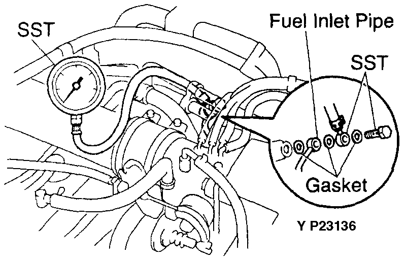

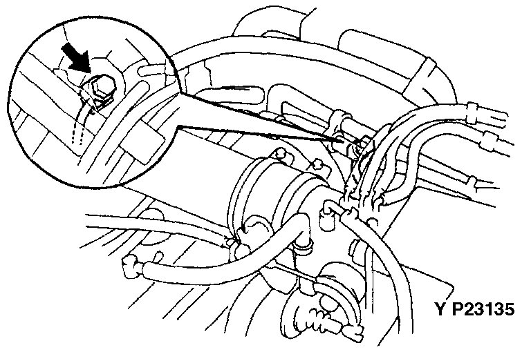

Here are the directions specific to testing fuel pressure on this vehicle. Note that there is no schrader valve to connect the gauge. You need to do it at the fuel line. See the attached pics.
____________________________
1997 Toyota Truck Tacoma Extra Cab 4WD L4-2693cc 2.7L DOHC MFI
Component Tests and General Diagnostics
Vehicle Powertrain Management Fuel Delivery and Air Induction Fuel Pump Fuel Pressure Testing and Inspection Component Tests and General Diagnostics
FUEL PRESSURE INSPECTION
1. INSPECT FUEL PRESSURE
(a)Check that the battery positive voltage is above 12 volts.
(b)Disconnect the negative (-) terminal cable from the battery.
pic 1
(c)Remove the union bolt and 2 gaskets, and disconnect the fuel inlet pipe from the delivery pipe.
HINT:
- Put a suitable container or shop rag under the delivery pipe.
- Slowly loosen the union bolt.
pic 2
(d)Install the fuel inlet pipe and SST (pressure gauge) to the delivery pipe with the 3 gaskets and SST (union bolt).SST 09268-45012
Torque: 29 N.m (300 kgf.cm, 22 ft.lbf)
(e)Wipe off any splattered gasoline.

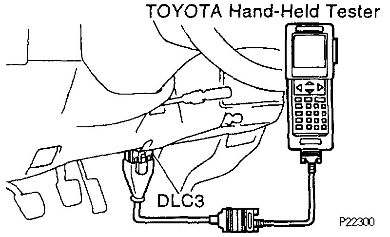

(f)Connect the Toyota hand-held tester to the DLC3.
(g)Turn the ignition switch on and Toyota hand-held tester main switch on.
Notice: Do not start the engine.
(h)Select the active test mode on the Toyota hand-held tester.
(i)Please refer to the Toyota hand - held tester operator 5 manual for further details.
(j)If you have no Toyota hand-held tester, connect the positive (+) and negative (-) leads from the battery to the fuel pump connector.

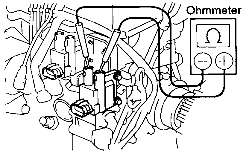

Yes, you can check the coils. Here are the directions. The attached pic correlates with the directions.
_________________
1997 Toyota Truck Tacoma Regular Cab 4WD L4-2693cc 2.7L DOHC MFI
Vehicle Powertrain Management Ignition System Ignition Coil Testing and Inspection Component Tests and General Diagnostics
Component tests and general diagnostics
Ignition coil inspection
1. Disconnect high-tension cords from ignition coils
2. Disconnect ignition coil connectors
pic 1
3. Inspect secondary coil resistance
using an ohmmeter. Measure the resistance between the positive (+) and high-tension terminals.
cold: 9.7 - 16.7 k ohms
hot: 12.4 - 19.6 k ohms
if the resistance is not as specified, replace the ignition coil.
4. Reconnect ignition coil connectors
5. Reconnect high-tension cords from ignition coils
Dec 1, 2020 at 6:53 PM
