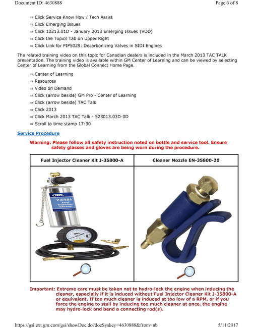

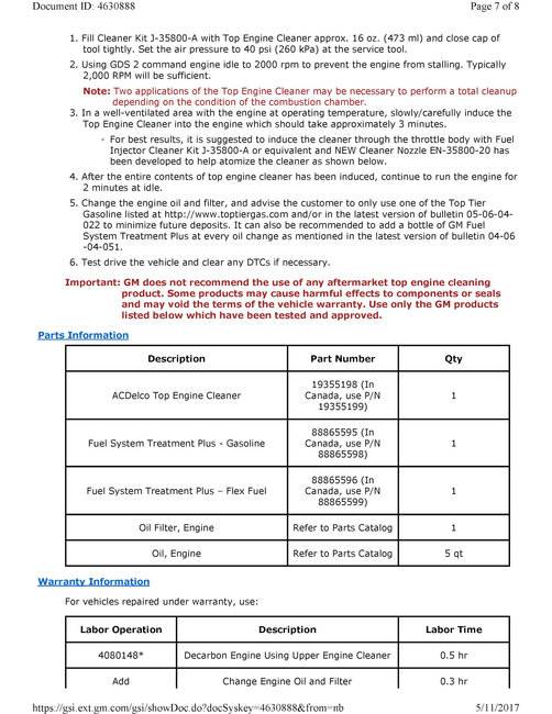

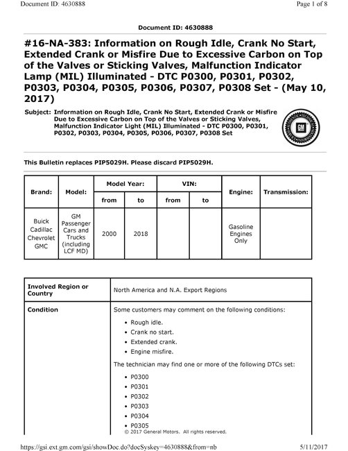

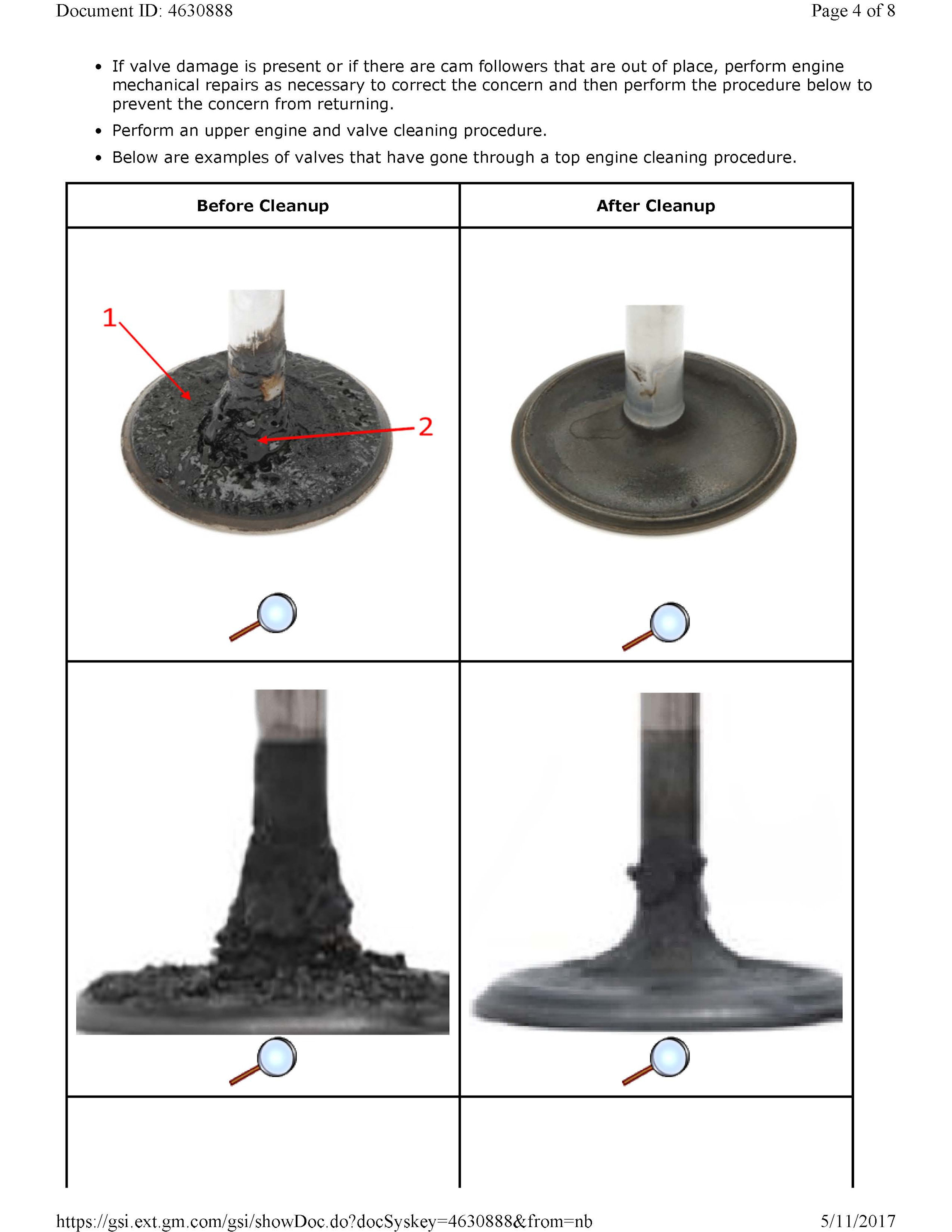

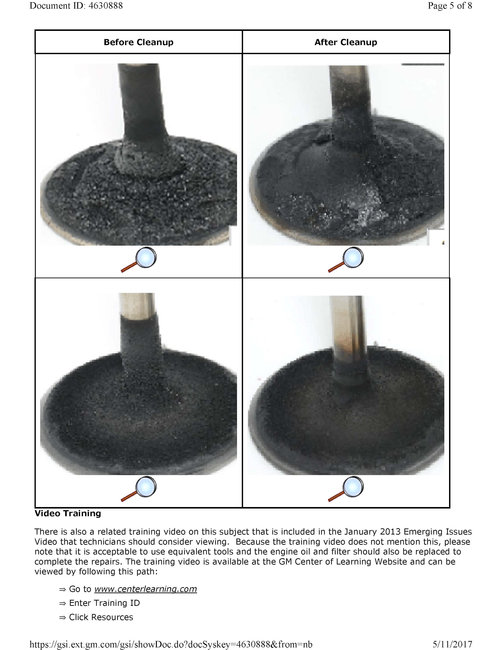

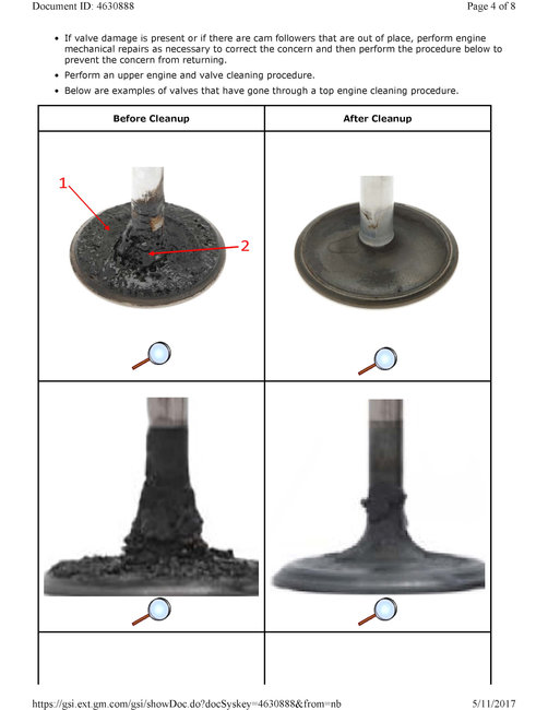

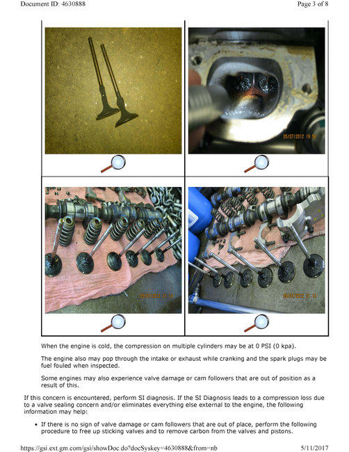

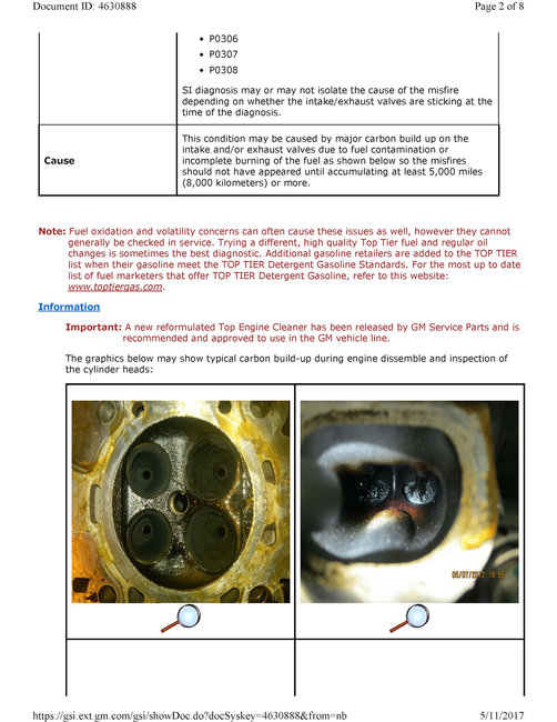

I will tell you there was a technical service bulletin (TSB) related to delayed start. This is not a recall, but was noted as a problem with a resolve. Everything has been attached as pictures due to the way I had to copy it.

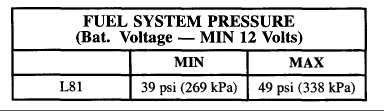

If you decide to check pressure, the last picture is that of the manufacturer's specifications related to the fuel pump.

The last picture listed above is the specs for your vehicle. When you check, make sure to pay attention to pressure drop off. I suspect that is what is happening. When you try to restart it, the pump is taking time to reprime and pressurize the system. When you cycle the key, it primes, then repressurizes. The second time you turn the key most pressure is there but again, the pump repressurizes. Thus it starts right away.
