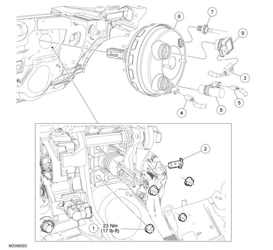

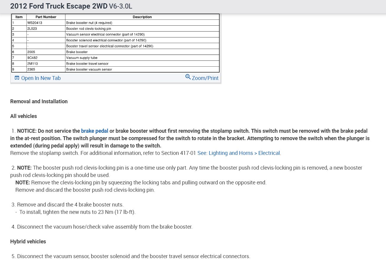

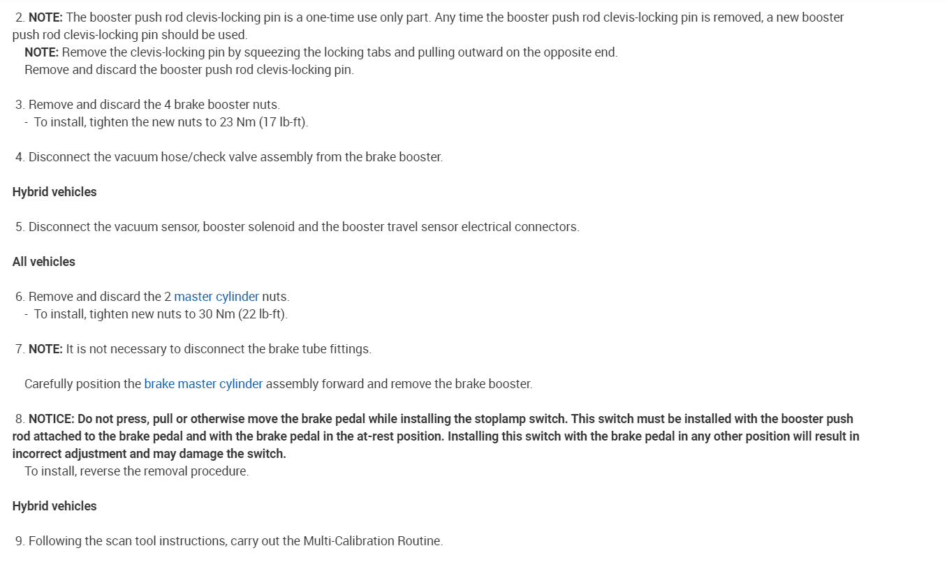

Yep, this happens when the brake booster is going out or the brake master is getting stuck and not returning completely. To see what's going on raise the front of the car up, then loosen the brake master mounting bolts three turns. If the front wheels start turning, remove the master and try adjusting the booster push rod inward two turns and reassemble to see if that works. If not, you will need to replace the booster and brake master. Here is a guide to help raise the car:
And you will need to bleed the brake master before installation.

okay, it sounds like the booster is bad, or on the outside chance the master is sticking and when you loosened the mounting nuts it released.
