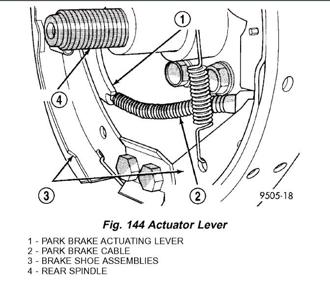

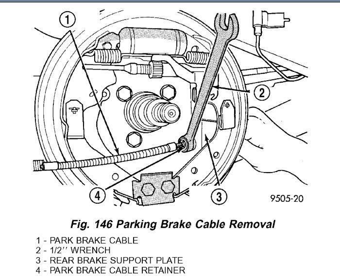

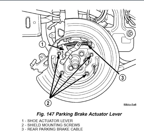

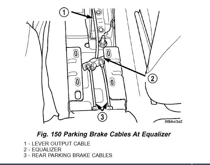

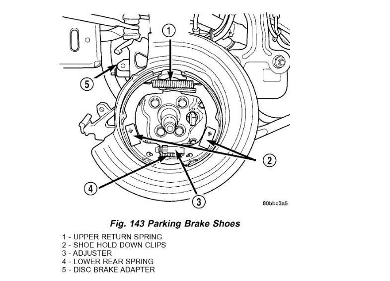

Good afternoon.
This sounds like the brake cable is applying going over all the bumps. The cable is most likely corroded up inside and needs to be replaced.

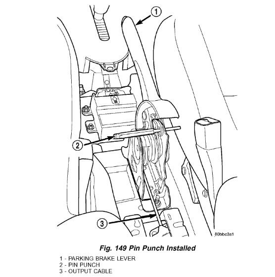

5. Grasp the parking brake lever output cable by hand and pull upward. Continue pulling on the cable until a pin punch can be inserted through the hole in the lever mechanism sector gear and the hole in the right side of its mounting bracket (Fig. 149). This will lock the parking brake automatic adjustment mechanism in place and take tension off the parking brake cables.
6. Remove both rear parking brake cables from the parking brake cable equalizer (Fig. 150).

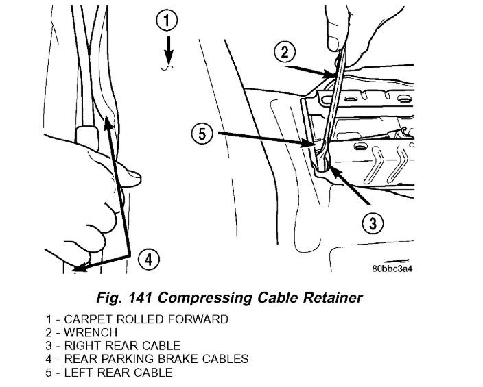

9. Install the box end of a 1/2 inch wrench over the parking brake cable retainer (Fig. 141). Push the wrench onto the retainer until the retainer fingers are collapsed. From under the carpeting, grasp the parking brake cable housing and pull cable straight out of the bracket attached to the floor.

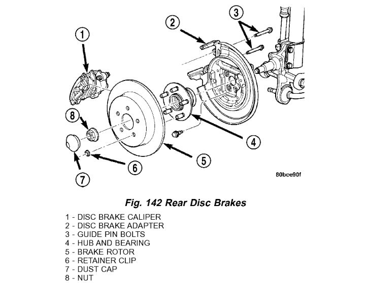

13. On vehicles equipped with rear disc brakes:
Remove the disc brake caliper guide pin bolts, then the caliper from disc brake adapter (Fig. 142).
Hang the caliper out of the way using a wire hanger or cord.
Remove the brake rotor from the rear hub and bearing.
14. Remove the dust cap from the rear hub and bearing.
15. Remove the hub and bearing retaining nut from the knuckle spindle, then remove the hub and bearing (Fig. 142).
16. On vehicles equipped with rear disc brakes, remove the upper return spring, both shoe hold-down clips, then spread the rear parking brake shoes apart at the top enough to clear the shoe anchor and remove the parking brake shoes as an assembly from the disc brake adapter (Fig. 143).
17. To remove the rear parking brake cable from the brake support plate on vehicles equipped with rear drum brakes:

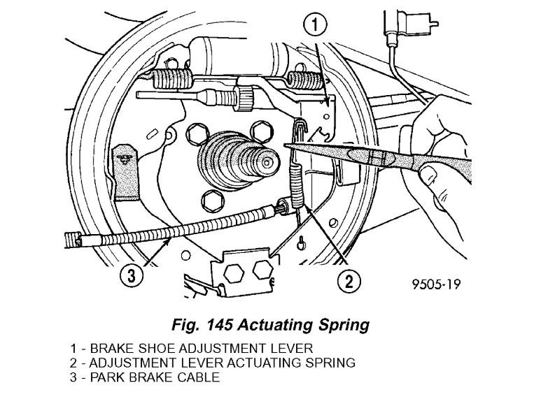

Remove the parking brake cable from the parking brake actuating lever (Fig. 144).
Remove the actuating spring between the brake shoe adjustment lever and the brake shoe (Fig. 145).
Remove the parking brake cable from the rear brake support plate. The parking brake cable can be removed from brake support plate using a 1/2 inch box wrench to compress the locking fingers on the parking brake cable retainer (Fig. 146).
18. To remove the rear parking brake cable from the disc brake adapter on vehicles equipped with rear disc brakes:

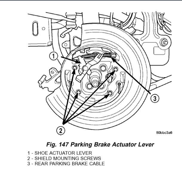

Remove the parking brake actuating lever from the parking brake cable (Fig. 147).

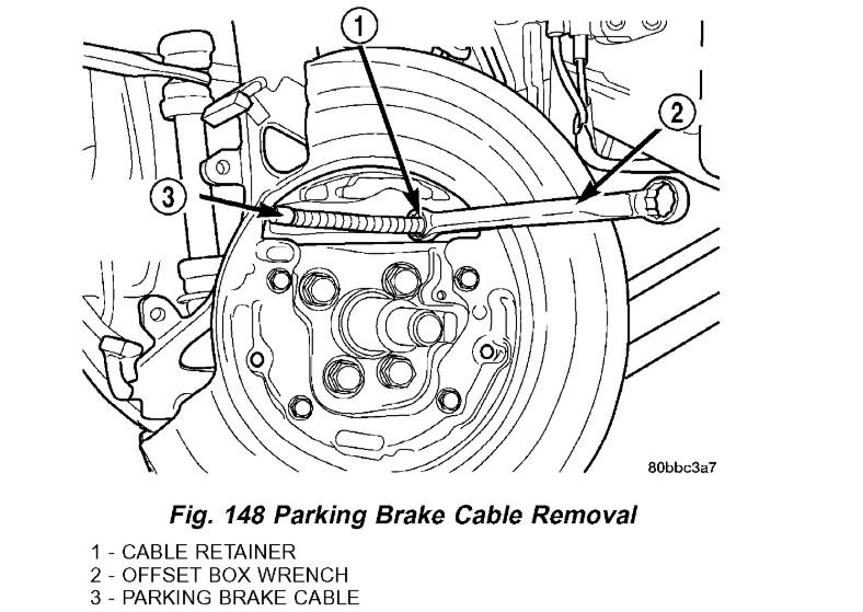

Remove the parking brake cable from the rear disc brake adapter. The parking brake cable can be removed from the disc brake adapter using a 1/2 inch offset box wrench to compress the locking fingers on the parking brake cable retainer (Fig. 148).
