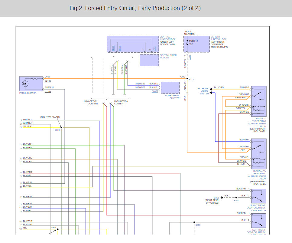

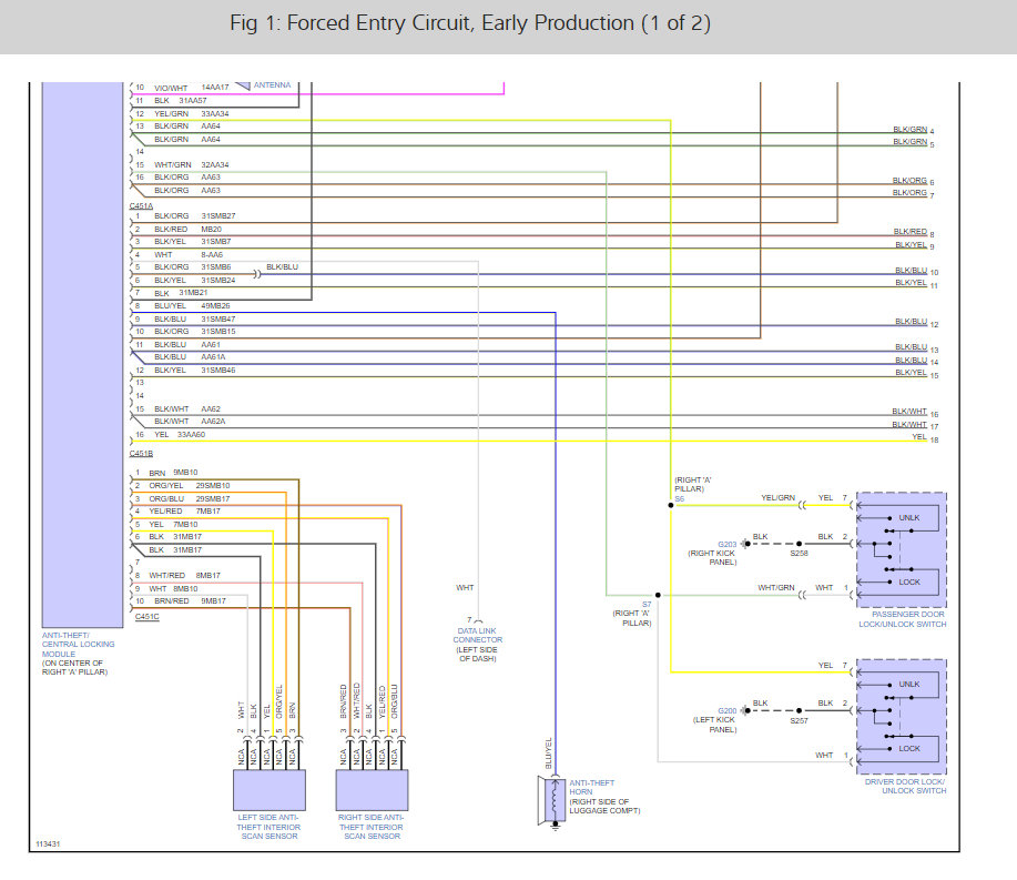

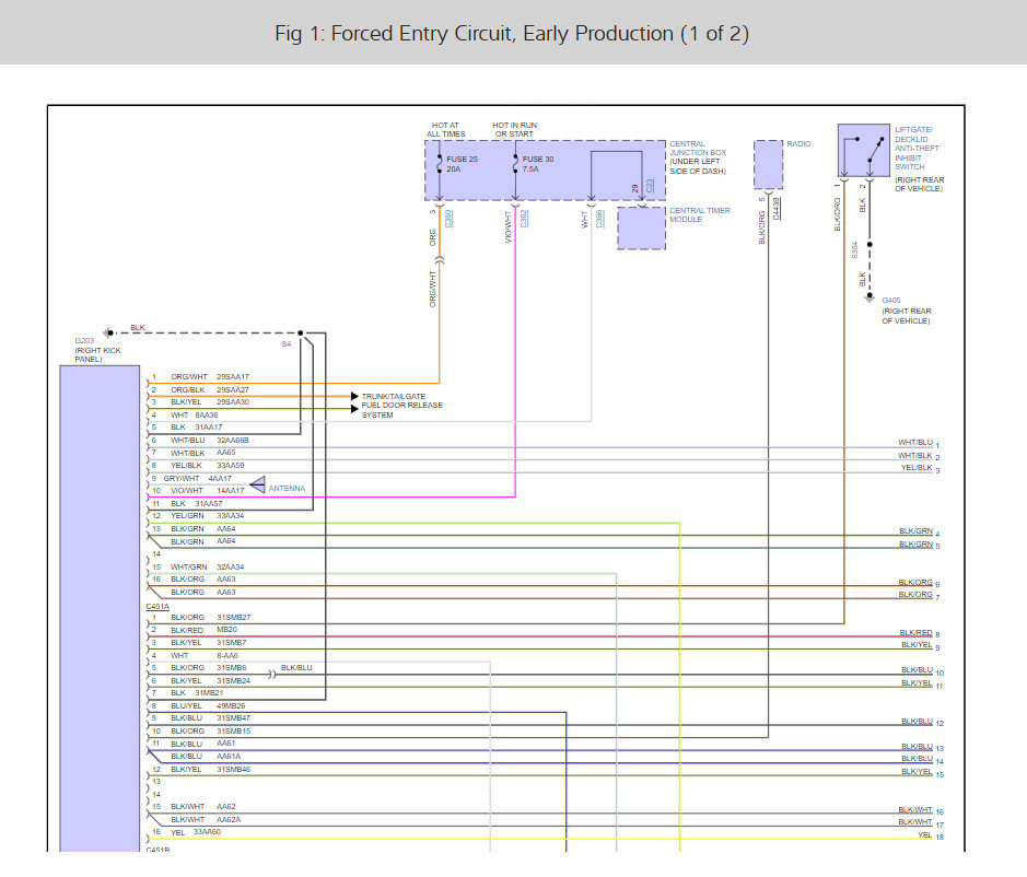

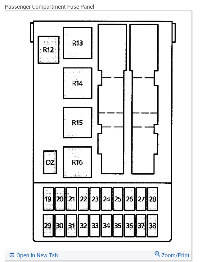

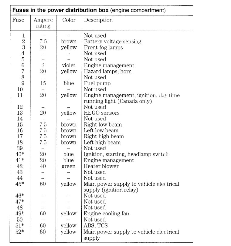

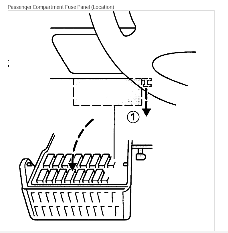

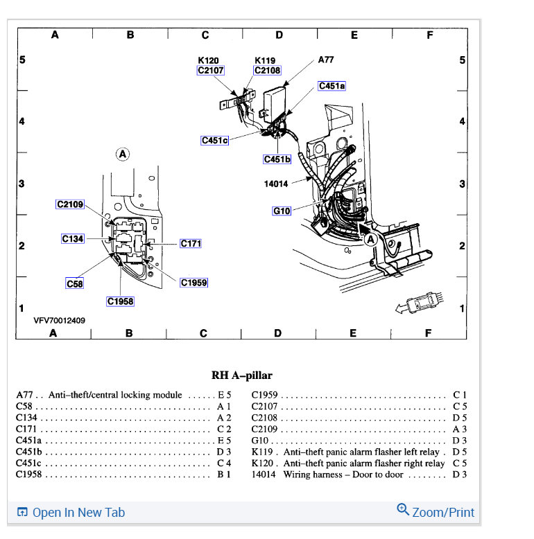

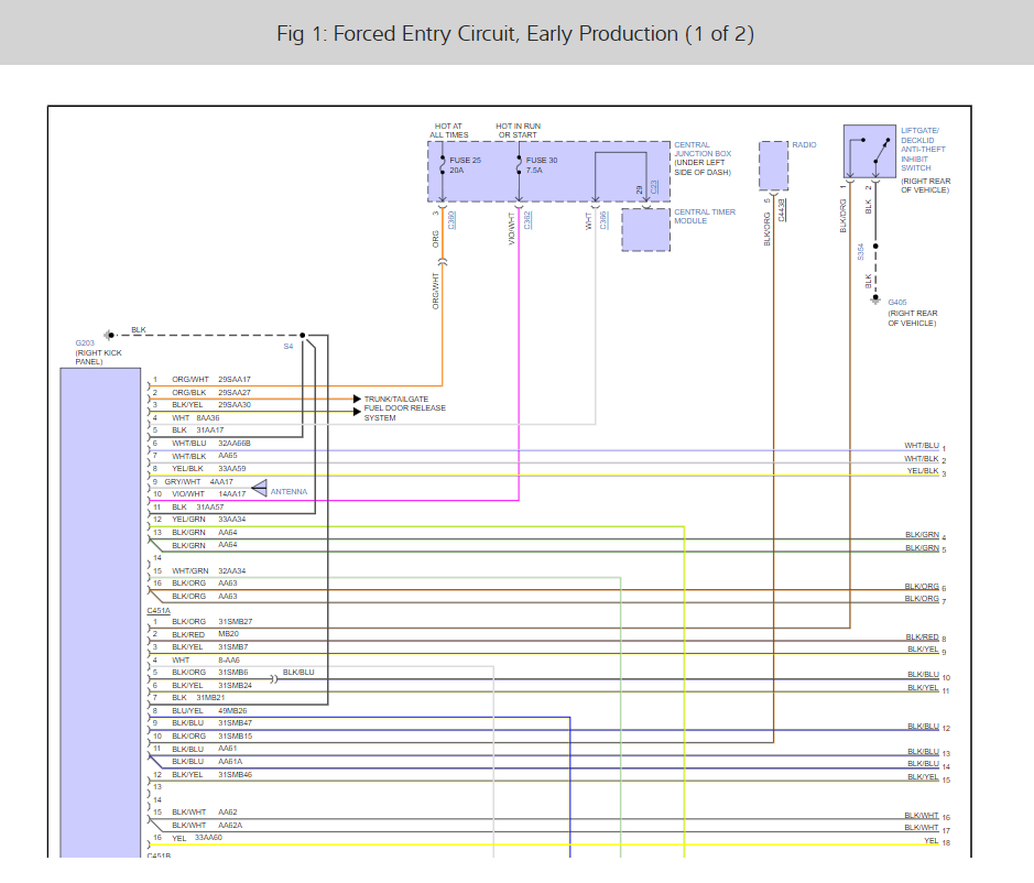

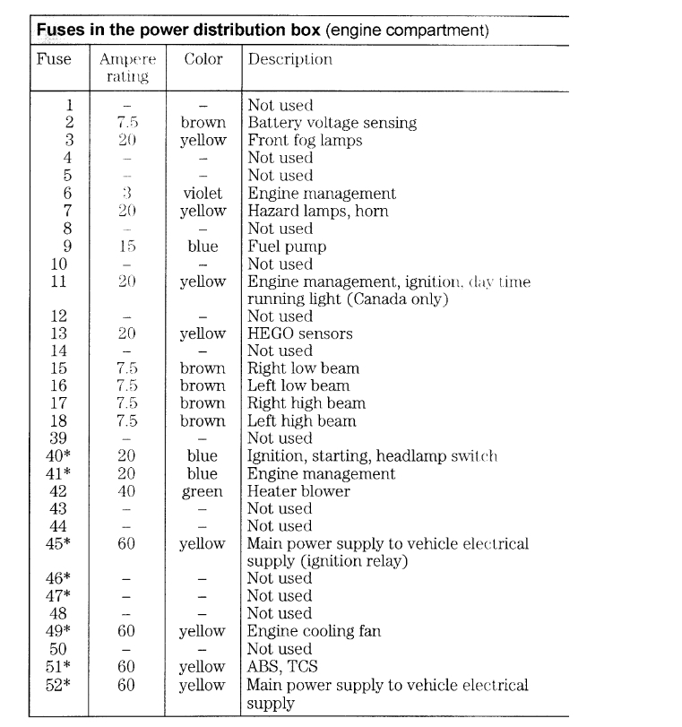

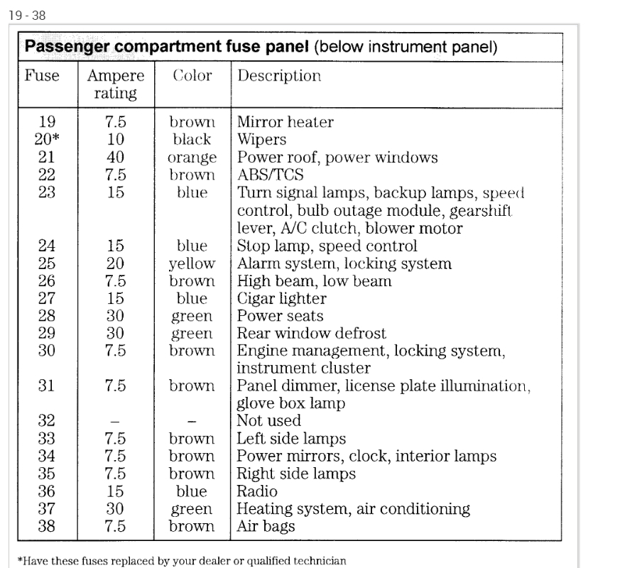

Yep, this is a factory alarm system for sure. There are three fuses #12 (under-hood) #25 and 30 (left side of dash) that run the system which need to be checked here is a guide that will help you and I have included the alarm system wiring diagrams below so you can see how the system works.

I went down to the car and checked all the fuses, they were okay.

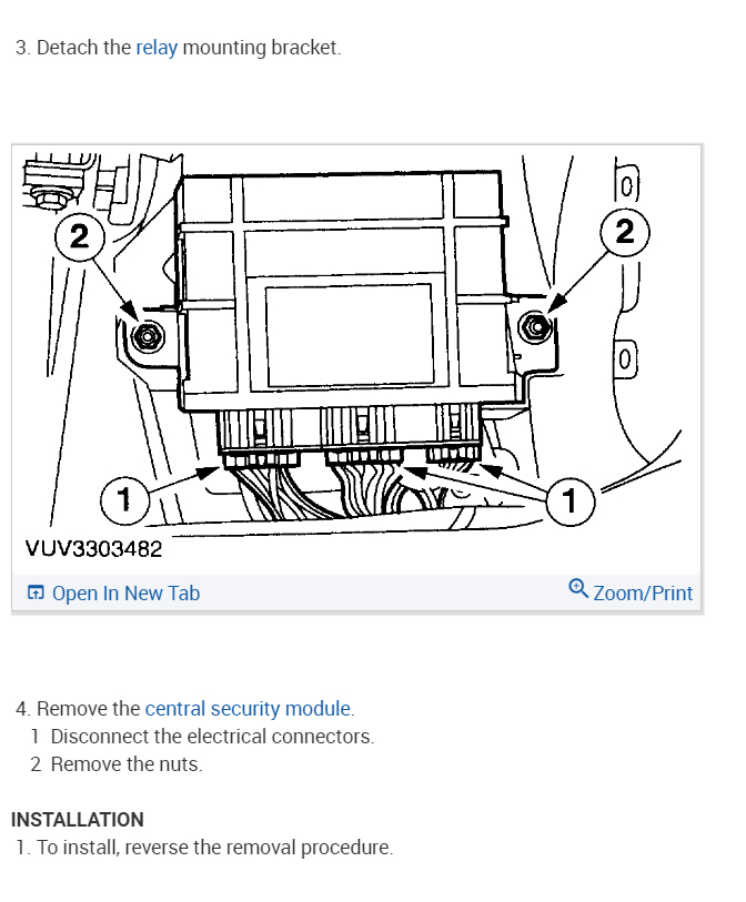

It does sound like the alarm control module is going out, but I think we should check the electrical connector at the module to check for water damage or corrosion. Also, a CAN scan might be able to help give us a clue. You can get a CAN scanner from Amazon for about $30.00. here is a video to show you how:
https://youtu.be/u-4syLc-ifQ
Here is the location of the alarm module so you can check it out and report back. Also, we can try to reprogram the fob here is how.

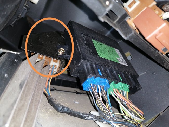

Me again. I've just made some tests and checks again, maybe you will get some further instruction.
I read on the internet that pressing hood switch 7 times is entering in self-test mode and then critical points can be checked (with a result of flash and beep if are okay).
I made this test on all points - Hood switch, trunk key, trunk lifting, left and right door with key, with fob, ignition with key and they were giving okay signal.
Then tried to reprogram the key fob (as the procedure described (4 times on within 3 seconds, than press one fob button - locking, the LED blinked okay).

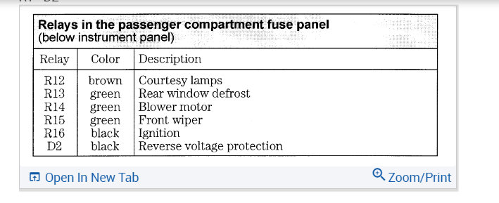

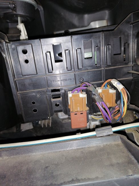

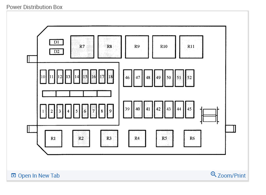

After that removed the glove box to see the module (shown in picture 1) and noticed there are two relays behind the module (probably those for turn blinkers) and removed both to test on 12 volts and making contact. Both were okay.
In front of the module (shown on picture 2) there are another two relays (don't know their role) where the one of them was missing (don't know why). I tried to mount a spare relay on the socket (in hope of solving the problem - but not).
The final (new) thing I have noticed was that if I press the lock key on fob, doors get locked and if pressed second time, it makes a click (like trying to lock) and blinkers flash two times (without beep).
Thanks for your time, patience, and any further instructions.

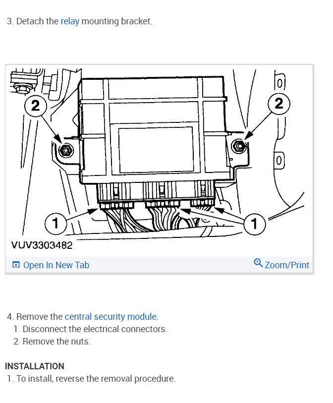

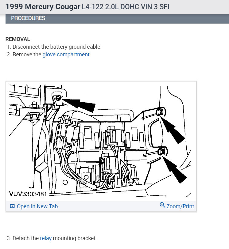

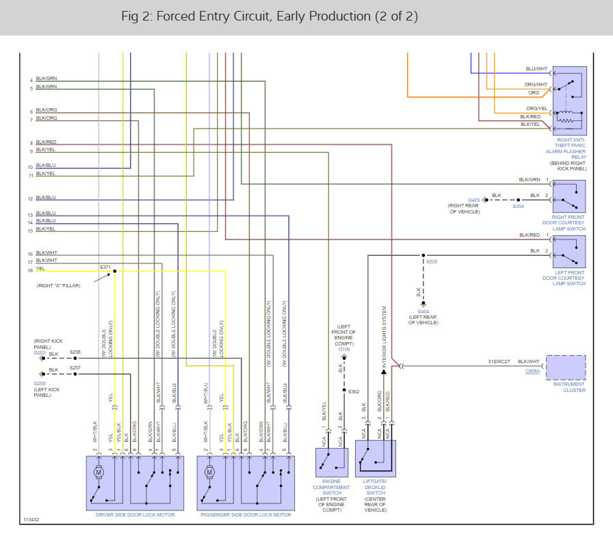

I would have to say the alarm module must be bad. here is how to replace it in the diagrams below. New keys will need to be made. You can also check the module for water damage. Check out the diagrams (below). Please let us know what happens.

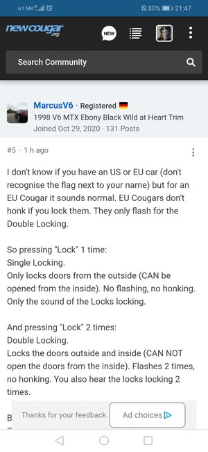

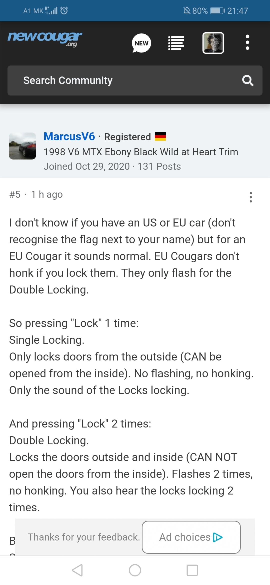

As this person explained me, actually there is no problem present, it is factory setting.
Jul 24, 2022 at 12:50 PM
That makes sense each system is a little different. Please use 2CarPros anytime we are here to help.
