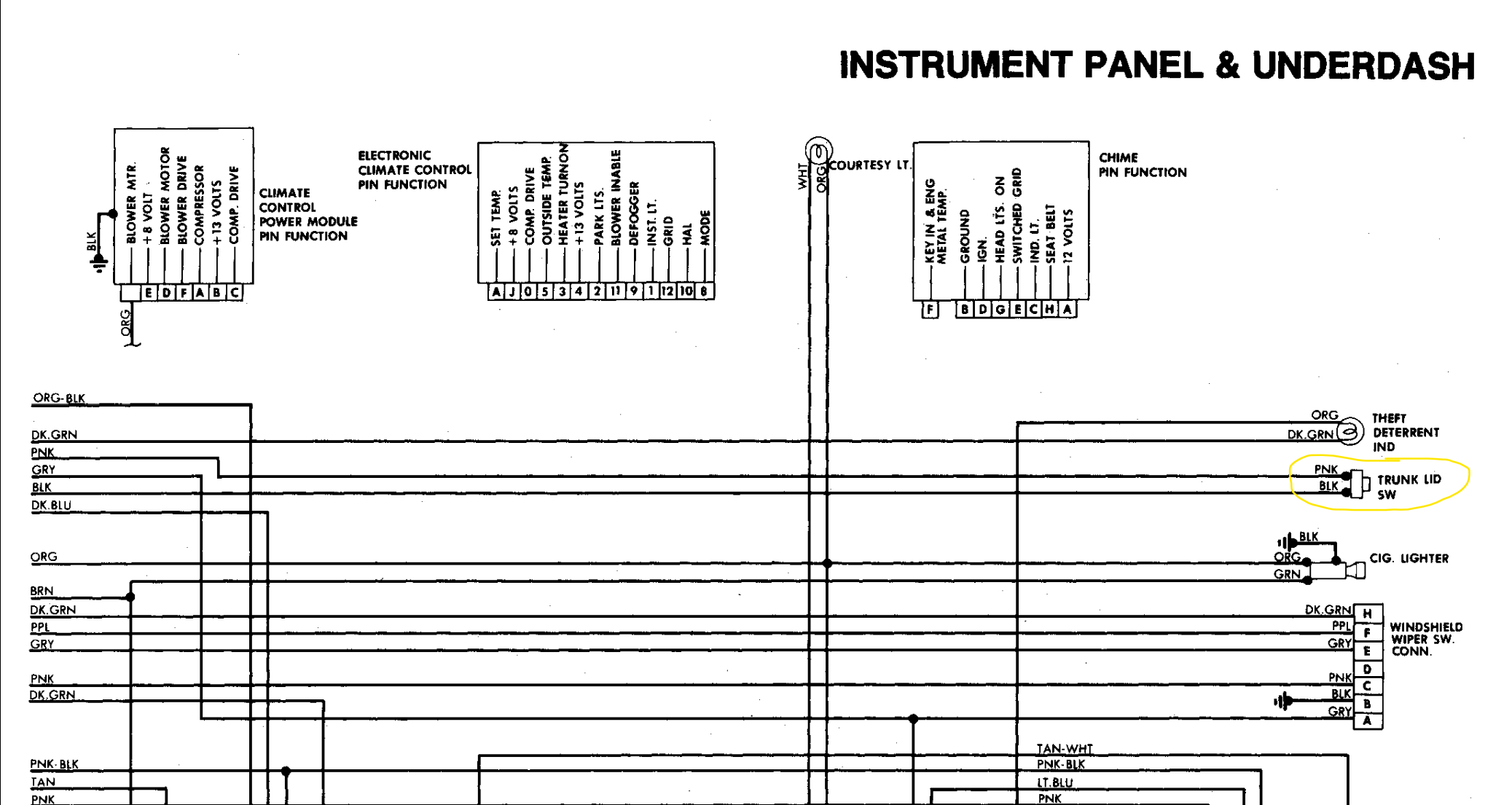

My info is telling me your vehicle has a trunk release switch in the glove box, is that correct? Has it ever worked?
If you have one there should be a pink and black wire attached to it. You maybe be able to run 12 volts to the black wire and maybe it will open. Not sure if you tried it or not, or if it has ever worked but I thought it was worth a shot.
Looks like for the switch the black wire runs directly to the trunk release solenoid and is grounded in the trunk somewhere. So, if the solenoid and ground are good running 12 volts to that wire should release the trunk lid.
I will add the wiring diagram for you.

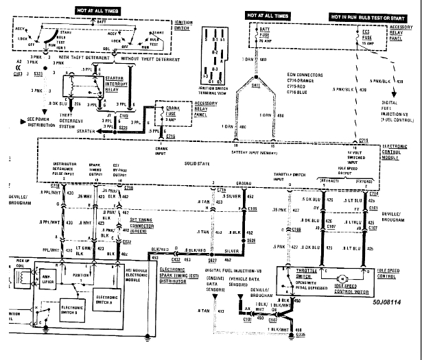

If you have a anti-theft system, it looks like it only has the starter cut of relay. I don't see anything that says it cuts off fuel or ignition.
Unfortunately, because of the age of the vehicle my information is very limited.
I have added a wiring diagram for the ignition circuit for you. I apologize it is old and hard to read.
My thought is if you can get the steering wheel unlocked you could jump the starter with a screwdriver to by-pass the starter cut-off relay.
In my opinion a mobile key service would be best since you are going to need the key anyway, but usually isn't cheap.
I know you just did a lot of work to it and got it running again so it would be a shame to have to tear it apart more and cause yourself more work now since the trunk situation.
But that is entirely up to you.
Since it is a bit of a different type of question than the original topic, I would suggest creating a new question so we can get the community involved and see if anyone has any better ideas.
