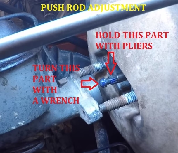

It does sound as though that maybe the adjustment rod/ screw found in between the vacuum booster and the master cylinder may be "adjusted out" a little too far.
Sometimes getting it just right may require a few times of trial and error.
You might even try to find a better procedure from a local source that may make this easier for you.
Although this is "not" your vehicle at all in my pic, it may explain what I'm suggesting. I say again, this pic is just a generic one.

Does it have a vacuum assist brake booster? If you disconnect the booster, does it happen? As far as the rod CJ is referring to, if adjustable, it would need turned in slightly. If you try that, make sure the brakes are working properly before driving it.

Please understand I don't have technical info on this vehicle, but it sounds like the push rod needs retracted a bit. When the assist is actuated (vacuum), it sounds like the travel for the push rod isn't there any longer.
