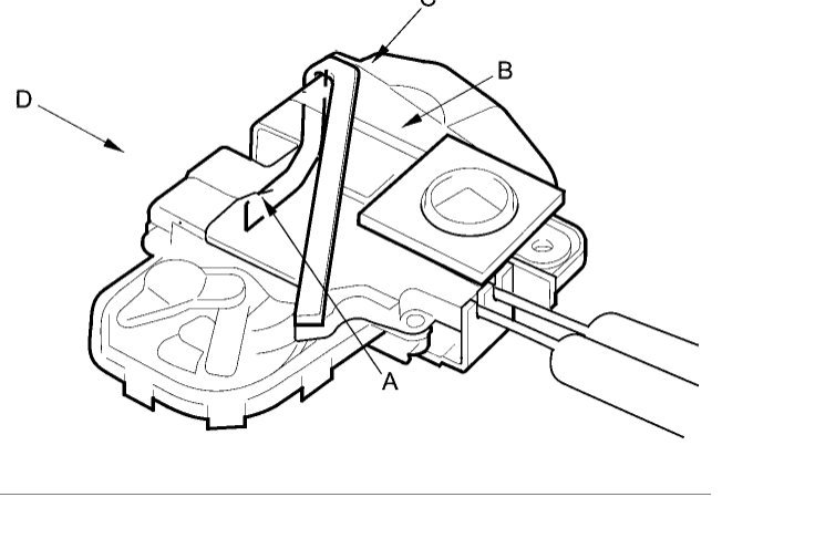

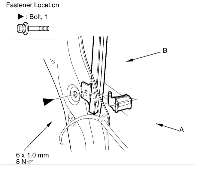

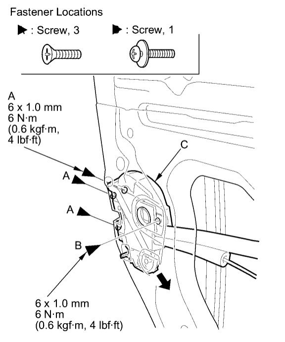

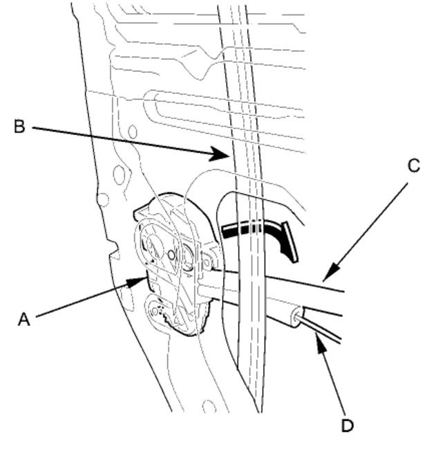

I found these diagrams for you to help you get the job done, you will also need to remove the door panel.
This guide will give you an idea on what you are in for when doing the job.
