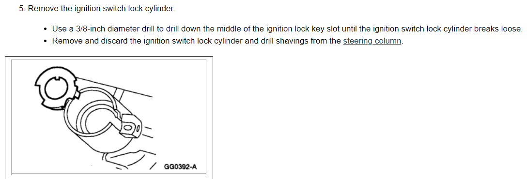

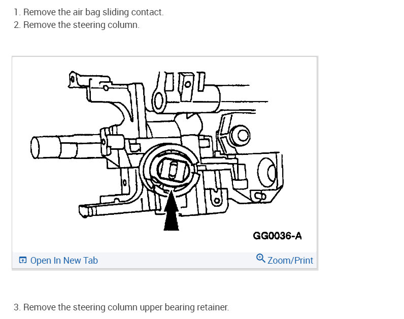

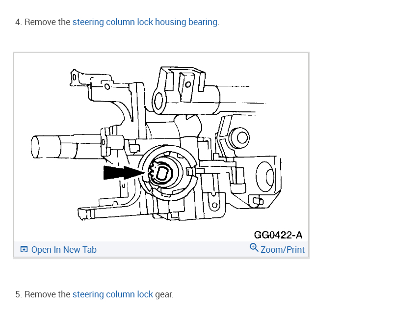

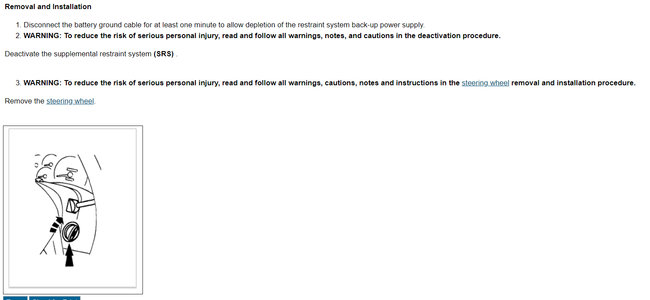

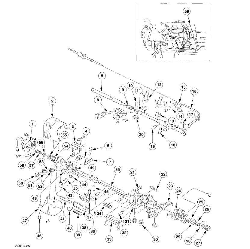

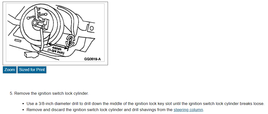

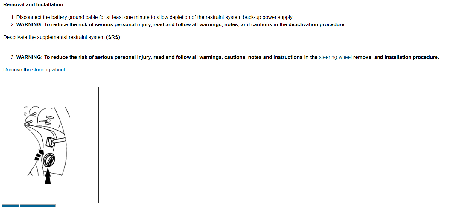

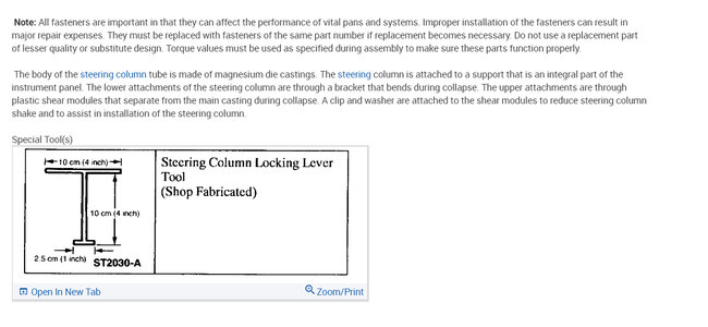

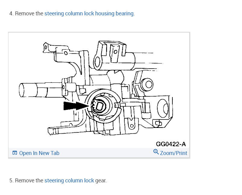

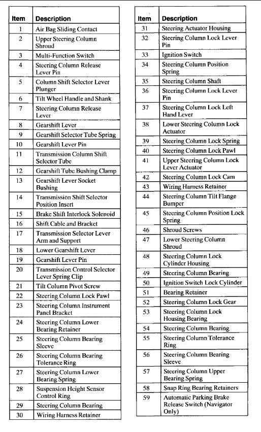

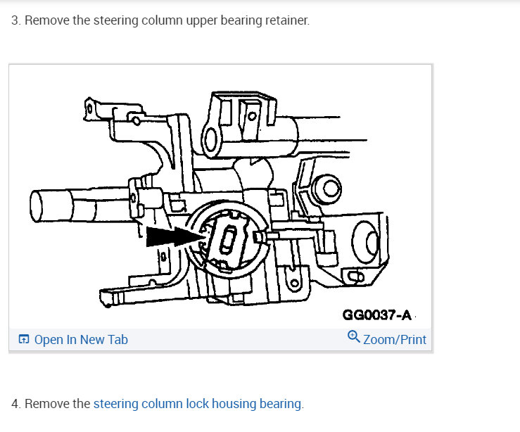

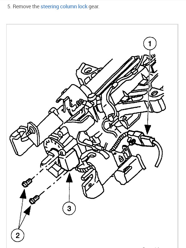

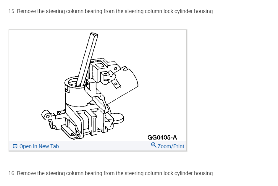

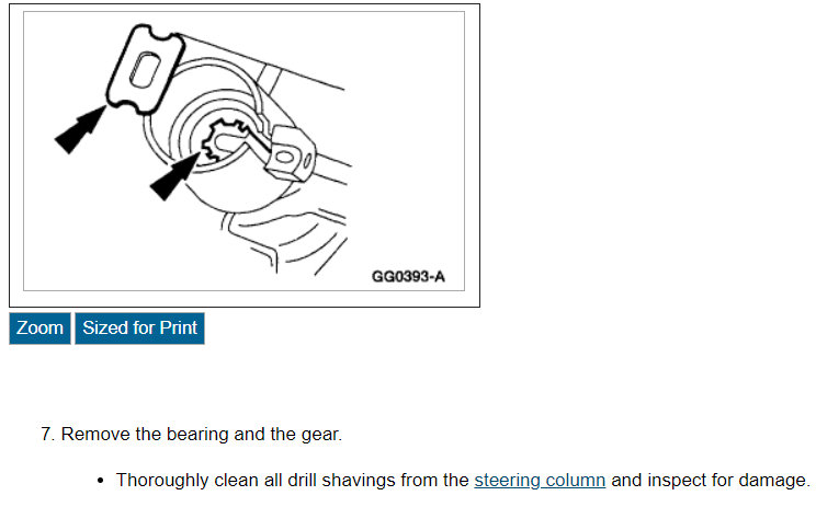

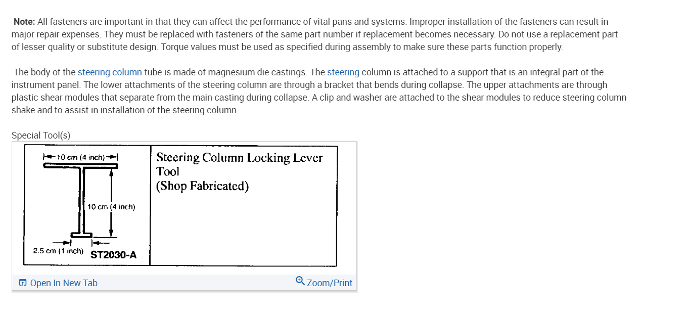

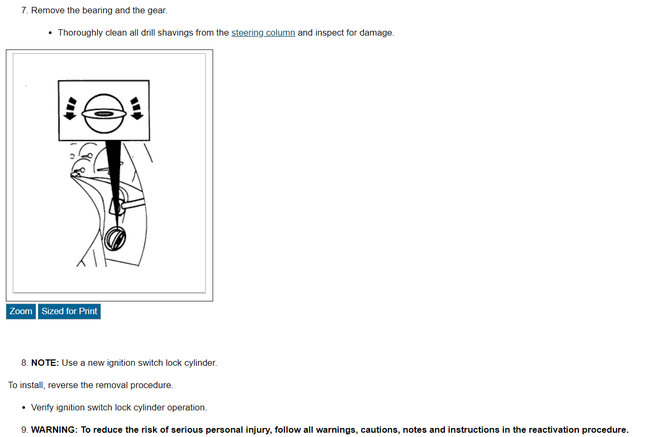

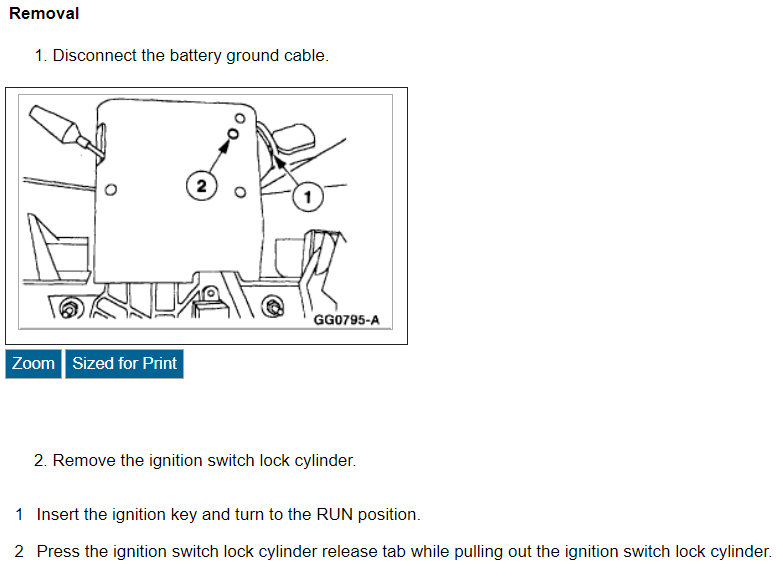

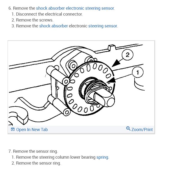

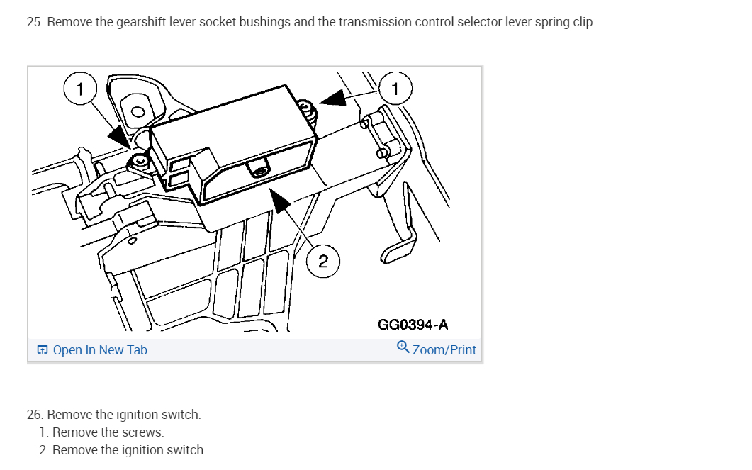

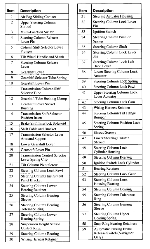

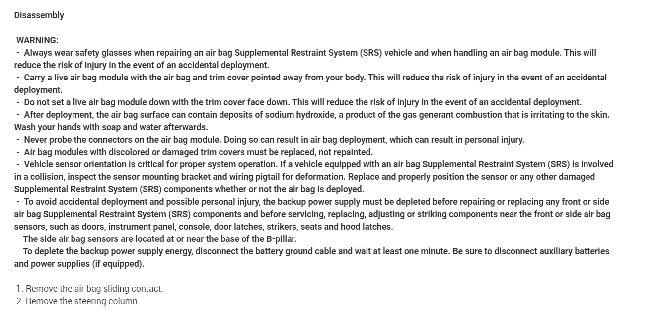

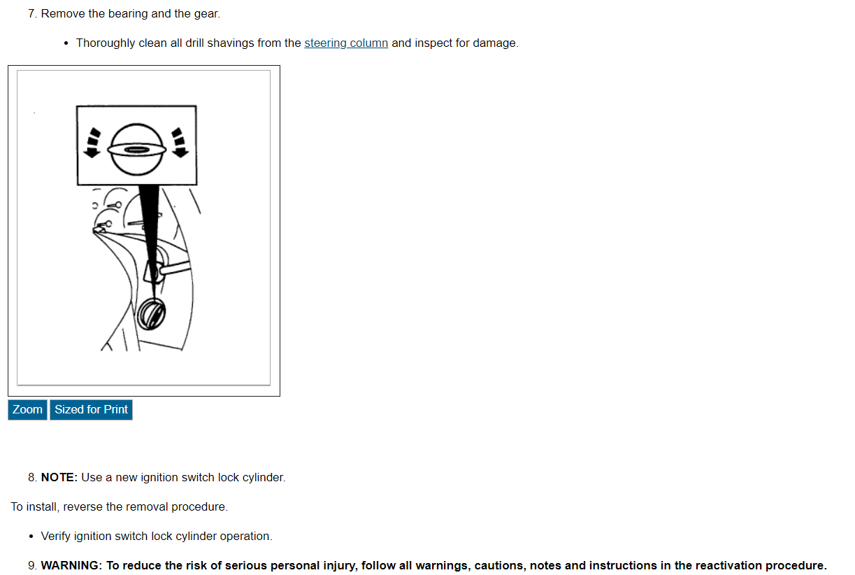

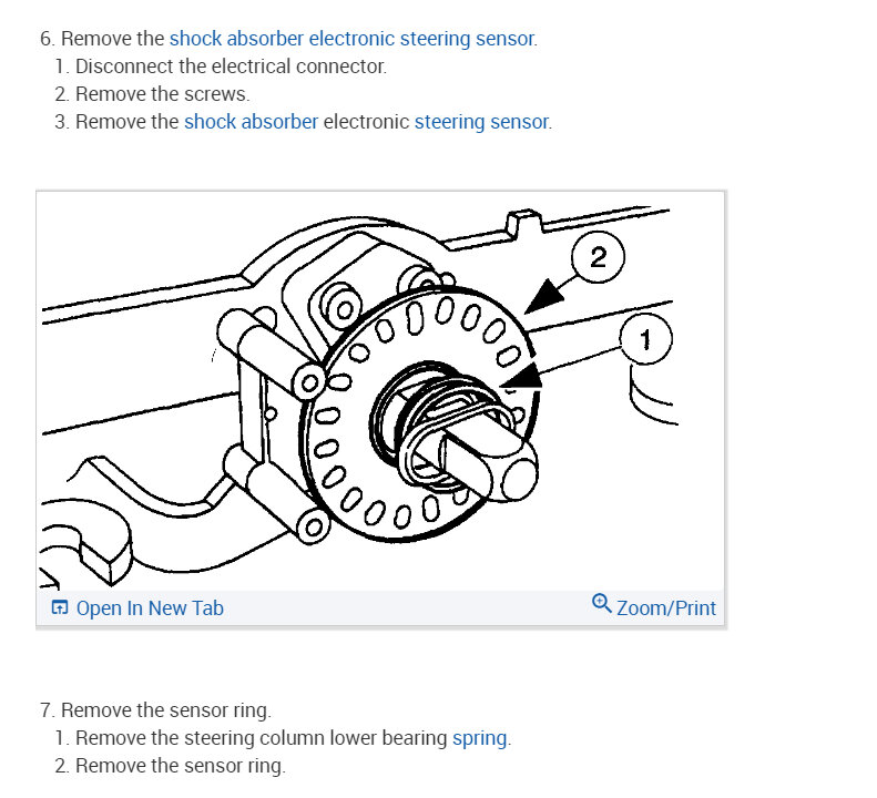

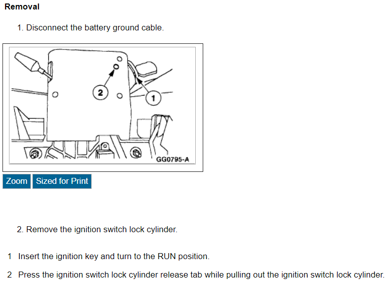

This happens when the internal gears get off time which will not allow the ignition lock to be installed. Make sure the pin is out of the way and the gears are lined up. Here are diagrams and instructions on how to replace the unit below. Check out the diagrams (below). Please let us know if you need anything else to get the problem fixed.
