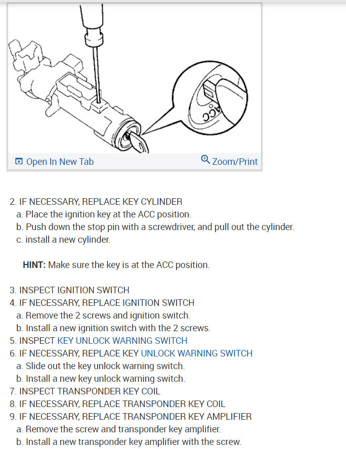

The key lock cylinder needed replacing. I bought one part # 69057-34040. When I put the cylinder in with the key, I can turn the key but cannot get the key out without removing the cylinder.
