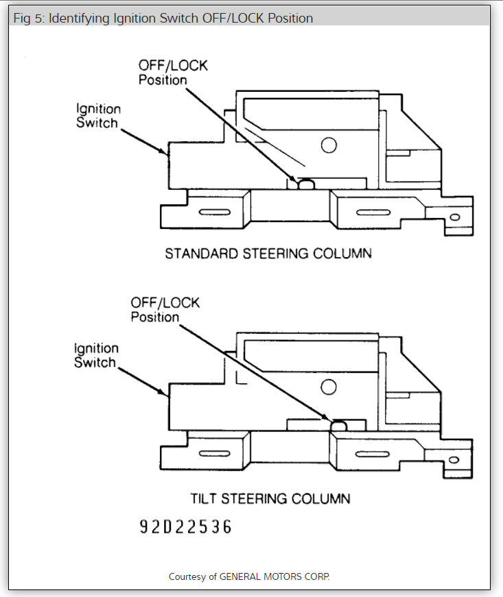

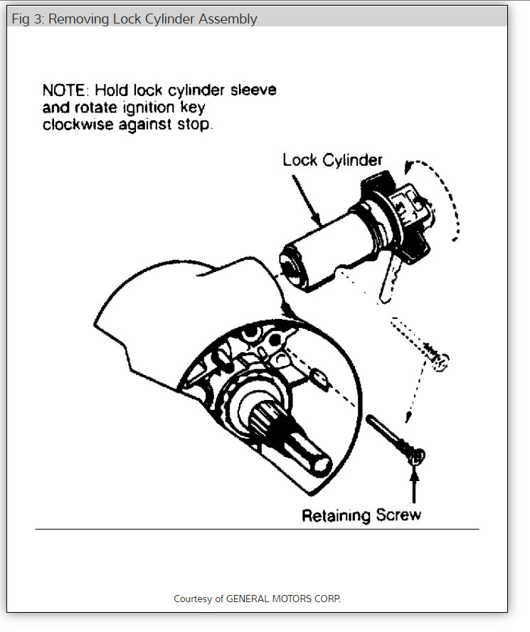

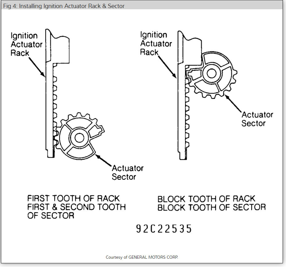

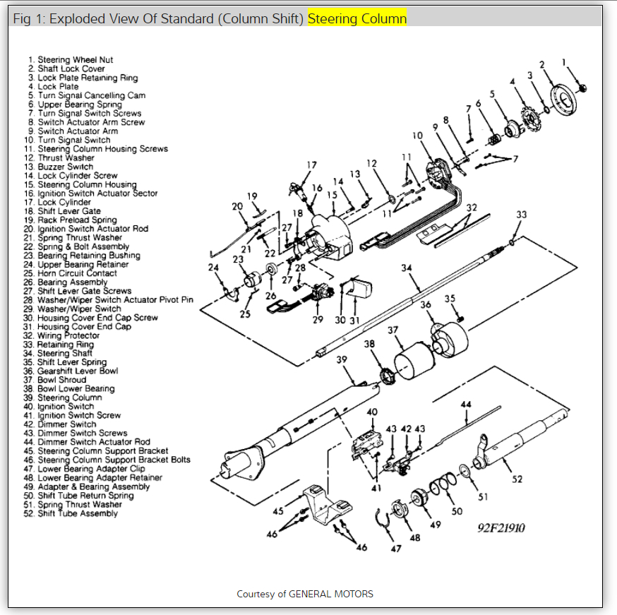

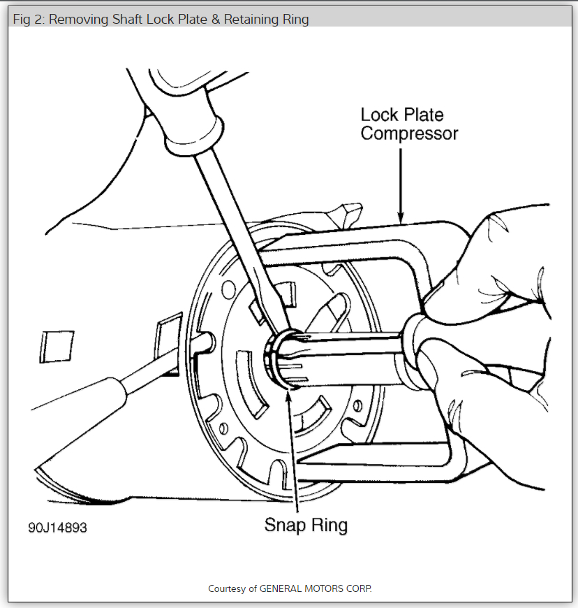

It sounds like the ignition switch down on the column has gone bad. Here is a diagram to help you see what you are in for when checking the switch. I would remove the switch and see if the lock turns.
May 24, 2018 at 12:47 PM
