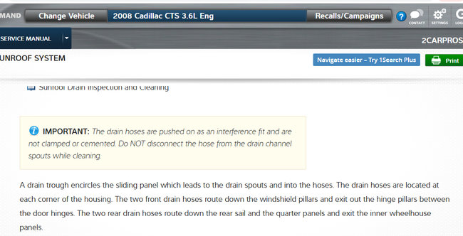

Can't locate this drain outlet to unclog it.
Apr 11, 2019 at 1:08 PM
SCGRANTURISMO
  • 4,897 POSTS

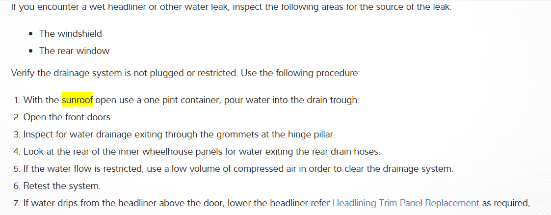

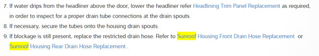

I have included the information that you requested down below in the diagrams. These instructions not only include the locations of all four sunroof drains, they also include step by step factory instructions for the proper cleaning of the drain system.
Please go through these instructions and get back to us with what you find out. And as always, if you have any other automotive questions, please, feel free to ask us. It's why we are here.
