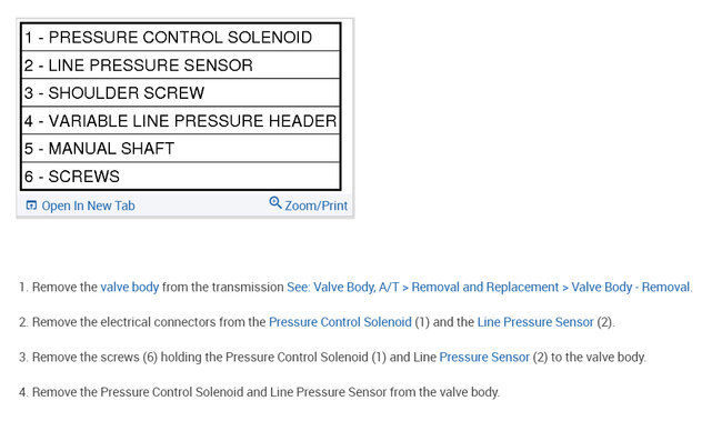

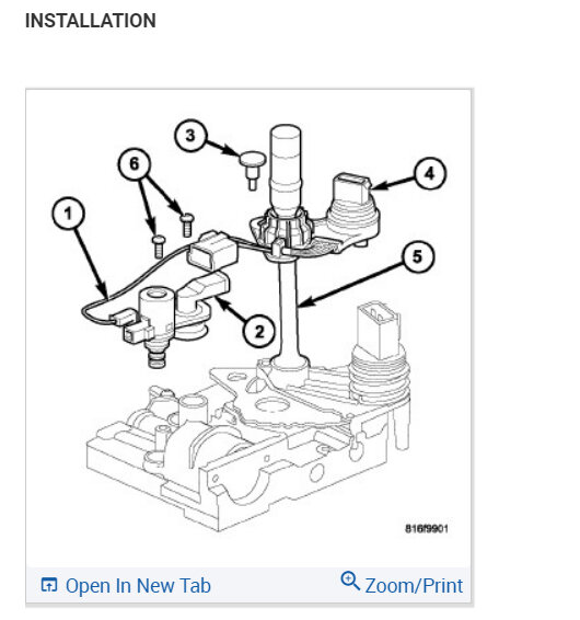

I think I need to change the transmission oil pressure sensor, but I can't find it on my vehicle. Please help.
Jul 15, 2023 at 7:39 AM

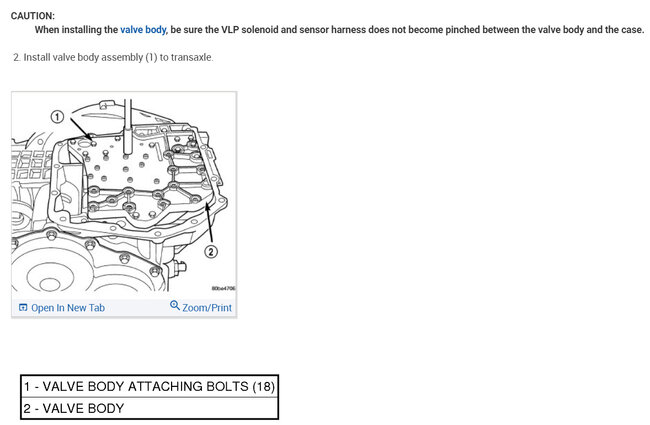

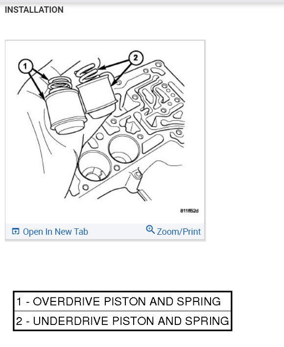

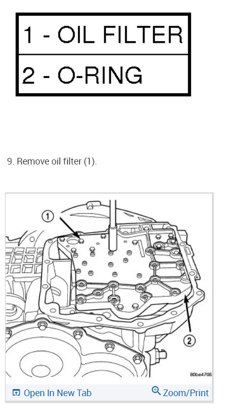

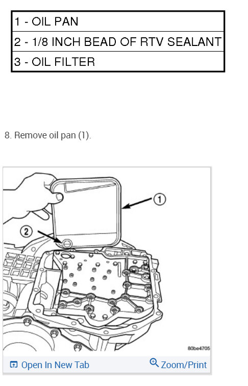

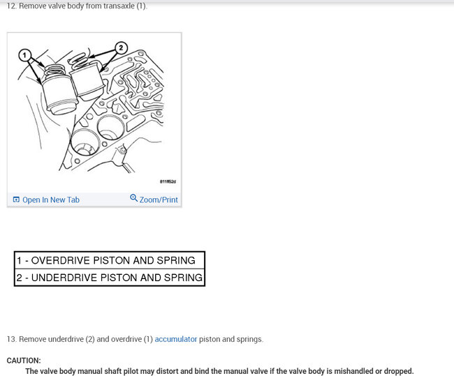

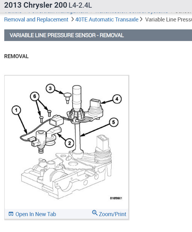

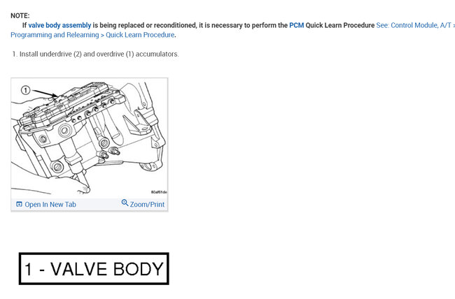

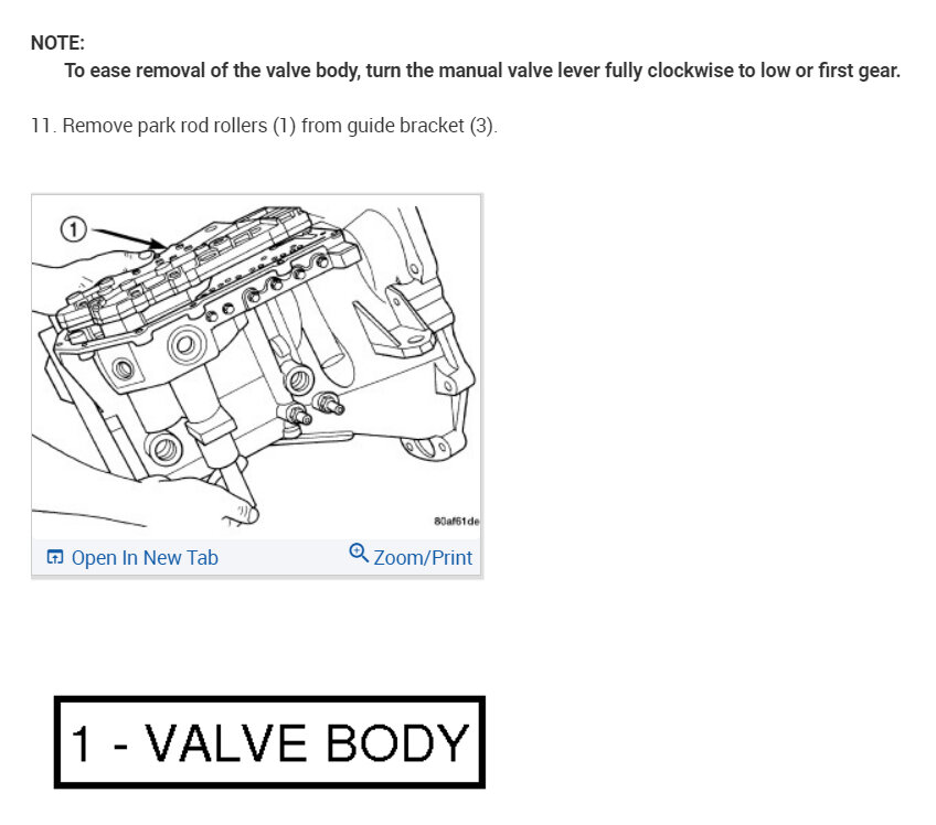

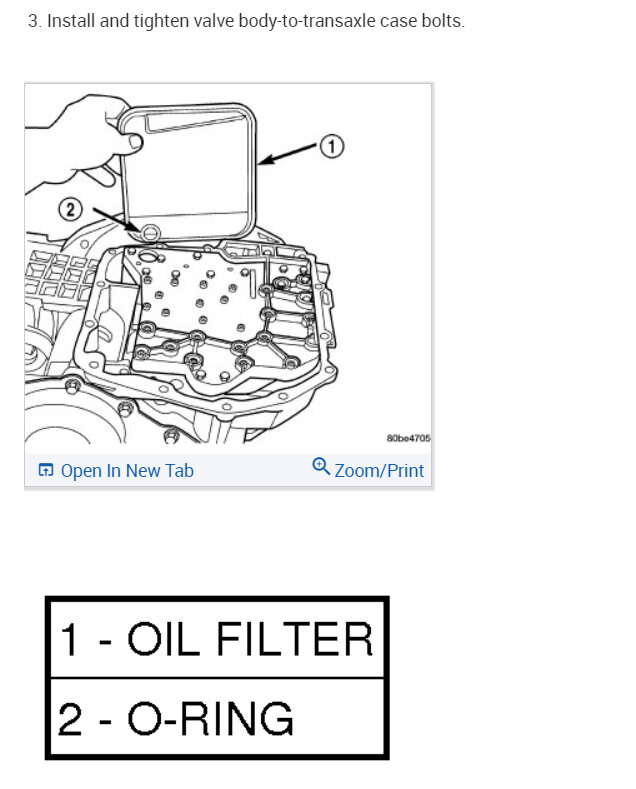

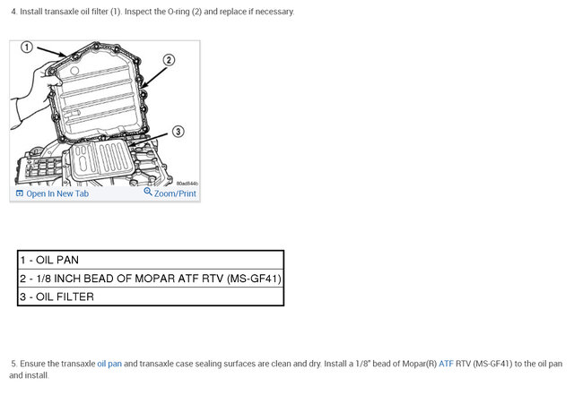

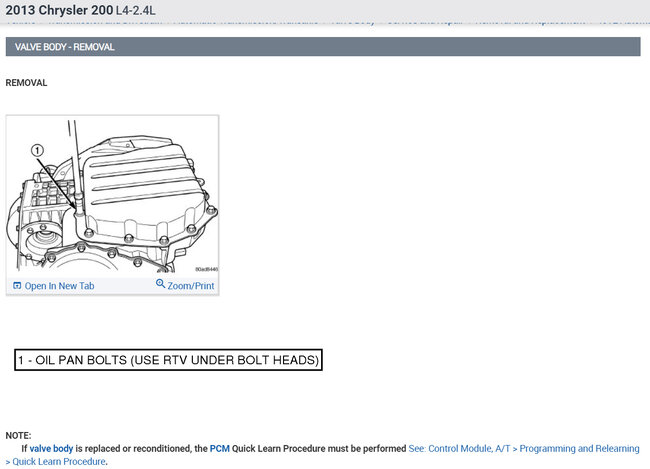

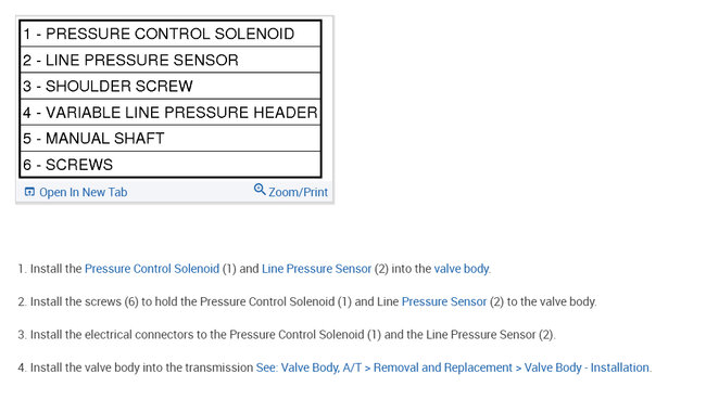

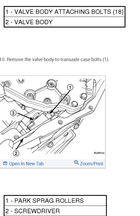

The oil line pressure sensor is in the valve body. Here is how to remove the valve body and replace the sensor.
Fill the transaxle with Mopar(R) ATF +4 Transmission fluid.
Check out the images (below). Please let us know if you need anything else to get the problem fixed.
Jul 15, 2023 at 5:53 PM

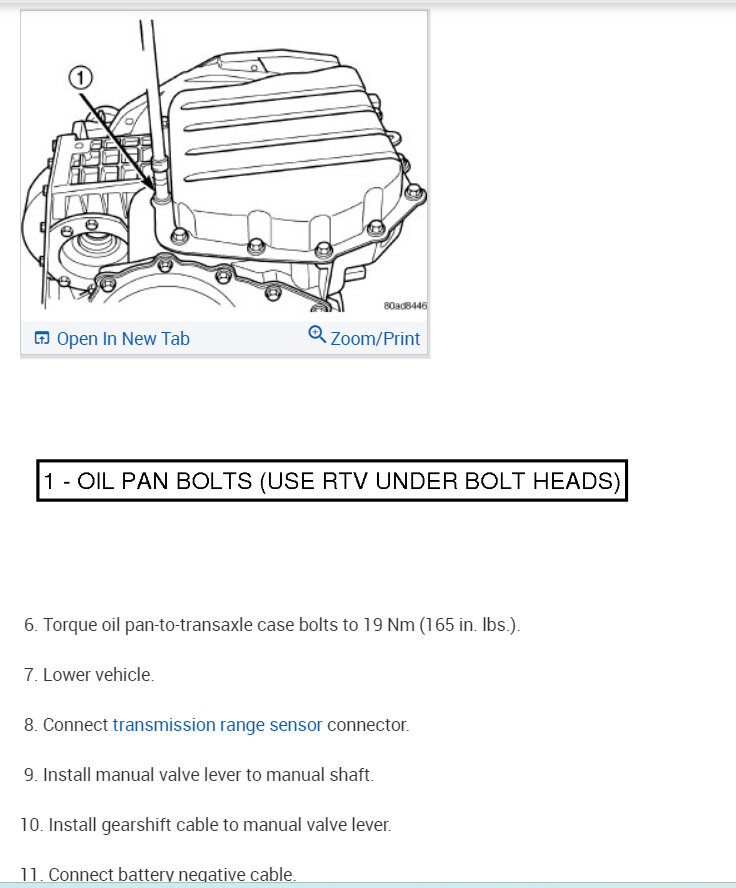

The piece that was suggested looks to be an external piece that goes on the side of the pump.
Jul 16, 2023 at 1:05 AM
goes on the side of the pump? I am not sure what you are saying here. The transmission pan must be removed to change the sensor out.
Jul 16, 2023 at 10:06 AM
Thank you, I see that now, your advice is most helpful.
