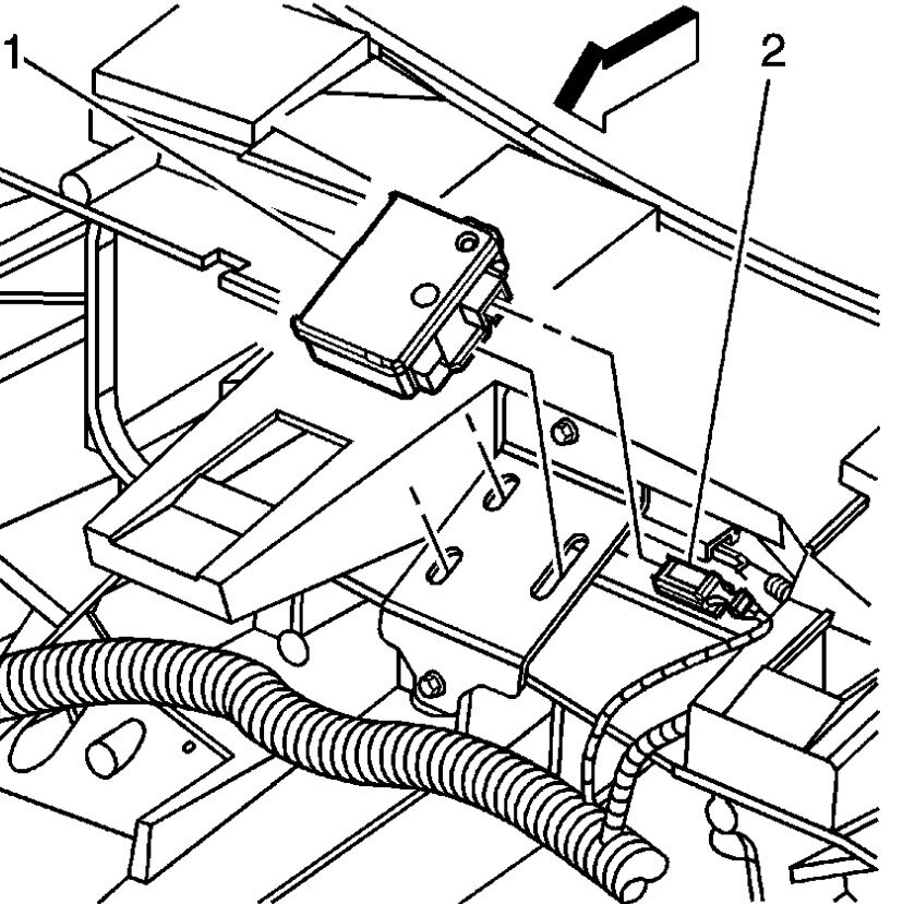

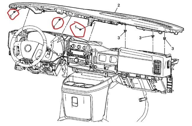

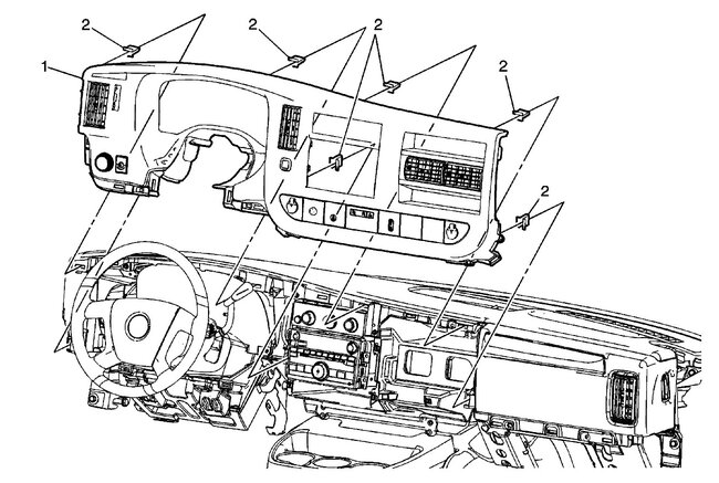

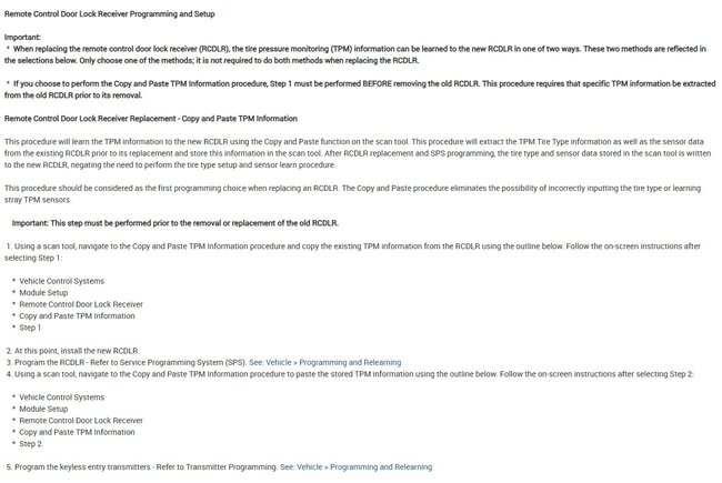

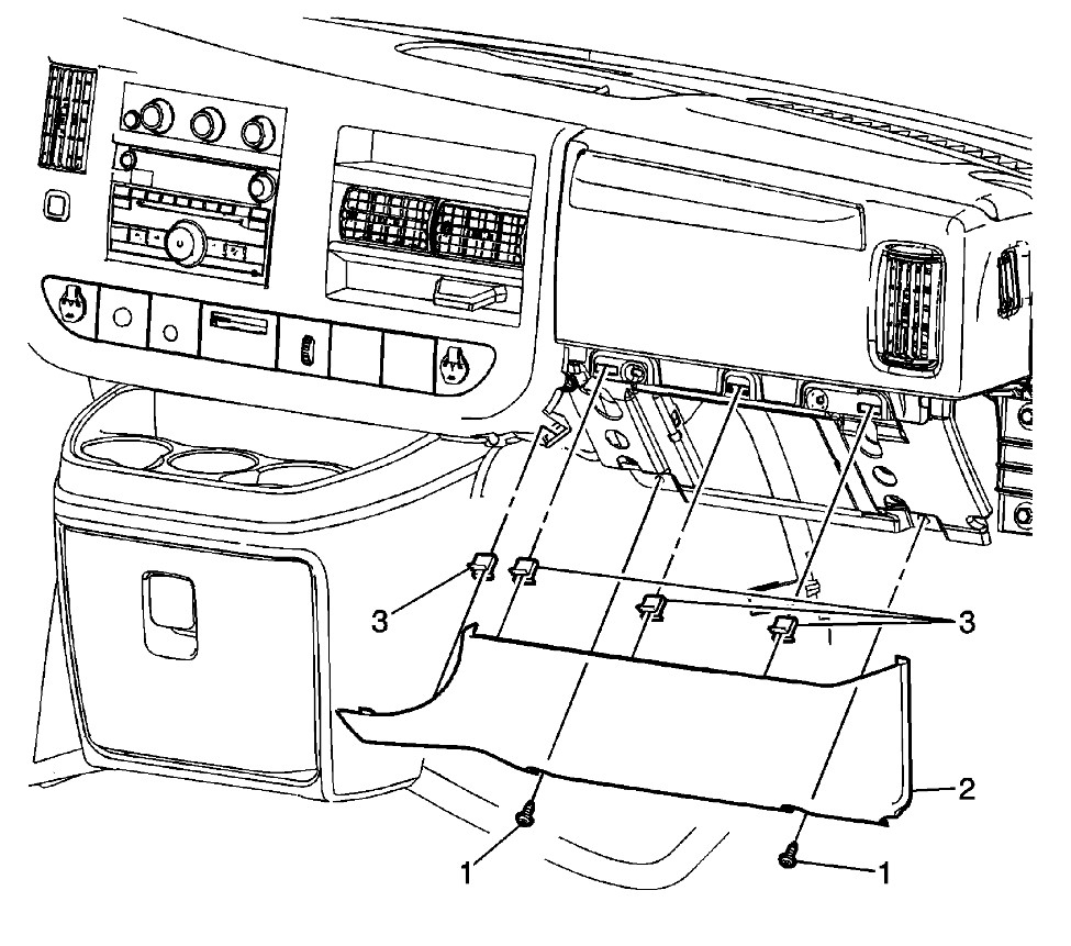

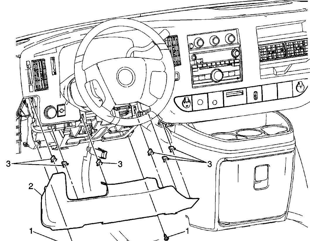

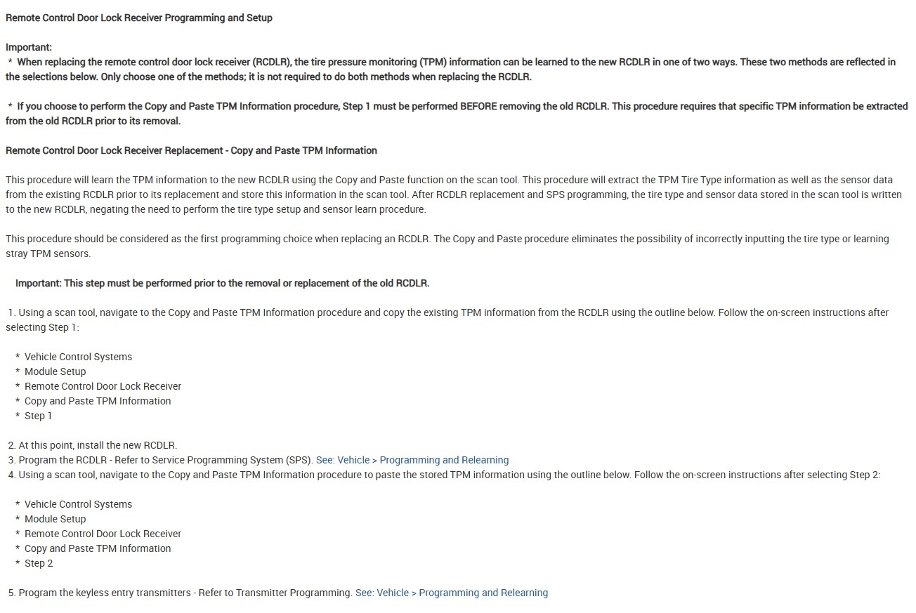

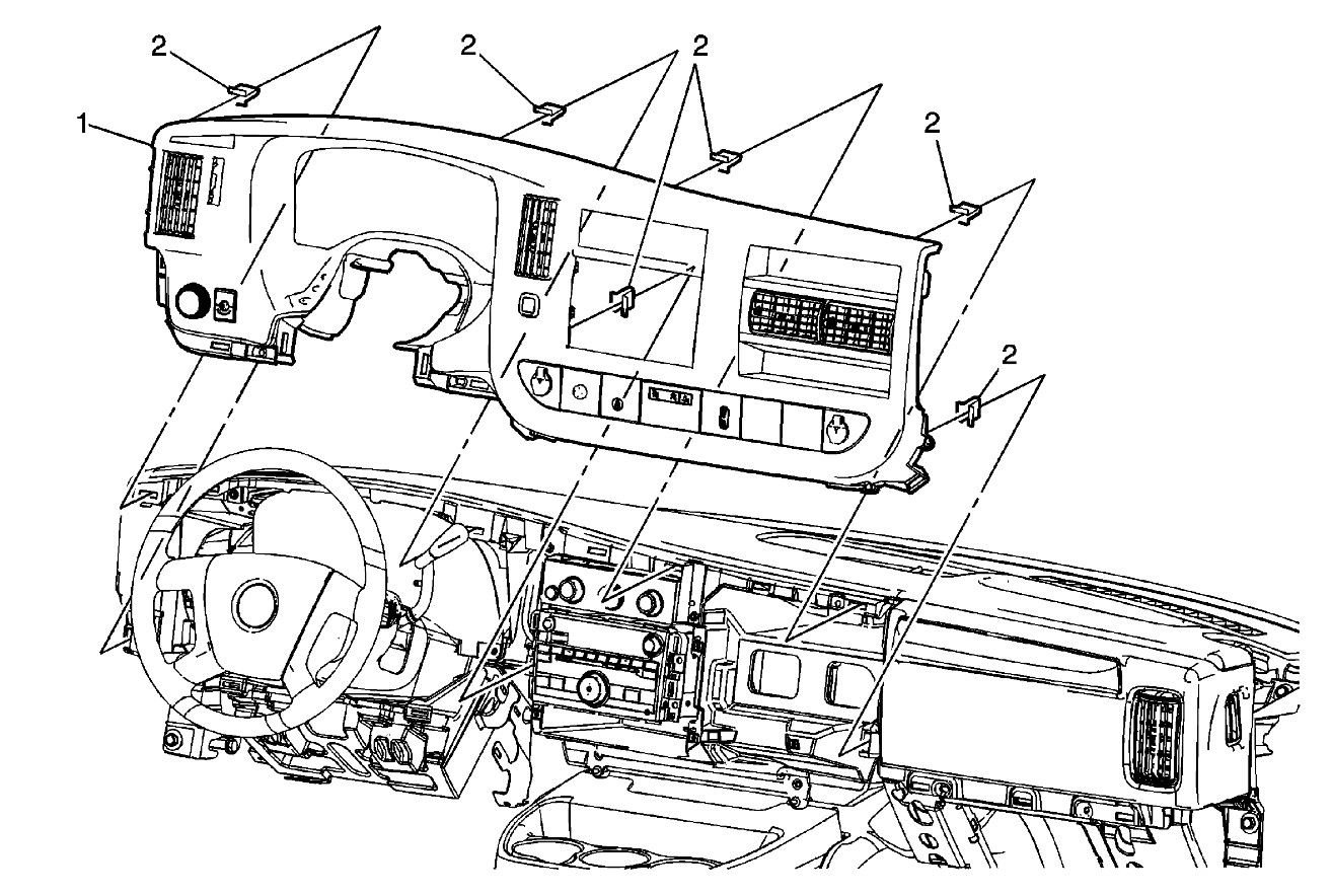

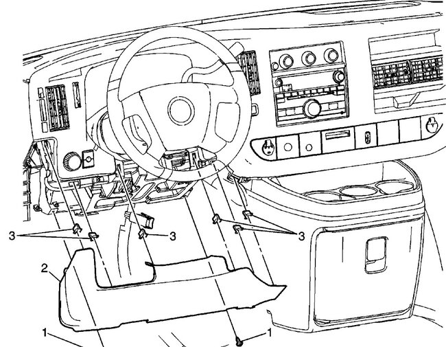

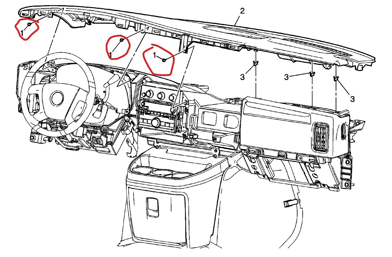

Have been having issues with back TPMS sensors losing connection for a few years. They usually would work fine for about 30 minutes of driving then one or both of the rear tire sensors would have a problem. Recently I had new tires put on and the transmitters all replaced. The tire shop could only get the rear tires to connect when the tires were near the front of the van. They said my TPMS receiver was most likely the cause. I would like to replace it but have no idea where it is located.
