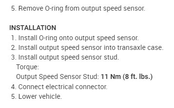

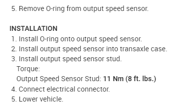

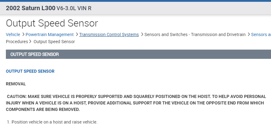

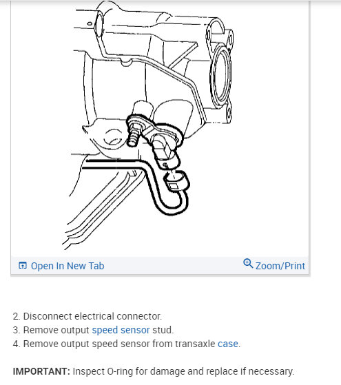

I suspect you are referring to the output speed sensor. That is what I attached the directions.
If you look below, I attached the directions for the replacement of the sensor. Take a look through them and let me know if you have other questions.
joe
See pics below.
