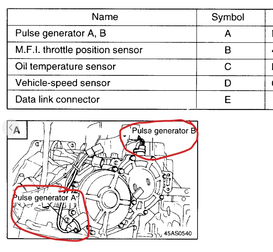

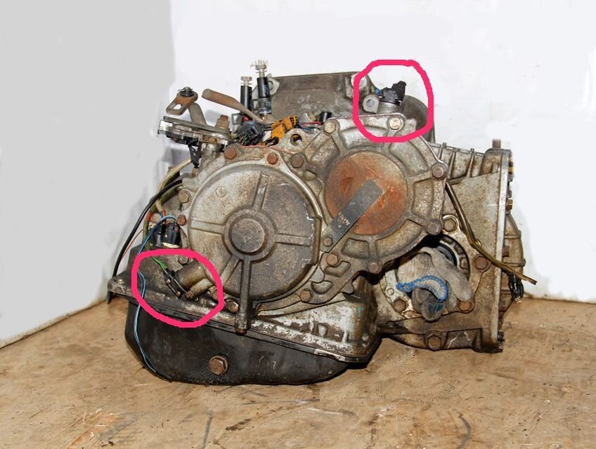

Both sensors are on the tail of the transmission case. Each has a single bolt that holds it in the case. Removal is simple, remove the bolt, wiggle the sensor until it comes free. Replace with the new one. Snug the bolts back down to 7 lbft. Plug the electrical connector in. Those are not a common failure item on that transmission, Might I ask the reason for replacement?
