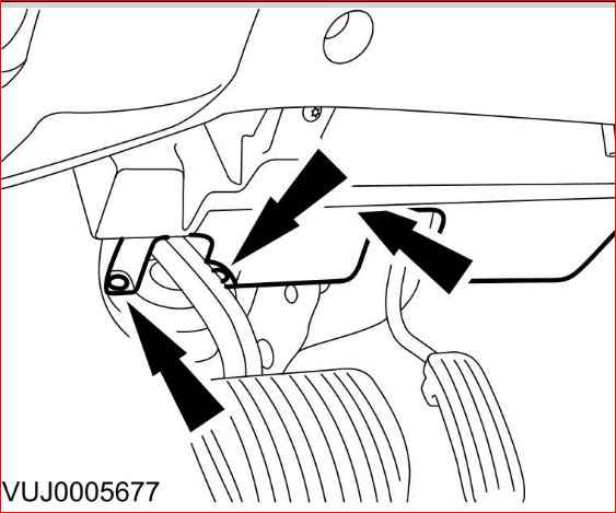

Good evening,okay thanks. Can you send the ECU sensor that allows the car to accelerate? Because the car is just throttling but it is not revving out.Thanks in advance.
Nov 29, 2018 at 4:26 PM
DANNY L
CERTIFIED EXPERT
5,648 POSTS
Hello again.
It sounds like you are having a problem with the APPS (Accelerator Pedal Position Sensor).The sensor is located above the gas pedal and its function is as a Potentiometer. It is a fly-by-wire system using an electrical connection instead of a throttle cable style linkage. Hope this helps and feel free to ask questions if needed. Thanks again for using 2CarPros.

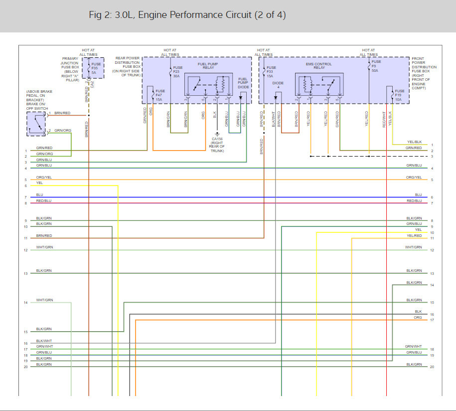

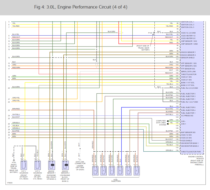

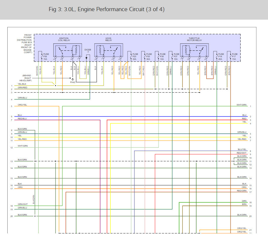

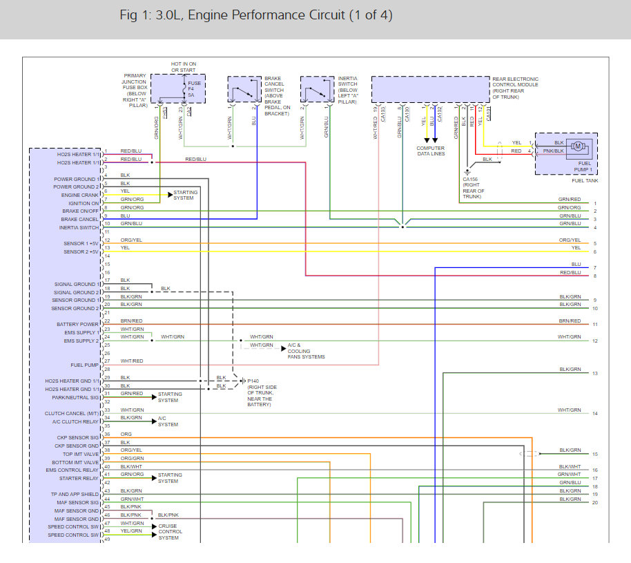

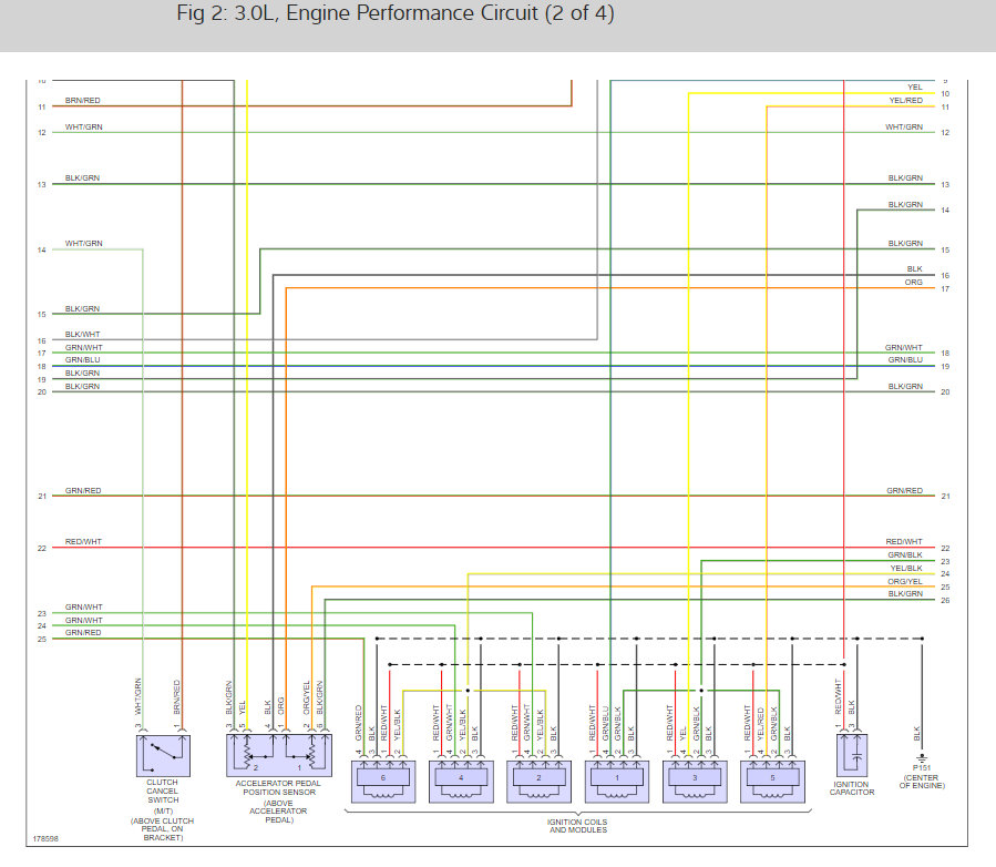

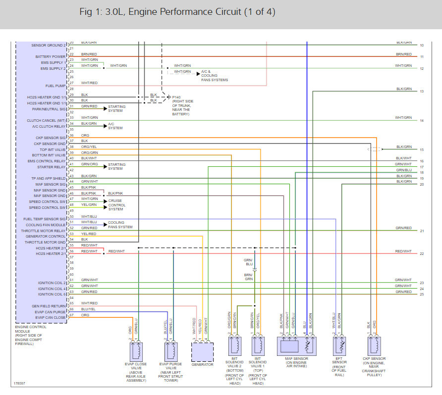

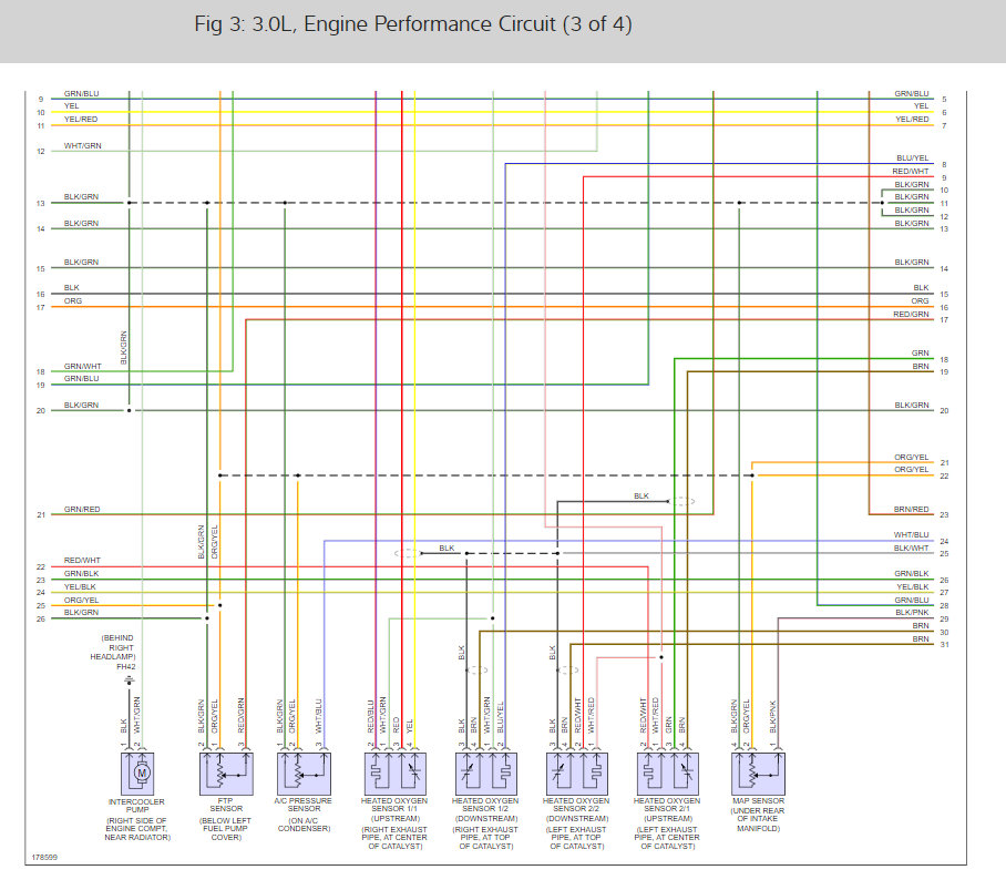

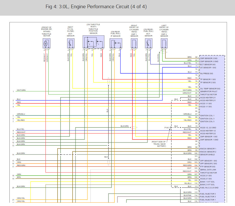

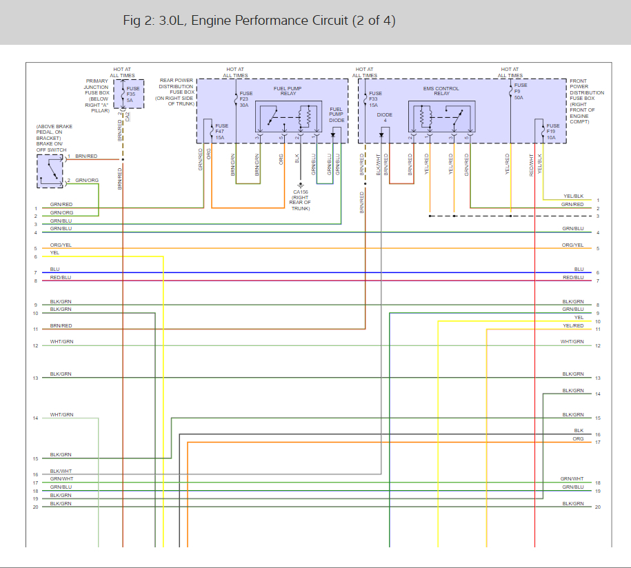

Hello, good morning. Can you please send me an image showing the ECU wiring diagram for my Jaguar 2003
S type car? Thanks in advance.
Dec 3, 2018 at 4:26 AM
CERTIFIED EXPERT
53,854 POSTS
Sure, here is the engine wiring diagrams showing the ECM and a guide to help you check the connections:
